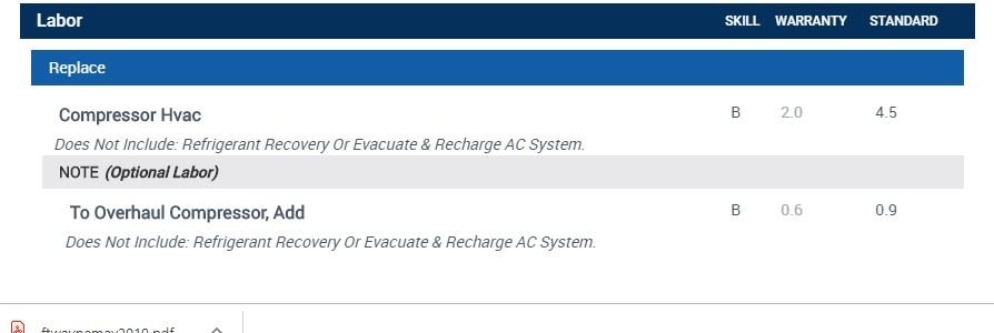

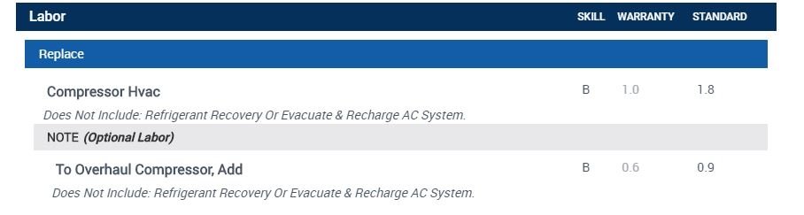

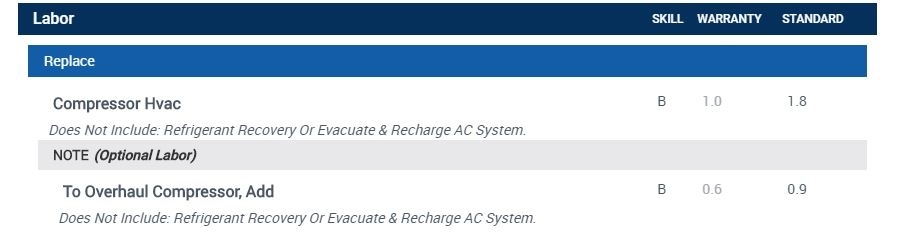

The worse case is the 3.0 DOHC motor which pays about five hours for the repair. That comes to around $650.00 in labor. Add evacuate and charge the system plus the belt, and the price goes up to around $800.00.
The price is a bit high.
I would try Pep Boys, Firestone and Goodyear to see if they would help you.
