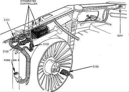

Where is the A/C clutch relay?
Aug 17, 2010 at 6:49 AM
WRENCHTECH
  • 20,761 POSTS
The compressor relay is incorporated into the CCRM (Constant Control Relay Module), also known as the Integrated Controller. It's located on the front radiator support, right above the fan.
