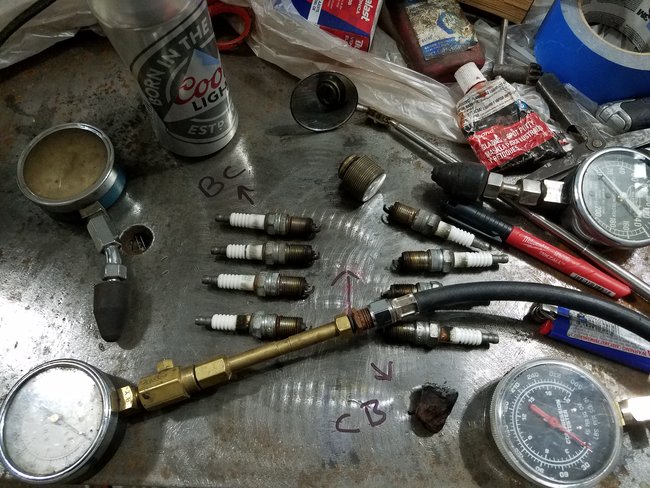

This problem is intermittent, starts runs fine other times when attempting to start it kicks back on the starter. Shows a heavy amp pull on the battery which is new. Checked out the starter, replace the crankshaft position sensor problem still exist. It will crank easy and then like a kicks back and has a hard time turn the engine over. No signs of oil or antifreeze mixture or bubbling in the radiator, no antifreeze smell in the exhaust when it is running, no check engine lights, battery cables tight, and secure. I am really stumped here is it hydraulicing should I run a compression check next?

Plug seem fairly even except for excessive gap and apparent misfire from carbon on couple no signs of hydraulicing from fuel oil or coolant.
I am guessing the timing chain must be flopping around cross my fingers that this is in fact a non interference engine. I used to be better at engine diagnostic before they hook up computers maybe I should plug electrode into my head. :)

Did you do the compression test?

Okay I will run the compression check once again, thank you.
Of course Ia m hoping that it is a loose flopping around timing chain and not a blown head gasket. :( Have my fingers crossed that this is in fact a non interference engine. :)

149 149 148 150 150 147 147 148
Timing chain?
PS. Thank you for getting me to run that test I feel a lot better about fixing this old Caddy.
Saturday, January 6th, 2018 AT 6:34 PM
  • 52,797 POSTS
Looks good. The next thing is to remove the distributor and check the lower gear. It is common for the gear to wear excessively. If it is worn the gears will be razor sharp. They should have a square cut to them.
