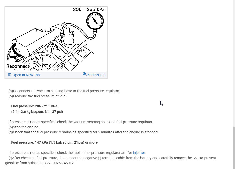

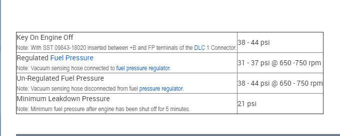

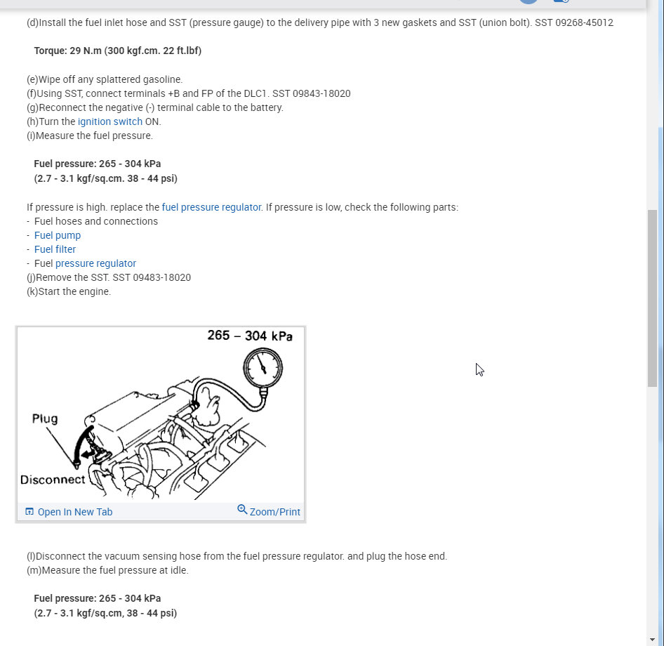

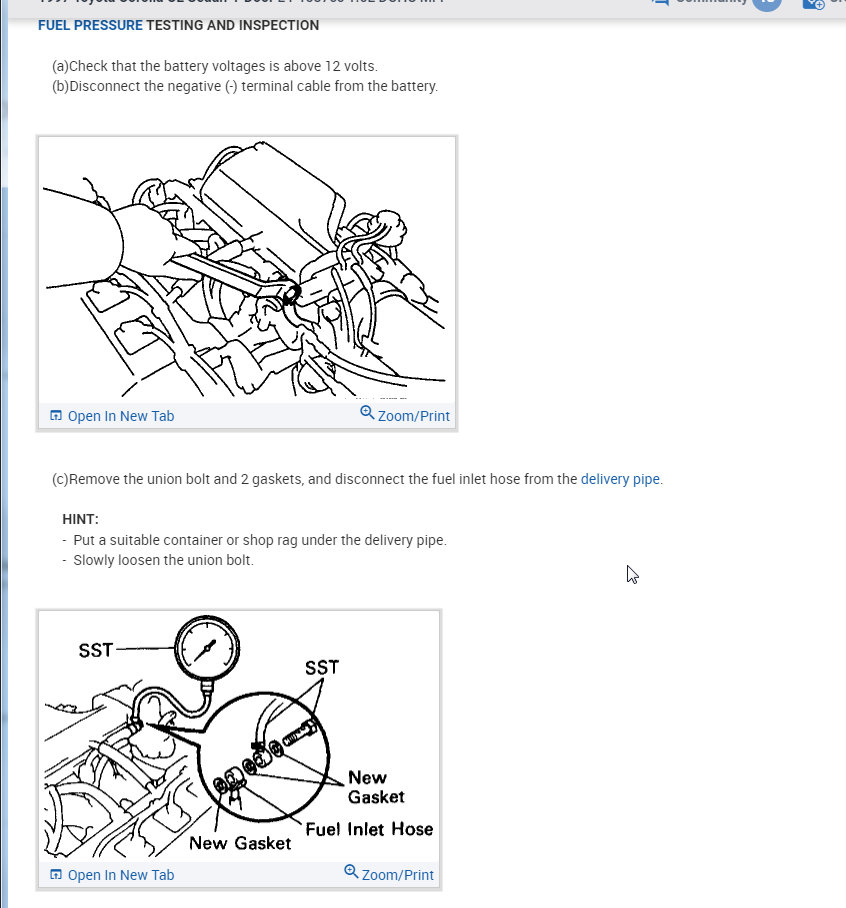

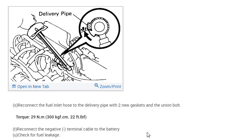

This sounds like a fuel pressure issue. So we need to eliminate that first. Here are the specs and process to test that. Let me know what you find and we can go from there.
