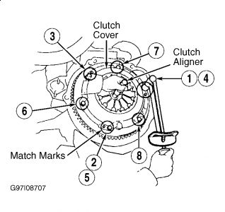

AZMA
  • 11 POSTS
THANK YOU ONCE AGAIN THIS WOULD BE OF GREAT HELP.
JUST ONE MORE QUIRY: WHEN THE AUTHORISED DELAER REMOVED THE CLUTCH HE DID NOT MAKE THE MARKINGS. ON THE FLY HOUSE.
IS THERE A WAY WE COULD GET THE EXACT MARKING BACK OR ARE THESE FACTORY SET?
THANKS AGAIN
Friday, March 5th, 2010 AT 1:26 AM
DOCFIXIT
  • 18,828 POSTS
Not sure what your asking could you explain Markings?

AZMA
  • 11 POSTS
THANKS
I UNDERSTAND THAT WHEN REMOVING THE CLUTCH SYSTEM FOR THE FIRST TIME THERE IS A FACTORY SETTING ON THE FLYWHEEL.
WHEN A NEW CLUTCH IS FITTED WE MUST ADJUST AS PER THE MARKINGS SOMETHING TO DO WITH THE ALIGNMENT I ASSUME!
I DID NOT NOTICE THIS MARKINGS OR ADJUSTING POINT IT THERE A WAY TO GET THE SETTING BACK.
IS THERE ANY OTHER SETTING THAT I COULD HAVE MISSED OUT?
AS FAR AS I KNOW THE CLUTCH FITTING IS NOT SO DIFFICULT ONE PART GOES ON TO THE OTHER.
I JUST CANT FIGURE OUT WHERE I HAVE GONE WRONG. THIS IS A HYDRUALIC CLUTCH NOT CABLE.

DOCFIXIT
  • 18,828 POSTS
Found this as to Mark
http://www.2carpros.com/forum/automotive_pictures/198357_Graphic_376.jpg
maybe mark is on OEM clutch cover but it can only go on one way. Like I told you before have flywheel resurfaced
