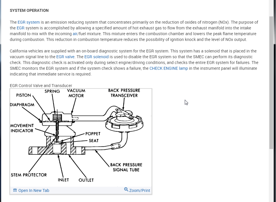

I've replaced about every sensor EGR valve the EVAP system valve distributor cap rotor button plug wires and it still runs rough. Now it will start and run like nothing's wrong until you put it in gear it has no power like it wants to go but something's holding it back. It's throwing no codes or my check engine light is not on. I've been trying to figure it out for about 3 months now.
Sunday, March 8th, 2020 AT 5:56 PM
Okay. You are on the right path with the EGR. Normally when putting a vehicle in gear and it runs rough it is related to the EGR. Since the valve is new we need to remove it again and look at the inlet and see if there is carbon or it is dirty. We need to make sure the passage is clear.
Then we need to monitor the o2 sensor data and see if it is lean (as I suspect) when you put it in gear. If you don't have a scan tool, try spraying a little starter fluid in the intake when it is running rough. You will need someone to sit in it while you do this so they can hold their foot on the brake or lift the drive wheels so it is safe.
Once we know if it is rich or lean when running rough we can make the next decisions.

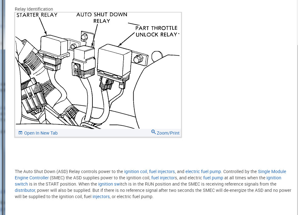

Oh, okay. So I track down wires from the computer to all the sensors did continuity test on all of them I was getting readings. Then I came to the automatic shut-off relay and that might be my problem. Is there a way I can bypass the relay with jumping a wire? And do you know what the sensor is down back behind the throttle body like on the bell housing? It's just a two prong plug.
Thursday, March 12th, 2020 AT 7:11 PM
That would be a new one on me if the ASD is the issue. Normally if the ASD is working then it is working. If not, then you have a no start. I haven't seen an ASD cause a rough running condition so keep me updated on that one.
As for the connector, this is most likely an intermediate connector but I am not sure which one it is off the top of my head. Can you get a picture of it and I will try to find it on a wiring diagram.
