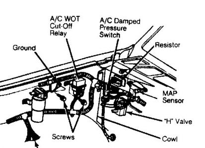

REAMSTER88
How do I check the map sensor and where is it located
+3
Friday, February 29th, 2008 AT 5:49 PM
BMRFIXIT
  • 19,053 POSTS
Check the fire wall it has vacuum line connected to it
and a plug
https://www.2carpros.com/forum/automotive_pictures/99387_88dodge_1.jpg
