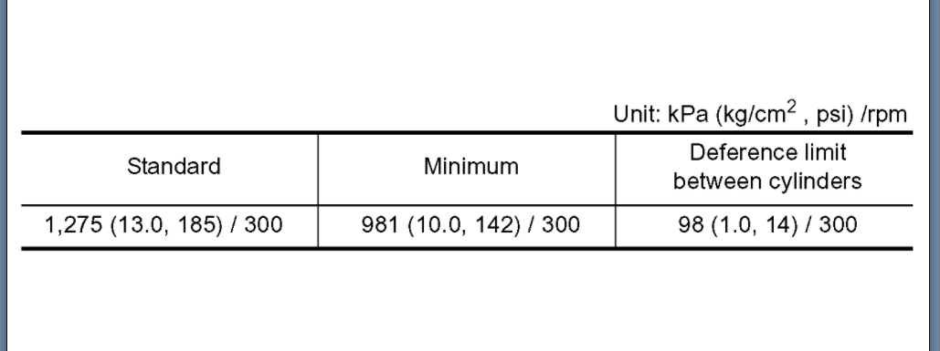

If the engine actually overheated, then we need to start with checking the head gasket and the compression.
I suspect we have an issue with the head warping or the coolant and oil mixing. So here are a couple of guides that will get us started:
https://www.2carpros.com/articles/coolantantifreeze-in-the-engine-oil
Once we know what the compression is we will be able to figure out the next steps. So, let's start with this and we can go from there.

Okay. Can you get a recording of the noise when you start the engine?
Can you get it started now to duplicate the noise?
I am concerned that the noise that sounds metal to metal is an engine knock. If it is, then that is a serious issue and the place to start is draining the oil and check for metal. So, we need to catch the oil in a clean drain pan so that we can find out if there is metal.
https://www.2carpros.com/articles/how-to-change-engine-oil-and-filter
Then remove the filter and cut it open and find out if there is metal flake in filter and this will confirm that we are going to have to rebuild or replace the engine.
If we can't confirm this is not the issue first, then we are just wasting time on the other issues because none of them will matter if the engine is failed.
