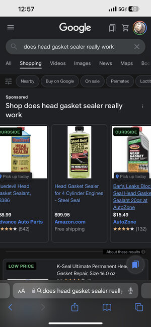

They diagnosed it as a blown gasket. And they want $4,200 to fix, absolutely not going to put that kind of money into it. However, I wanted to ask? Does the gasket sealants you can add to your coolant work? At least temporarily? I really need to be able to commute to work. Again, it is no longer overheating, once the car is stopped and the cap released just a little, the coolant replenishes.
May 11, 2023 at 2:56 AM
TJJETER87
  • 25 POSTS
This?
May 11, 2023 at 2:57 AM

TJJETER87
  • 25 POSTS
Thank you for sharing! I am going to purchase it. Is this the recommended brand?? And, about how long does it last? Does it matter how bad the damage is or isn’t it for it to work effectively? My commute to and from work is almost 100 miles, I just want to be confident driving that far to and from even if it is temporary (a few months.) I’m sorry for bombarding you with so many questions, I just want to make sure I’m doing everything according to all the suggestions you have made. Lastly, there’s one called “bars leaks” that is supposed to be a permanent fix? Any feedback on that one? Or should I use only blue devil? I’m not sure how long the gasket has been bad, prior to work to work I’ve already needed to do, or how bad of a state it’s in after it was just diagnosed? Does the condition of the gasket matter? Will it seal anyway? I’ve trusted 2carpros for years now and I’ve never been steered wrong!
May 13, 2023 at 7:19 AM
  • 55,423 POSTS
I would use the blue devil, which is what should give you the best chance, and then drive it locally to see if that helped. The condition of the gasket will determine if it will work which we cannot tell unless you remove the gasket. Let me know how it goes.
