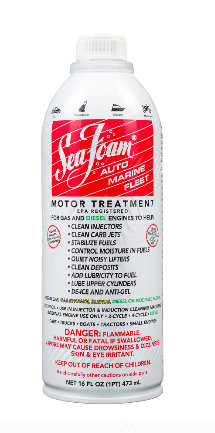

If the car has been sitting a long time it might have bad gas from sitting. I would suggest adding an additive called SeaFoam. You add to the old fuel and after a few minutes it will help start the car after sitting. I've attached a picture below of what the brand looks like. Do you know if the fuel pump is working? When you first turn the key on you should hear it operate for a few seconds to prime the system. Hope this helps and keep us updated. Thanks again for using 2CarPros.
