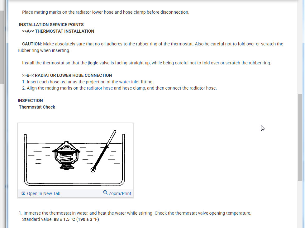

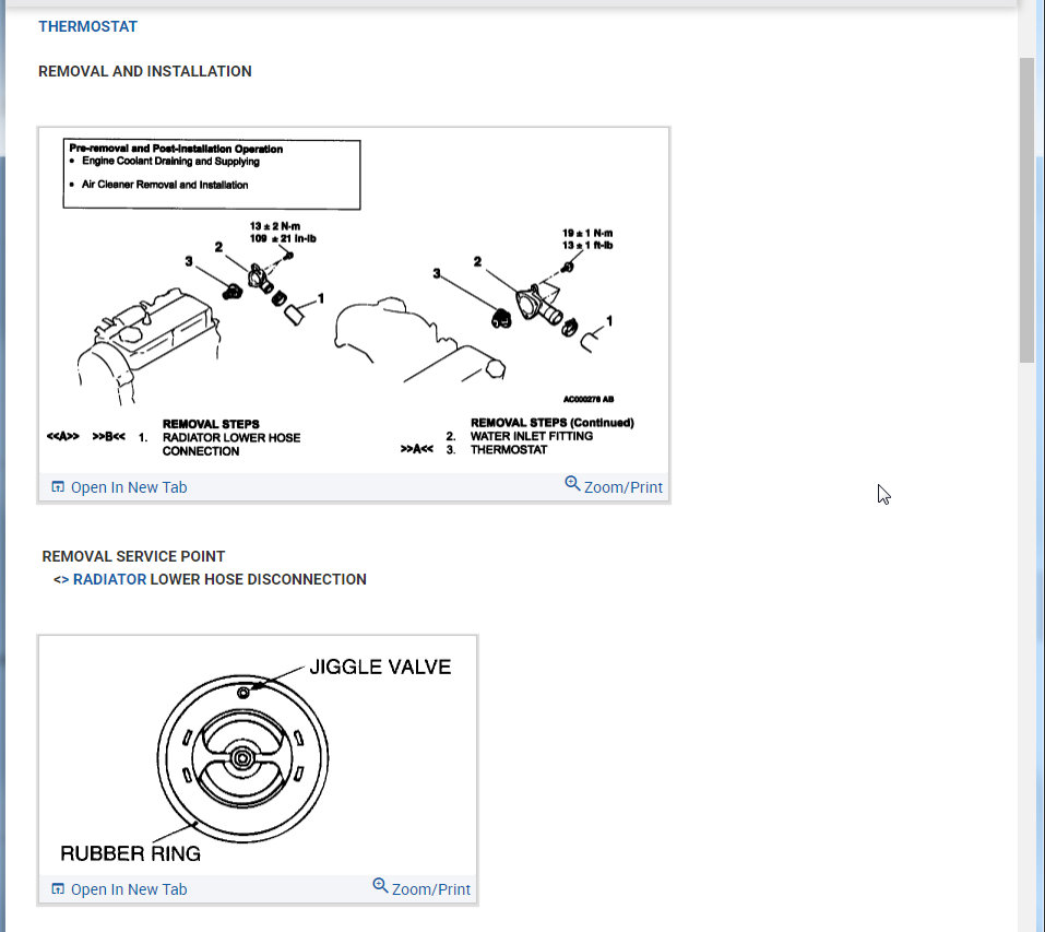

I just replaced my thermostat and my car runs fine the temperature gauge is just a little higher than usual almost to the middle. it rises to the middle when I am stopped idling for over ten minutes then it will go down once I drive. It did not use to do this.

More then likely you got a thermostat that has a higher temp opening point or you have an air pocket in the cooling system.
Let's double check the part number that you have and make sure it is correct.

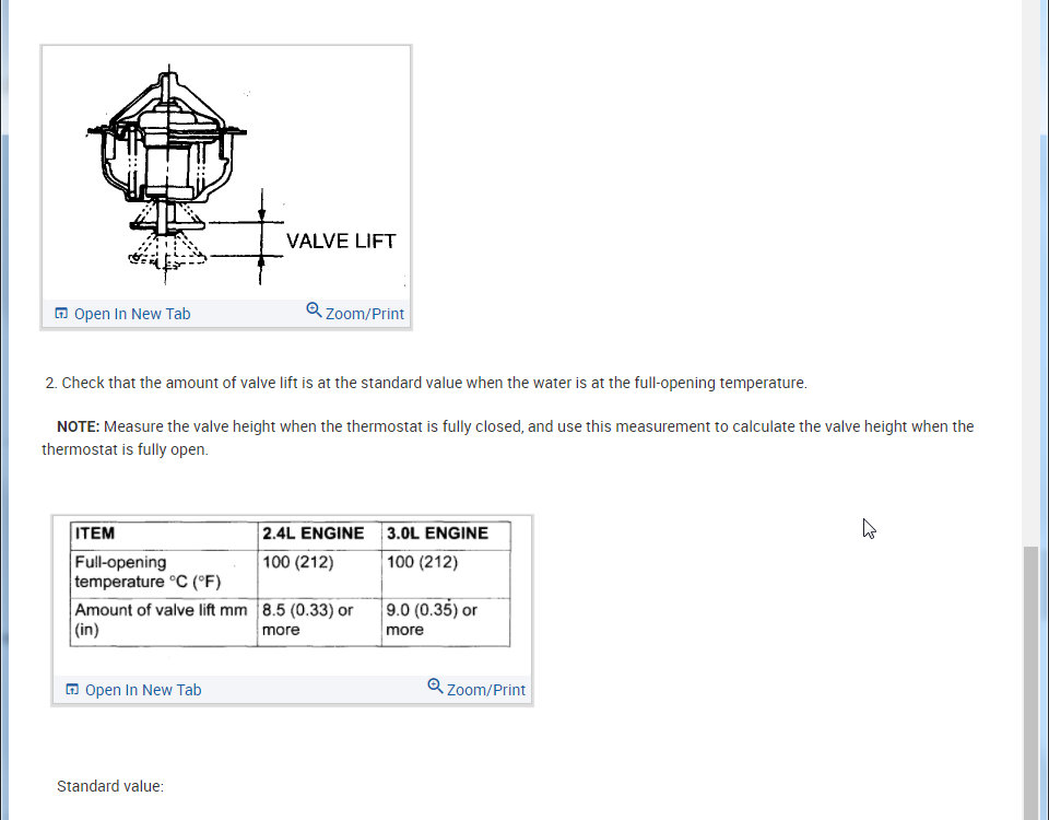

If all you did was replace the thermostat and this is happening, the only other possible cause is a faulty new thermostat.
Please see below for the process out of the manual as well.
So let's run through this material and go from there. Let us know what you find. Thanks
