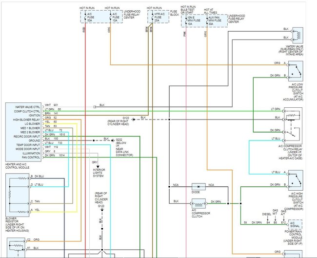

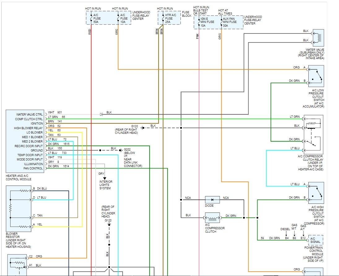

Heater blower quit working after stopping to fuel up. Blower was working fine before shutting the engine down. When restarted the engine the blower would not come on and radio display would not light and no signal (although volume control raised and lowered the static).
When I shut the engine off and restarted the radio worked again.
I checked the fuses and AC relay under the hood which are all good.
When I turn the fan switch on I hear a click behind the AC/heat control panel but no blower.
Saturday, December 26th, 2020 AT 10:12 AM (Merged)
RACEFAN966
  • 5,029 POSTS
Sounds like the controller may be bad

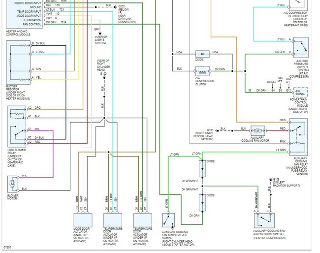

read the guide on testing wiring first, it will help
The wiring diagrams for you blower are attached below

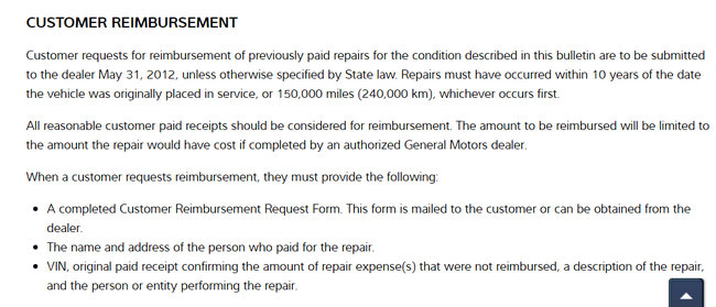

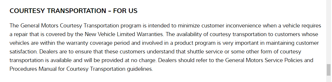

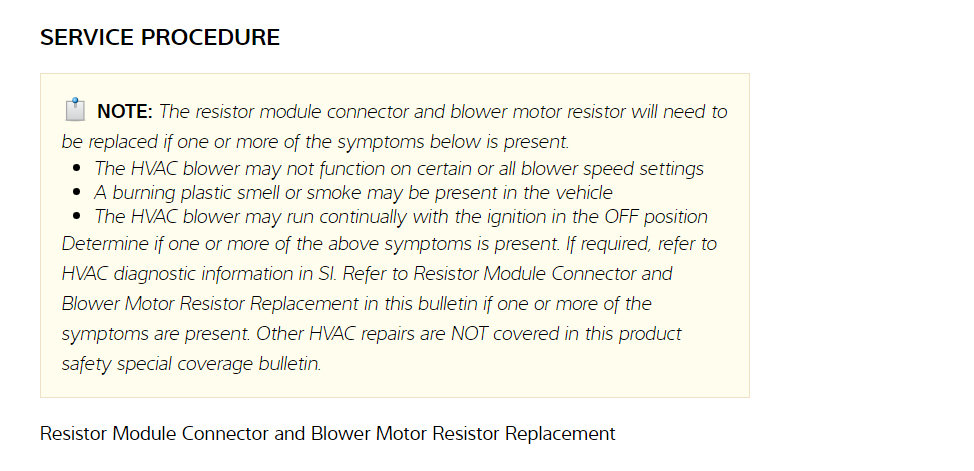

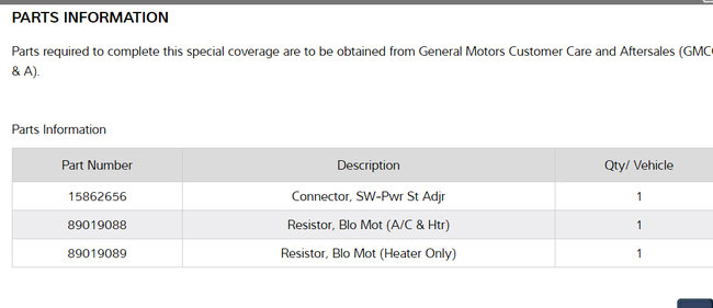

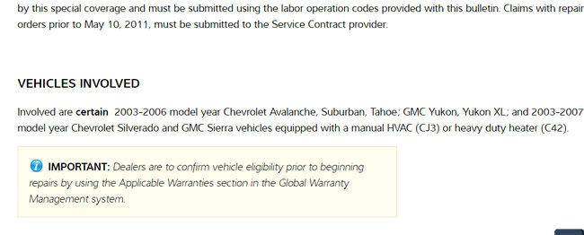

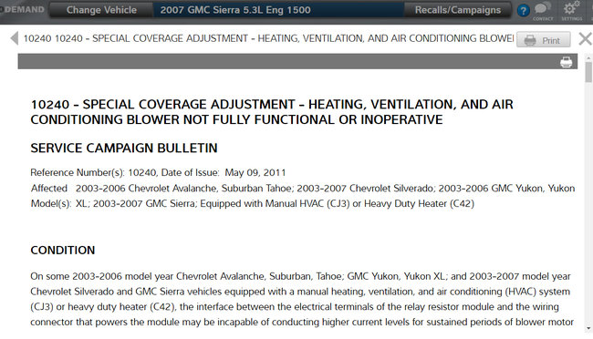

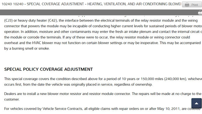

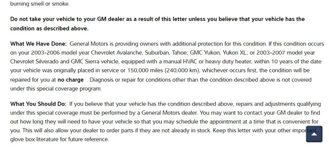

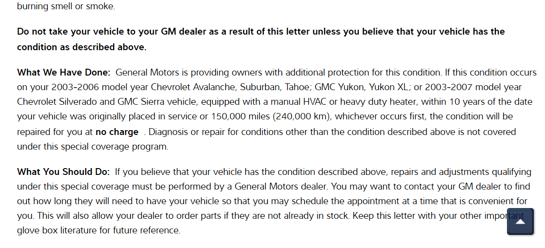

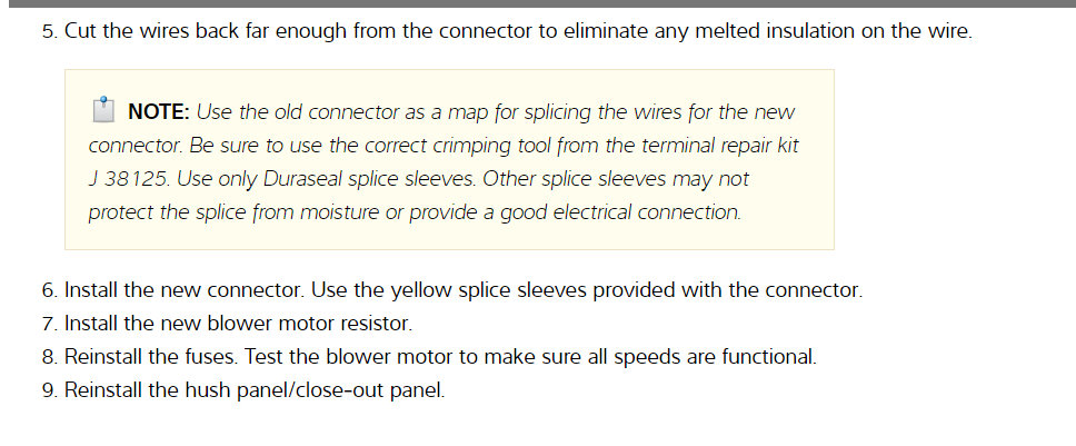

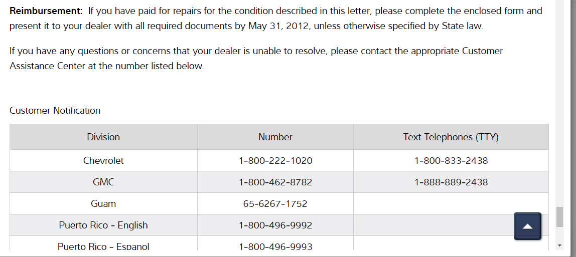

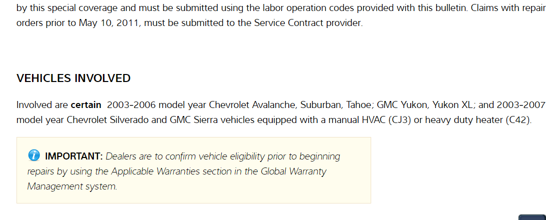

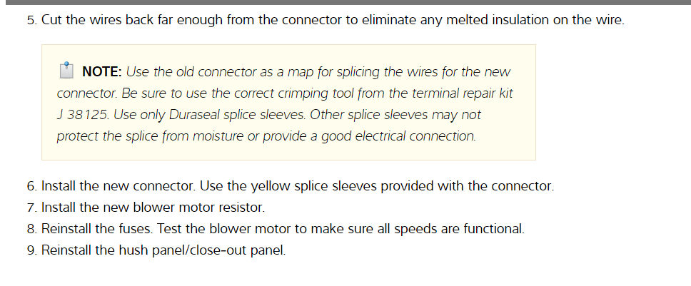

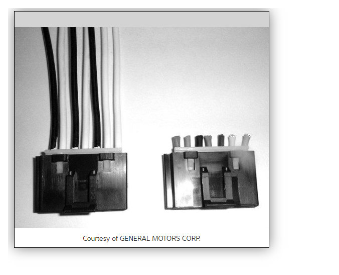

It will go off maybe a couple minutes then come back on, then blow a while and quit for maybe a half hour come back on for a couple days then quit for a while and come back on. It’s getting more frequent. Help!
Saturday, December 26th, 2020 AT 2:52 PM (Merged)
SCGRANTURISMO
  • 4,897 POSTS

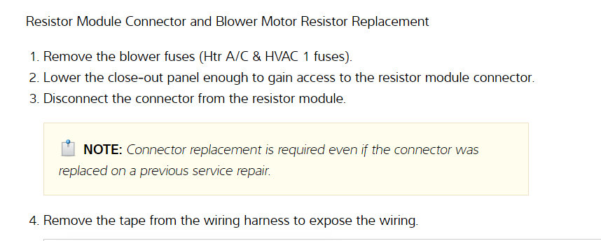

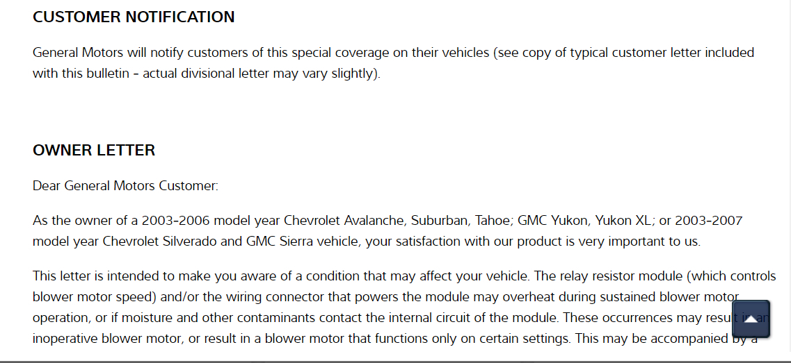

Although the time has past by a couple of years for your vehicle, I have included a Technical Service Bulletin (TSB) for your vehicle for a recall for this very issue. You still might want to get in contact with the service department for your local dealership and see if they can't fix this at no cost to you under a customer retention goodwill policy. If not, the part numbers for the required parts and the instructions from the vehicle manufacturer on how to fix this problem is included in this TSB. Please go through this TSB and get back to us with what you are able to find out.
Thanks,
Alex
2CarPros
