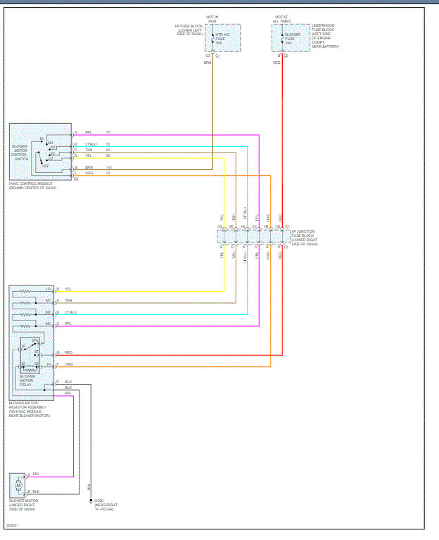

The fan for the heat works one day and not the next. I have replaced the resistor about a month ago.
Jan 13, 2020 at 7:47 AM
Good evening,
You will need to do some voltage tests to determine the issue.
You need to check for voltage to the resistor with the key on. It could be either the resistor or the blower motor.

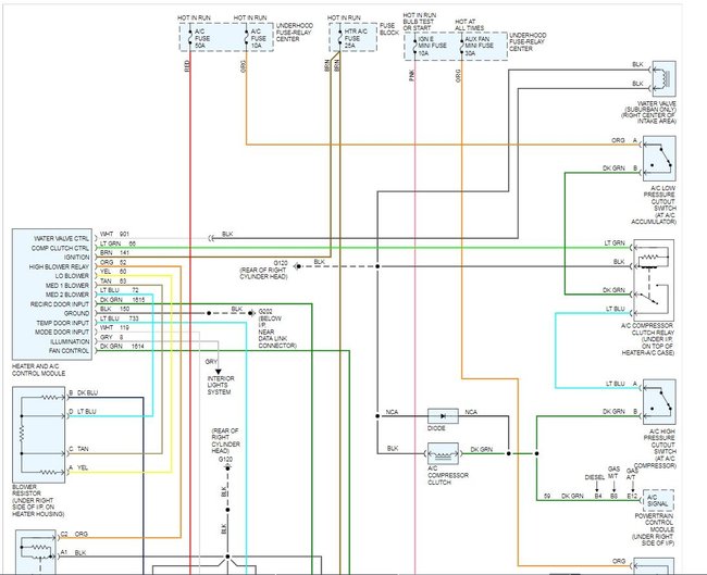

JJ JOHANNSEN
My blower motor works when I first start my truck but then after it warms up it will shut off and not blow any air out. The air is hot but the blower will not work.
Dec 26, 2020 at 2:10 AM (Merged)

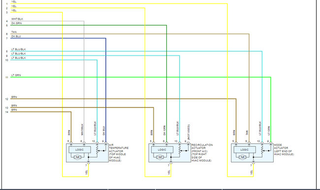

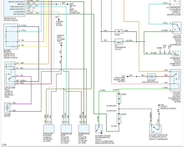

Good morning

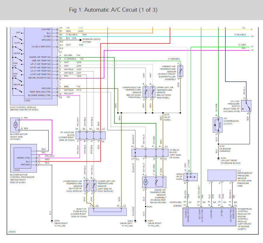

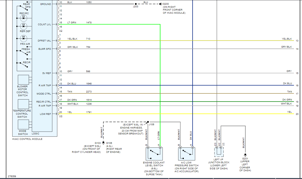

I attached a wiring diagram for you to view.
When the blower stops working, you need to do some voltage testing at the motor and the resistor to see which unit is causing the failure.

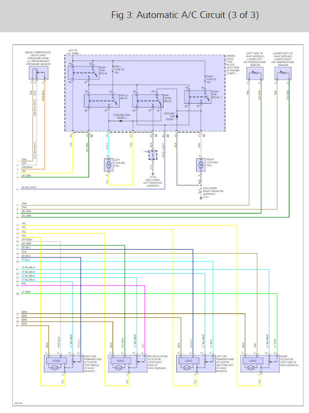

It sounds like you have a blower motor that has gone out but to be sure lets run a simple test using a test light to test for power at the blower motor. This guide will show you how.
https://www.2carpros.com/articles/blower-fan-motor-works-on-high-speed-only
and
Here is the blower location and the wiring diagrams so you can see how the system works.

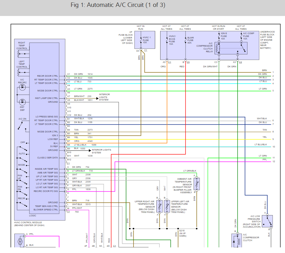

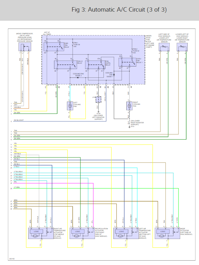

It sounds like you have a blower motor power resistor has gone out, but to be sure here is a guide to show you how to test it and a diagram below to help you see what it will be like for your truck:
I added the wiring diagrams so you can see how the system works.
Check out the diagrams (below). Please let us know what you find.

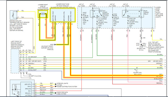

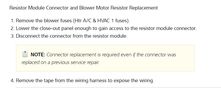

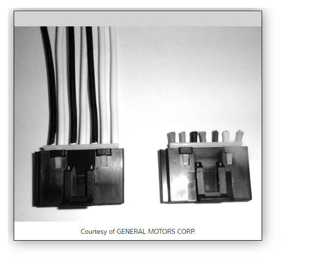

GMC11

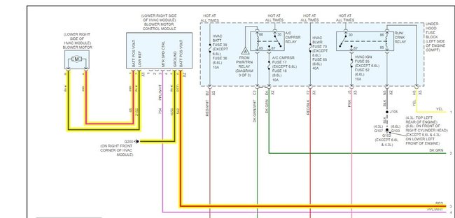

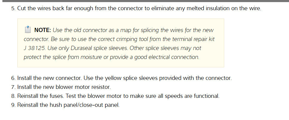

So I proceeded to replace the module after reading one of your posts. A little wiggle and it came back on and worked as it should for another two months. Then quit again so I purchased the module and the wiring kit since one of the prongs on the seven pin connector was melting/burnt. (The black wire) Double and triple checked everything. As soon as I plugged it in it got extremely hot and started smoking.
Help?
Not sure what to do next?
  • 110,248 POSTS

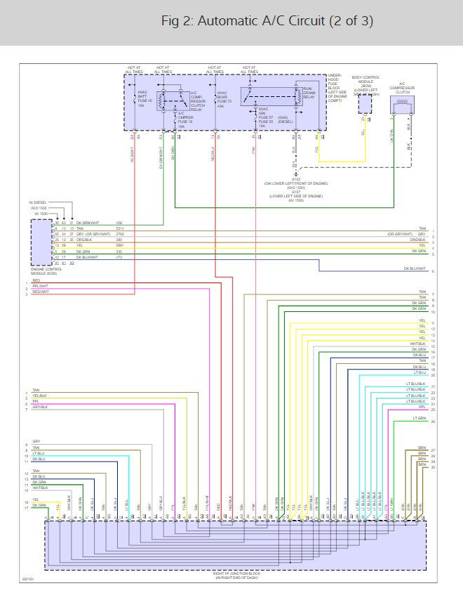

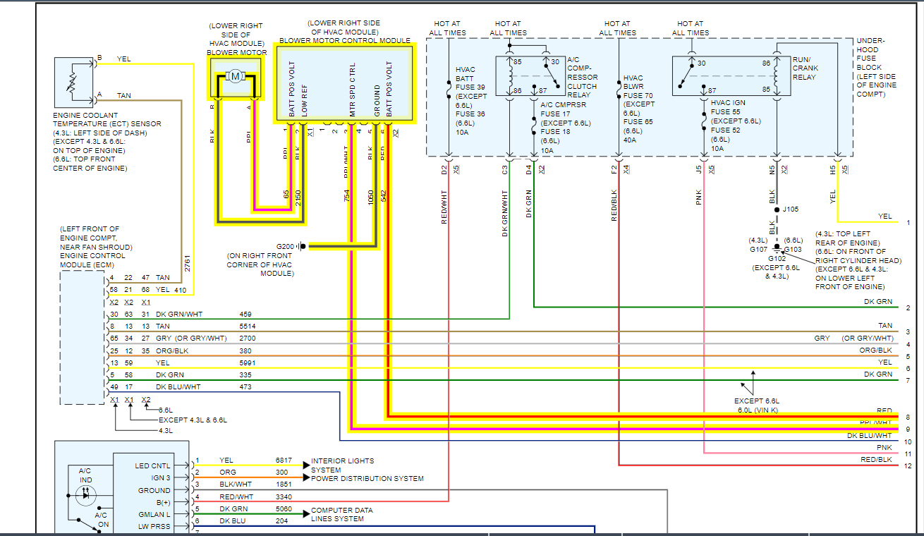

It sounds like you have a direct short. You indicated the purchase of a new wiring harness. Is it an OEM part or aftermarket? Did everything match up with what you had? Is it possible for you to take pics so I can see what is happening and indicates which wires started smoking? Or if it was the module smoking, let me know.
I attached a pic below of the wiring schematic of the HVAC blower motor system. When you say module, are you referring to what in the picture is also called the blower motor control switch?
GMC11
Oh my gosh! I feel really dumb. After walking away for a minute and coming back I noticed I crossed two wires. Probably after repositioning (basically upside down for tool placement).
I’m sorry if I wasted anyone’s time.
Although the new module does get fairly warm to the touch still. Is that normal?
All parts were from Napa.

GMC11
Warning to others, the Napa repair harness has all black and white wires. Other than that it’s identical looking.

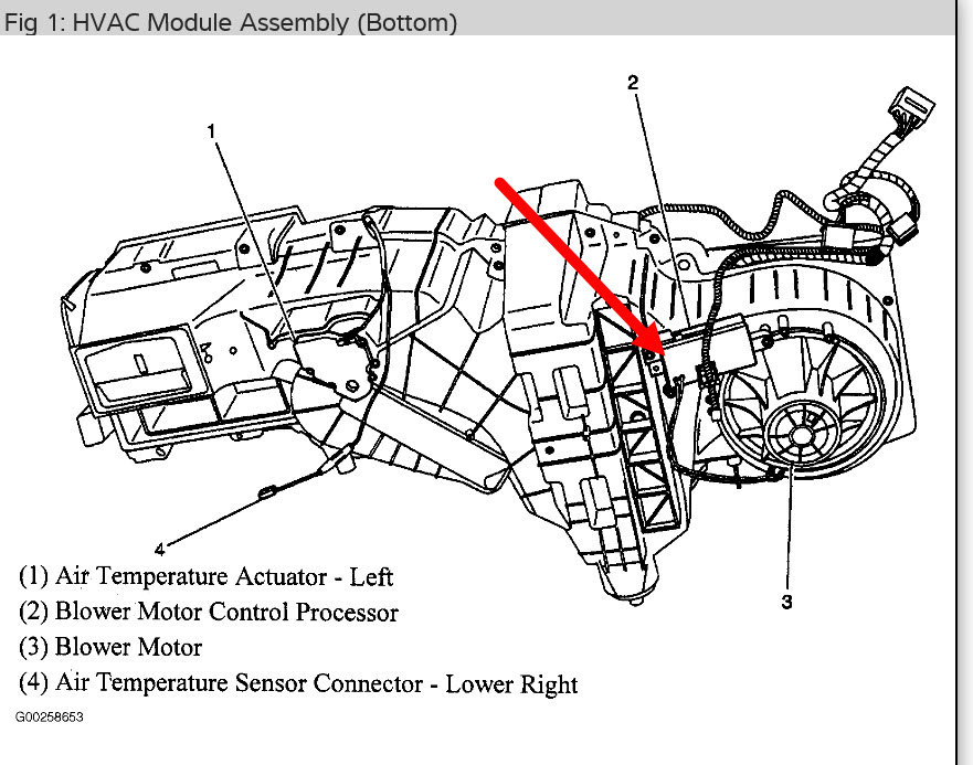

the heater blows hot air, but the fan blows like it is on low even when it is on max.
Dec 26, 2020 at 2:11 AM (Merged)

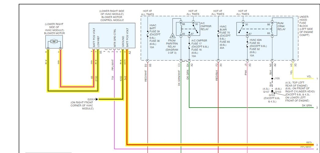

HMAC300
  • 48,601 POSTS

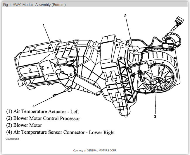

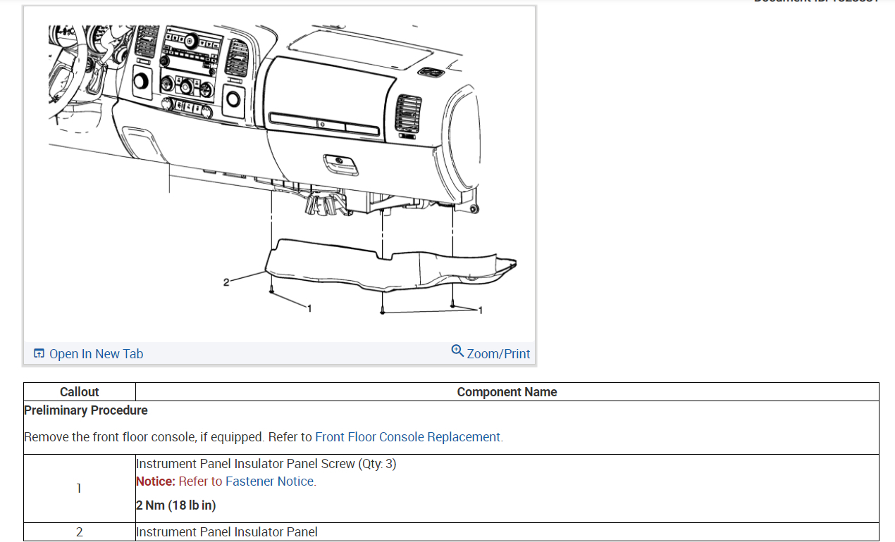

Check the blower control processor by blower motor, it may be bad. Scan for codes to see if that is the problem and not control module. See picture.

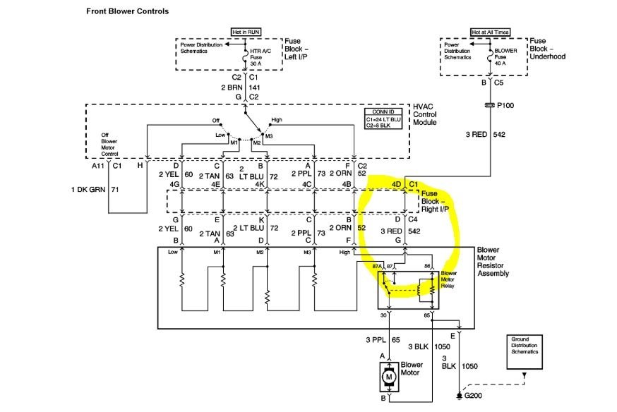

STAN JONES

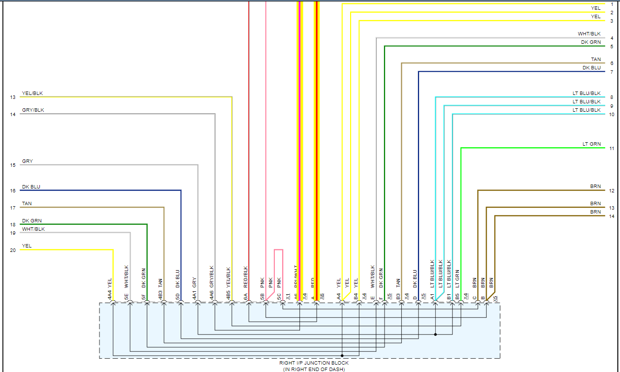

Blower quit working, it was only working on high speed. Replaced blower motor resistor but still nothing. When I change the fan speed I can hear a click down by the blower motor.

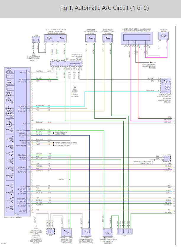

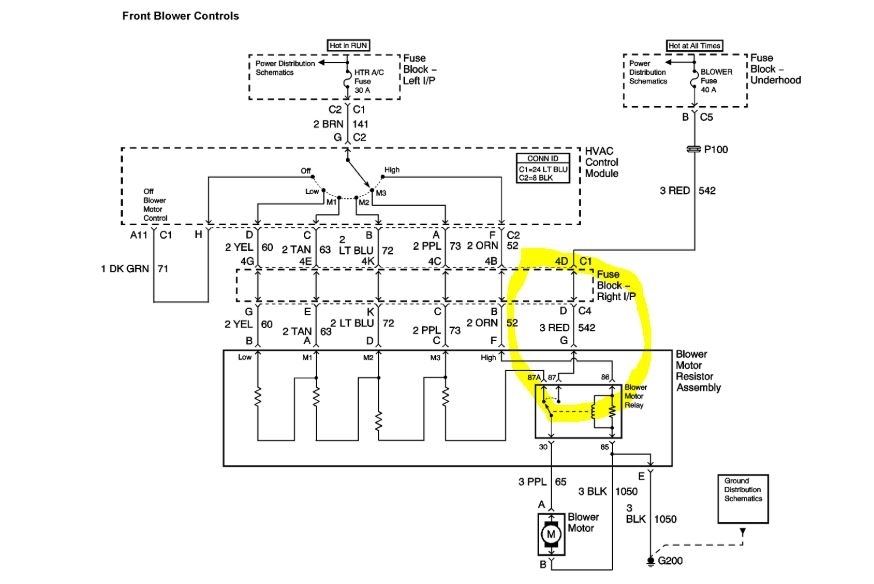

Good evening,
I attached a wiring diagram for you to view. Check the wire I circled and see if it has power with the key on................................

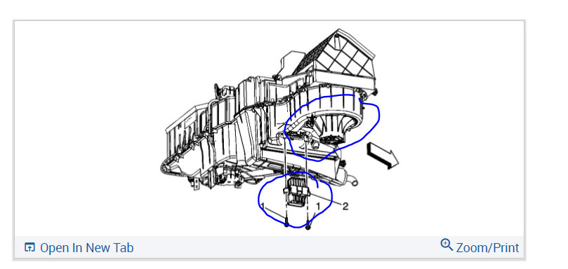

HDLH883
Heater blower quit working after stopping to fuel up. Blower was working fine before shutting the engine down. When restarted the engine the blower would not come on and radio display would not light and no signal (although volume control raised and lowered the static).
When I shut the engine off and restarted the radio worked again.
I checked the fuses and AC relay under the hood which are all good.
When I turn the fan switch on I hear a click behind the AC/heat control panel but no blower.
Dec 26, 2020 at 2:12 AM (Merged)
RACEFAN966
  • 5,029 POSTS
Sounds like the controller may be bad
read the guide on testing wiring first, it will help

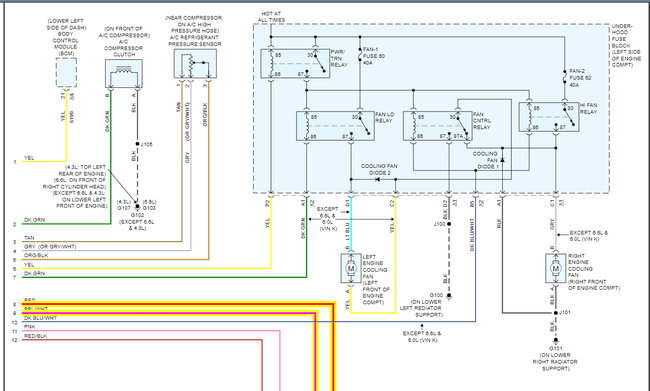

The wiring diagrams for you blower are attached below

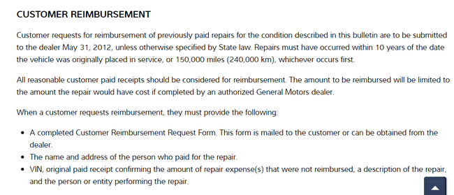

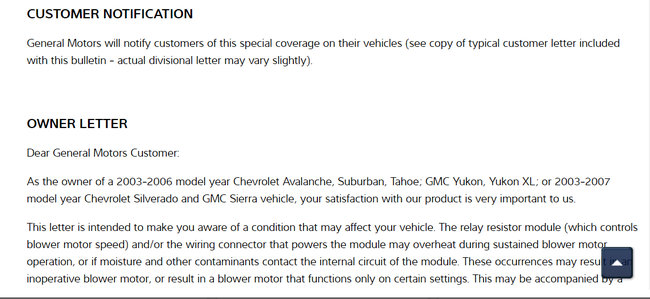

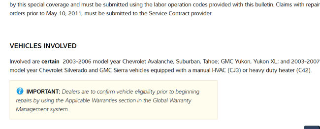

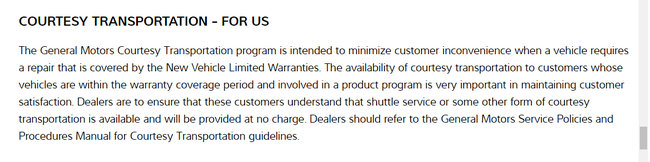

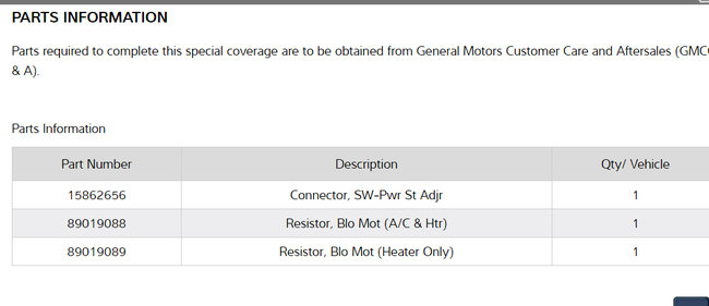

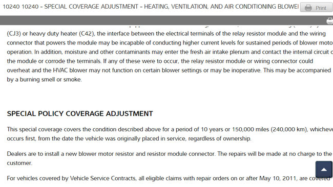

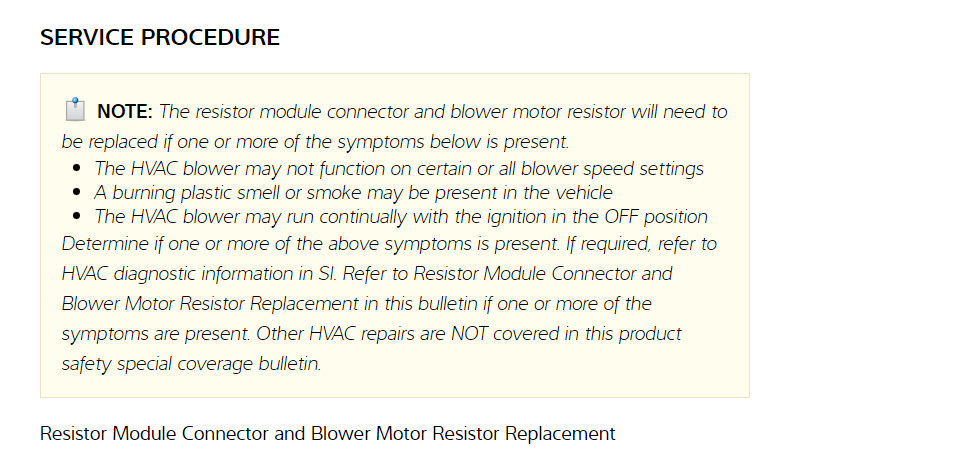

BTOLER
  • 29 POSTS

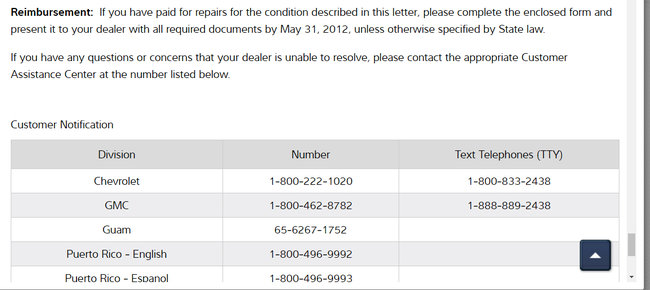

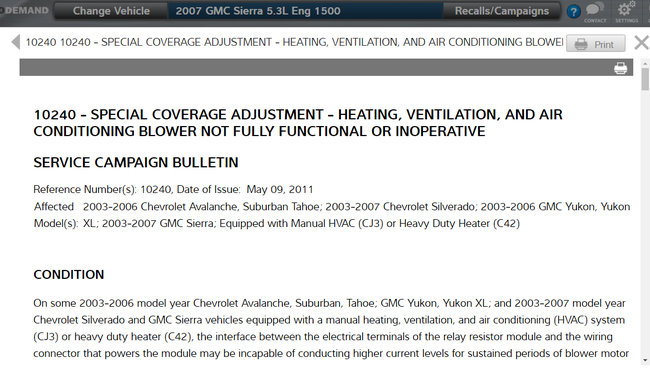

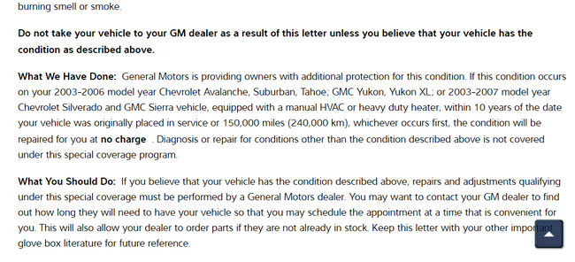

It will go off maybe a couple minutes then come back on, then blow a while and quit for maybe a half hour come back on for a couple days then quit for a while and come back on. It’s getting more frequent. Help!
Dec 26, 2020 at 6:52 AM (Merged)
SCGRANTURISMO
  • 4,897 POSTS
Although the time has past by a couple of years for your vehicle, I have included a Technical Service Bulletin (TSB) for your vehicle for a recall for this very issue. You still might want to get in contact with the service department for your local dealership and see if they can't fix this at no cost to you under a customer retention goodwill policy. If not, the part numbers for the required parts and the instructions from the vehicle manufacturer on how to fix this problem is included in this TSB. Please go through this TSB and get back to us with what you are able to find out.
