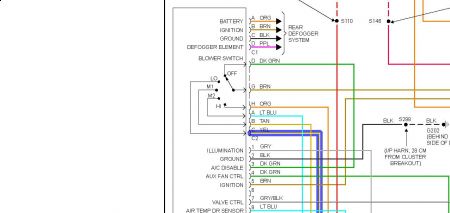

Hello I am sending anouther request on my vehicle
I have only the high setting on the fan motor
I have replaced the air actuator the heater relay the
control pannel on dash and the heater blower resitor as requested by you guys,
up until i replaced the heater relay i couldnt controll the temp it was on high always.
what next ? I am so frustrated with this now.
There are two wires going into the motor one is purple and the other is black test light works on the purple on high only tried it on lowest settring 1st
I see 2 yellow wires in a harness thas is connected to something on the fire wall but no others
after looking further i found the yellow wire going into the resistor and on low it has no power going to it

Hi adubber, Welcome to 2carpros and TY for the donation:
I want you to turn heater on set it at low and check for power at the yellow wire on the blower motor resistor let me know asap

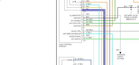

The switch is within the HVAC control module

Earlier you said you don't have power at the yellow wire on the resistor-if the switch is working properly the yellow wire should power up on the low position.

[quote:0f3d9f4791="KHLow2008"]Hi adubber,
You should have replied to your previuos post so that whoever was attanding to you can get notification and attend to you as soon as he gets online.
This would keep the history of what had transpired to allow an easier understanding of the problem and recommendations and repairs carried out.
Please do not edit the post as no notifications would be sent out.
Let me know the following.
With blower control speed at Low, you have no power supply to the yellow wire. Let ma know the following.
1. Do you have power at the Tan wire when blower speed is set at M1?
2. Do you have power at the Light Blue wire when blower speed is set st M2?
3. Does applying battery voltage to the terminal of the resistor at the yellow wire work the blower at low speed?
4. Did you test the HTR fuse ( 25A) in the fuse box?
I will copy this thread to the previous one and we will work from there.[/quote:0f3d9f4791]

Sorry for the delay in replying.
Just to be sure we are on the right track with the correct model, the circuit I have posted is for the 4.3 L engine. If it is not correct, please let me know.
From the last diagnosis, we are getting somewhere. You have a power supply fault and we are getting near to our destination.
The blower motor and resistor are perfectly good.
Power is not coming out of the HVAC control unit and you would need to test if power is available at the speed control switch. Test the brown wire for battery voltage with ignition switch turned ON.
If power is available and no voltage is available at the Yellow, Tan and Light Blue wire when speed is turned to low, M1 and M2 respectively, the control switch is faulty.

You can test the switch for continuity according to the various speed mode.
Most important wire to test would be the power supply.
Was the switch replaced of the correct type?

If you have power on the brown wire coming from the heater 25amp fuse when key is On and when you switch to low the yellow wire should have power-Is this happening if not were right back with HVAC control module. Now if yellow has power ,blower motor should come On-if not-check and test the ground pointG201 at right side of dash. Get back with us
