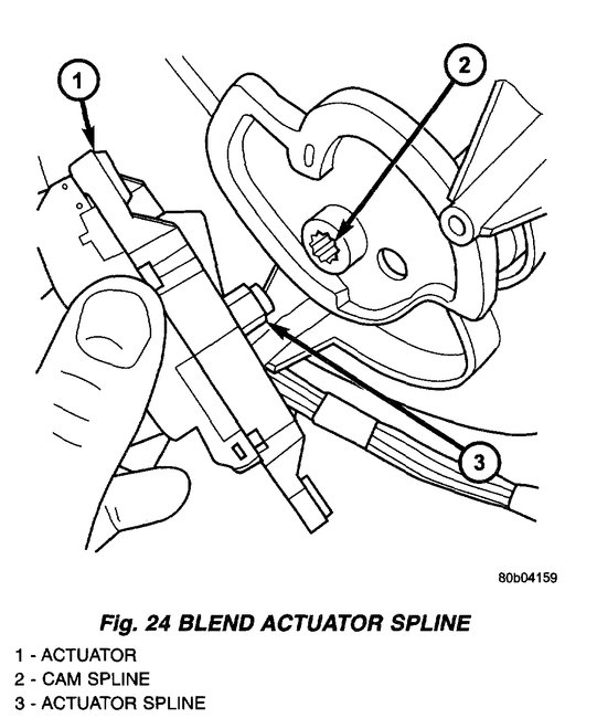

If both are hot, the next thing to suspect is what is call a blend air door actuator. It is what allows the heat to enter the vehicle.

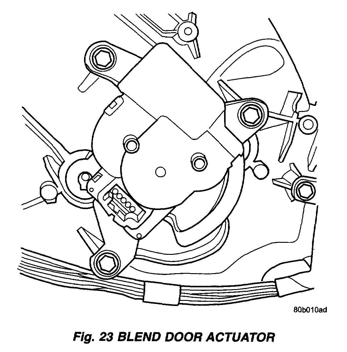

Fig.23 Blend Door Actuator
Pic 1
6. Remove actuator retaining screws and pull actuator straight down. Note actuator shaft position for installation reference.
Fig.24 Blend Actuator Spline
pic 2
INSTALLATION
1. Install blend door actuator on the housing, making sure the shaft spline is positioned properly with the cam.
2. Install tighten the actuator mounting.

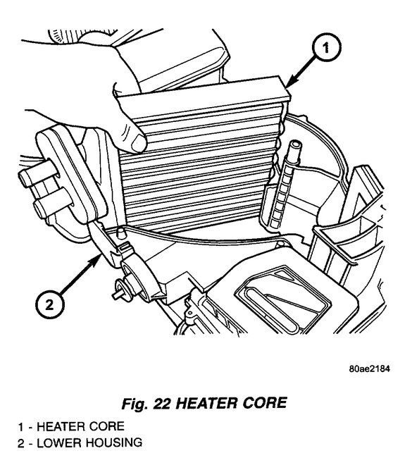

If the heater core is the issue, you can try flushing it. Basically, remove both hoses to it at the firewall and spray water through in both directions. If water doesn't flow, replace the heater core.

Here are the directions for core replacement specific to your vehicle. The attached pics correlate with the directions.
_________________________________
2001 Dodge Stratus Sedan V6-2.7L
Removal and Replacement
Vehicle Heating and Air Conditioning Heater Core Service and Repair Removal and Replacement
REMOVAL AND REPLACEMENT
REMOVAL
1. Disconnect negative battery cable.
2. Remove HVAC housing from the vehicle. Refer to: "Housing Assembly HVAC : Service and Repair" See: Housing Assembly HVAC > Service and Repair

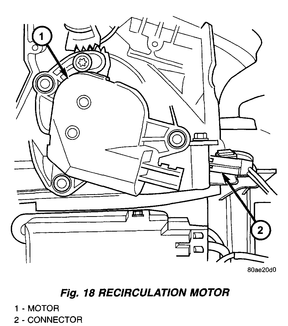

Fig.18 Recirculation Motor
pic 3
3. Disconnect connector from recirculation motor.

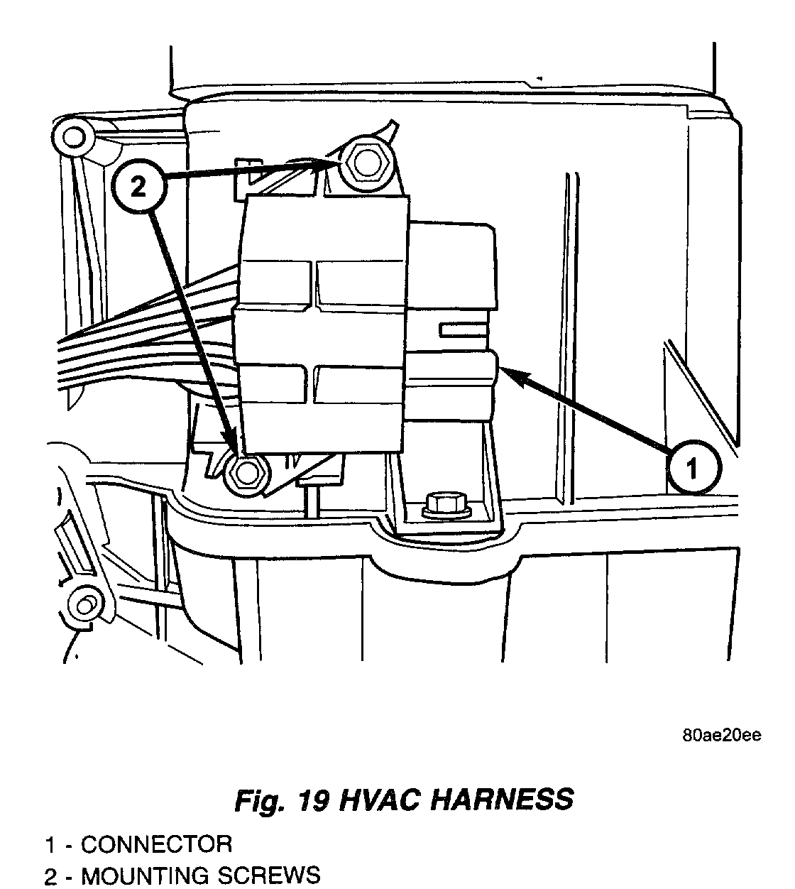

Fig.19 HVAC Harness
pic 4
4. Remove wiring harness connector from the top of the housing.

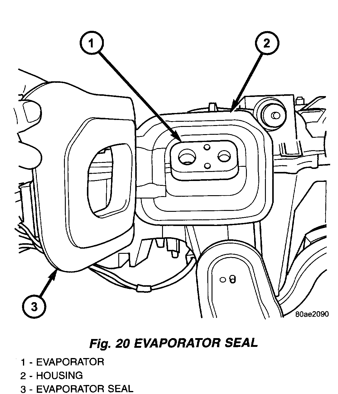

Fig.20 Evaporator Seal
pic 5
5. Remove seal around evaporator coil inlet/outlet.
6. Remove retaining screw from the top of the housing.

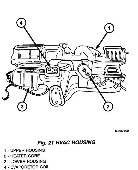

Fig.21 HVAC Housing
pic 6
7. Separate the upper from the housing from the lower.

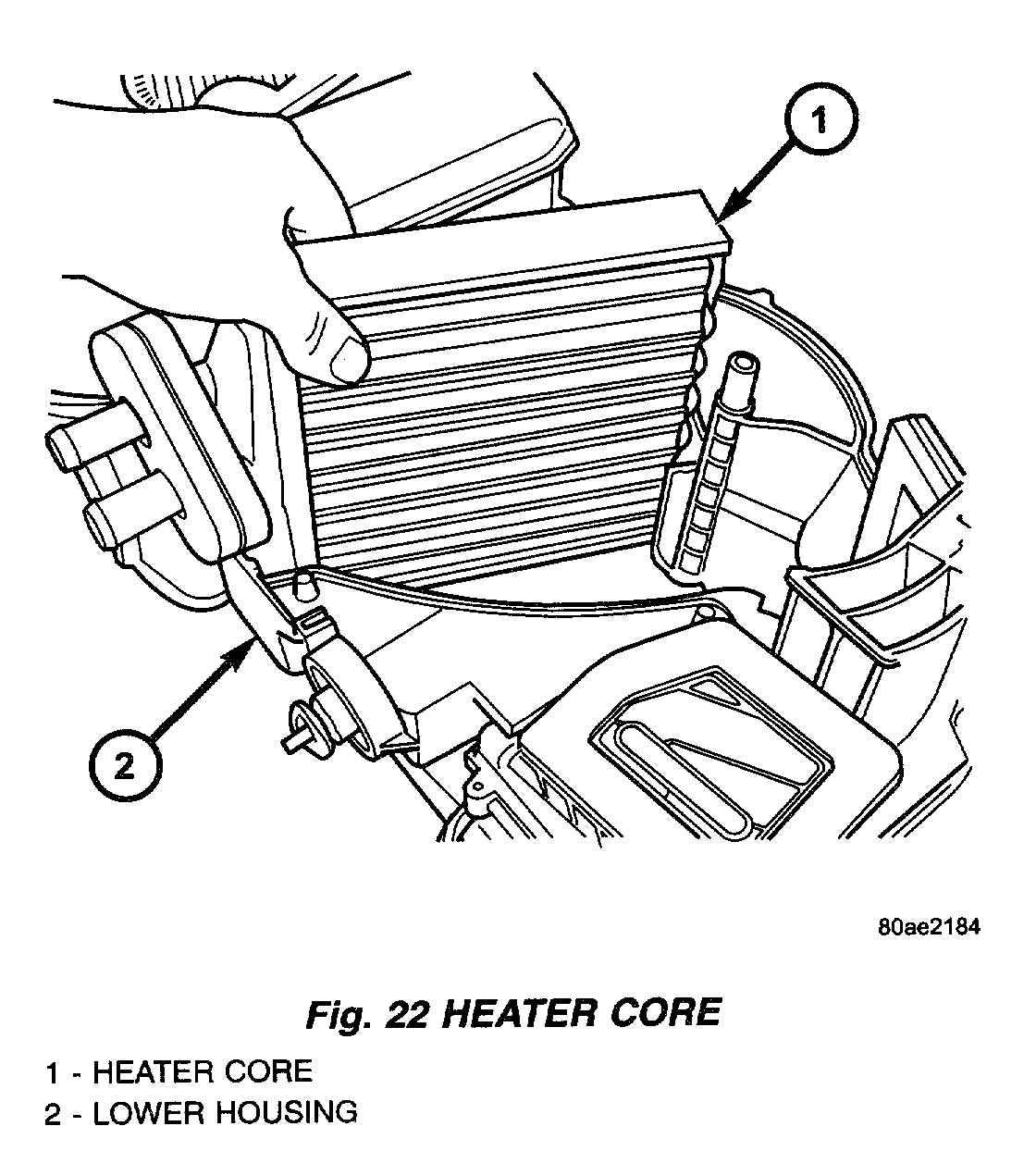

Fig.22 Heater Core
pic 7
8. Lift heater core out of lower housing.

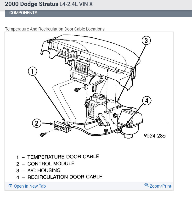

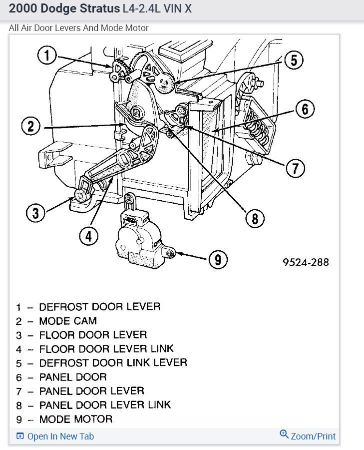

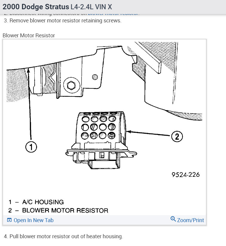

I have a 2000 dodge stratus that only has the highest setting on the blower motor working and I have no heat. It is barely warm at all. I have changed the thermostat, radiator cap, the heater core hoses are both hot. I have removed the radio and the mixture damper is working great and the cable is in tact. Also I found a fuse called the iao fuse and it remembers all the vehicles settings. I removed it for 30 secs and then reinstalled and I could here the air conditioning flappers moving around and the air was moving around when I started the car after I reinstalled that fuse. So I am assuming the flappers are all in sync. I also take off the radiator cap and give it gas and the water shoots sky high so I would assume the water pump is fine. But yet I have very cool heat. Any other ideas where to check?
Saturday, October 31st, 2020 AT 10:53 AM (Merged)
  • 109,885 POSTS
As far as the blower motor only working on high, replace the blower motor resistor. Now the heat issue is different. If the coolant blows out of the radiator, that tells me there is a head gasket problem which all make the heater not work due to exhaust gasses.
Here are 2 guides that will help us find the problem.
and
If this checks out okay I would replace the mode door actuator diagrams below. Check out the diagrams (Below). Please let us know what you find.
SLRENO
Thanks for the guides I check the head gasket it was fine, the problem was the mode door actuator I had to get a new one for $56.00. All fixed! I love this site.
