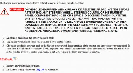

My heater has 4 different control settings, nothing comes out, heat our AC on the first 3 settings, but does only work on #4.. Heat and AC comes out, but only on #4, nothing on 1-3 settings.. Any help is appreciated.. Thanks, Jeff

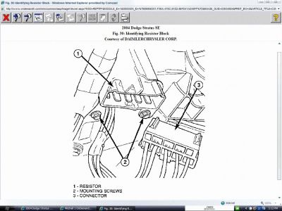

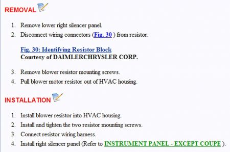

Fan speed resistor has lost 3 of its positions.Follow the wires from the blower motor back to the resistor, usually is screwed into the HVAC plenum near the blower motor

Undo the negative battery cable for 2 mins then proceed to test the blower resister, here's how!
https://images.2carpros.com/forum/automotive_pictures/62217_Resistor_1.jpg
https://images.2carpros.com/forum/automotive_pictures/62217_Test_1.jpg
https://images.2carpros.com/forum/automotive_pictures/62217_Test2_1.jpg
