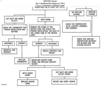

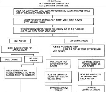

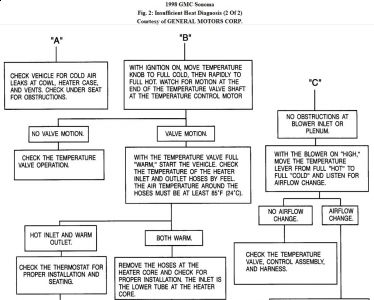

Here is a flow chart for troubleshooting. See if you can come up with any information that might help us get to the bottom of this.
https://www.2carpros.com/forum/automotive_pictures/192750_HeaterDiagnosis98SonomaFig01a_1.jpg
https://www.2carpros.com/forum/automotive_pictures/192750_HeaterDiagnosis98SonomaFig01b_1.jpg
https://www.2carpros.com/forum/automotive_pictures/192750_HeaterDiagnosis98SonomaFig02a_1.jpg
https://www.2carpros.com/forum/automotive_pictures/192750_HeaterDiagnosis98SonomaFig02b_1.jpg
