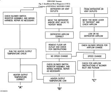

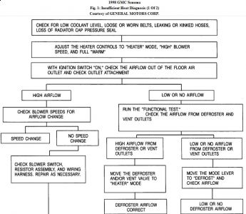

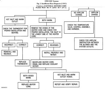

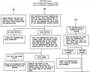

Here is a flow chart for troubleshooting. See if you can come up with any information that might help us get to the bottom of this.
