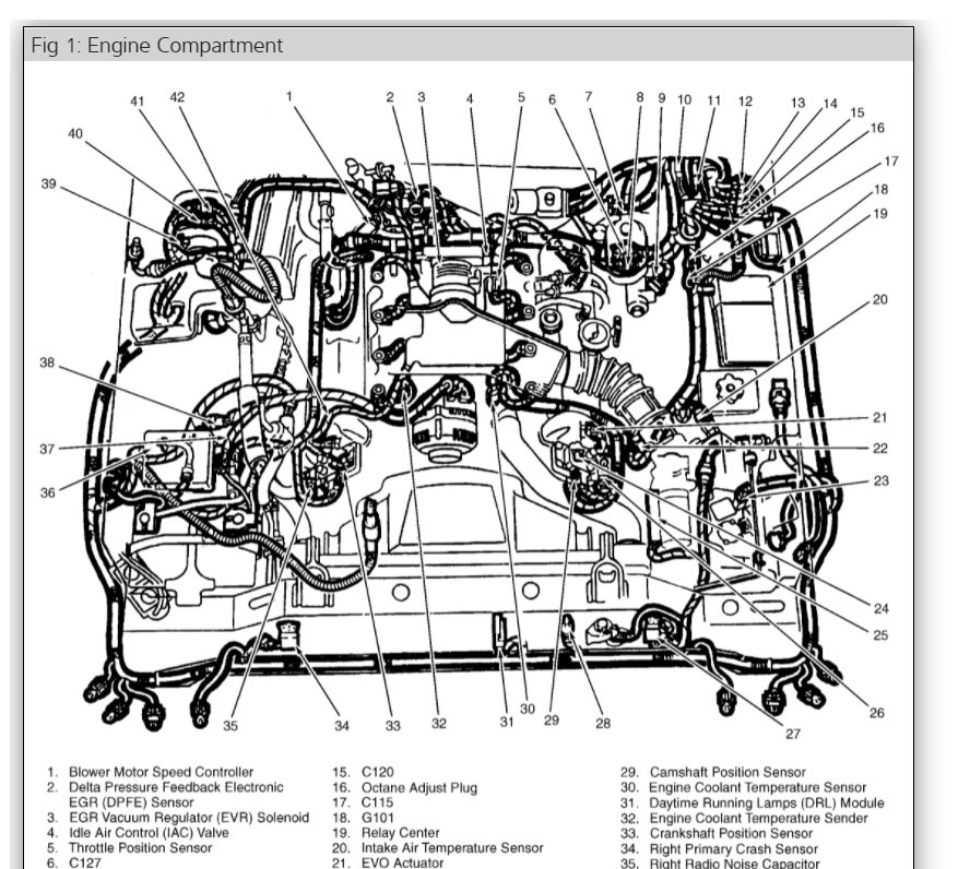

Does not work when you step on the brakes it will work. Then as you are accelerating you lose the A/C or heat and blower only blows on high.
May 24, 2021 at 10:20 PM
  • 55,743 POSTS
This sounds like the blower motor is bad. To be sure let's use this guide to check the power and grounds. Here is a guide to help you step by step with instructions in the diagrams below to show you how on your car:
https://www.2carpros.com/articles/blower-fan-motor-works-on-high-speed-only
For the blower speed problem the resistor sounds like it needs to be replaced as well.
