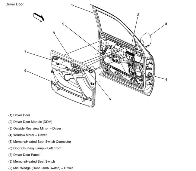

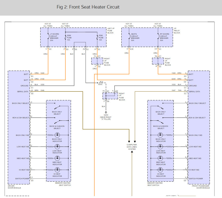

My heated seat buttons will light up through all phases (high, med, low) but will shut off after a short time. Suspecting a fuse.
Jan 7, 2018 at 3:20 AM
  • 55,746 POSTS
Hi Matt,

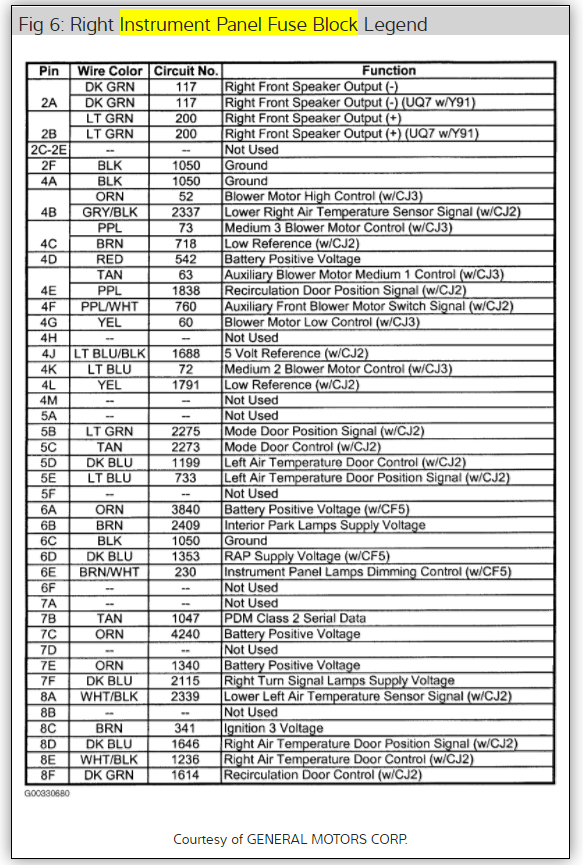

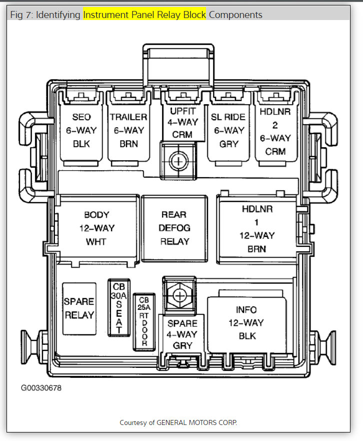

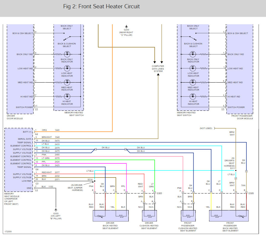

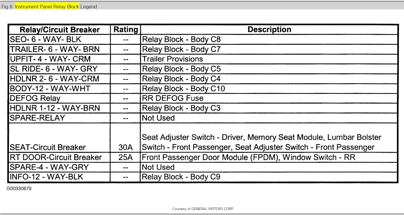

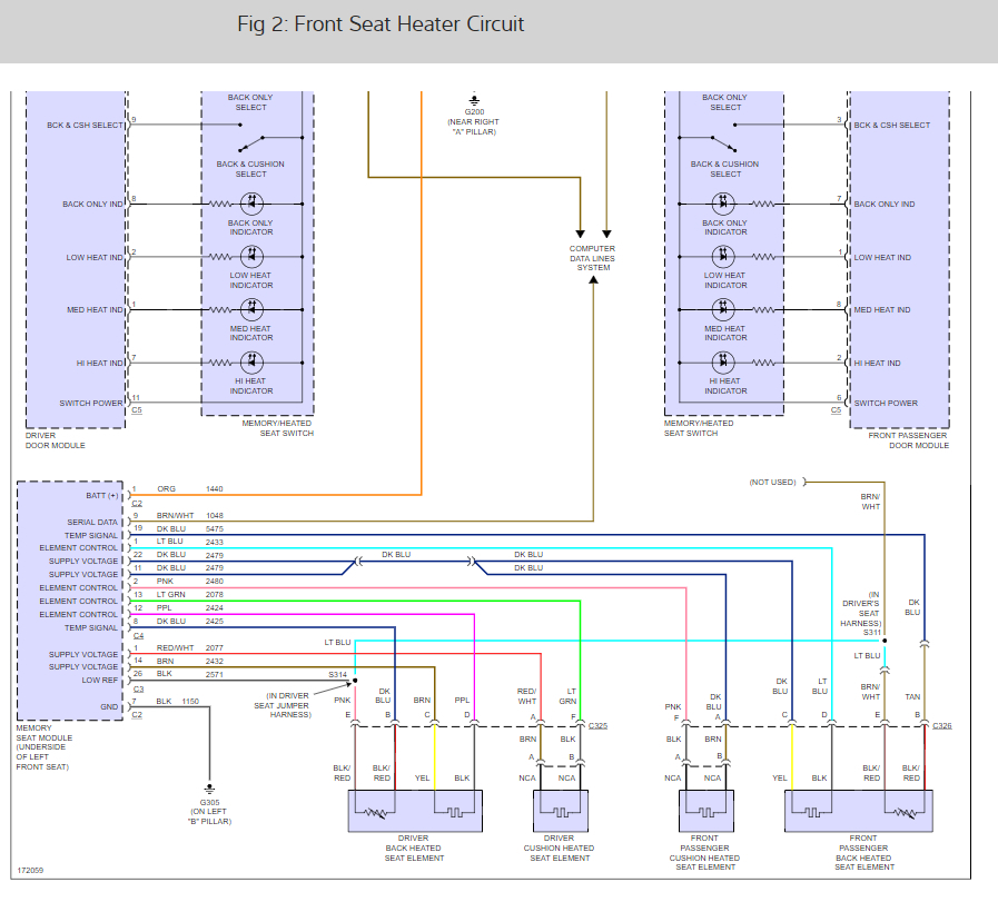

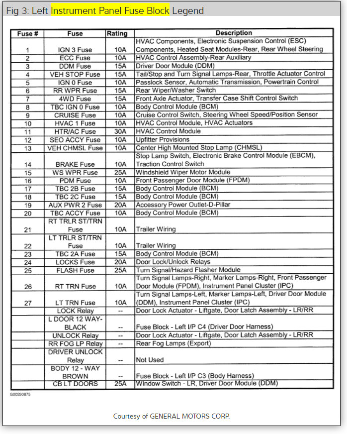

I think if it was the fuse the problem would be all the time. It sounds more like the heated seat controller which is in the drivers door. There is one for each seat but the one in the drivers door seems to be the one that goes out I have heard from others.

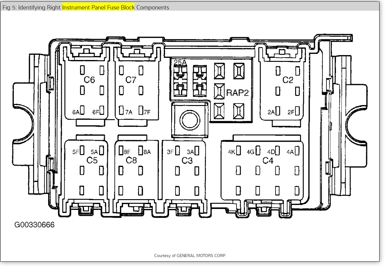

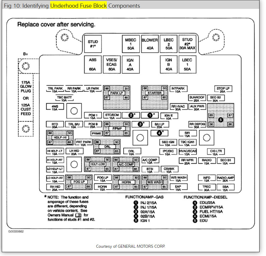

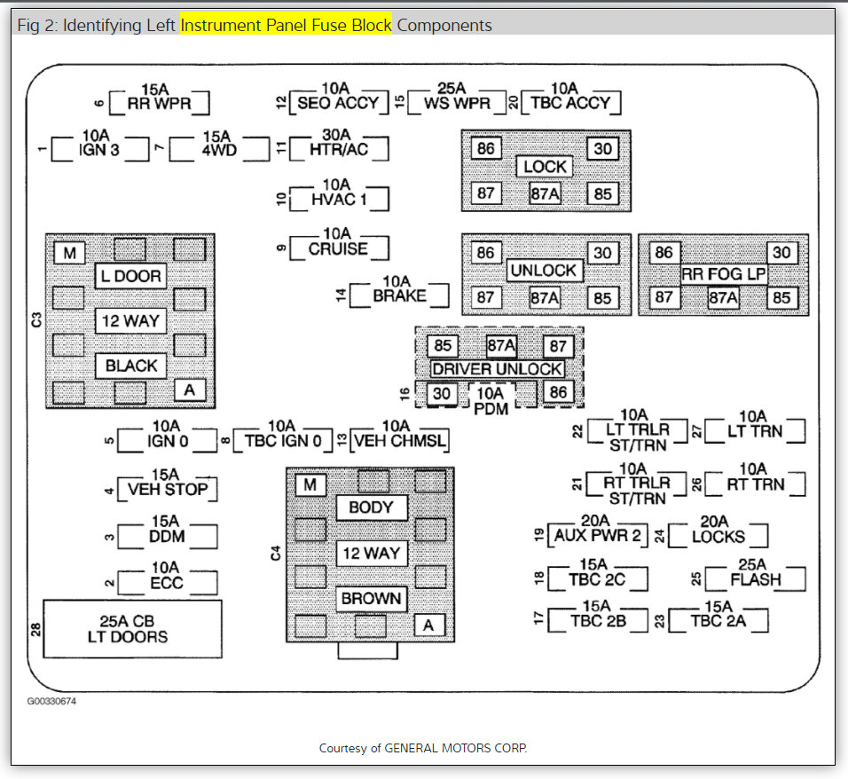

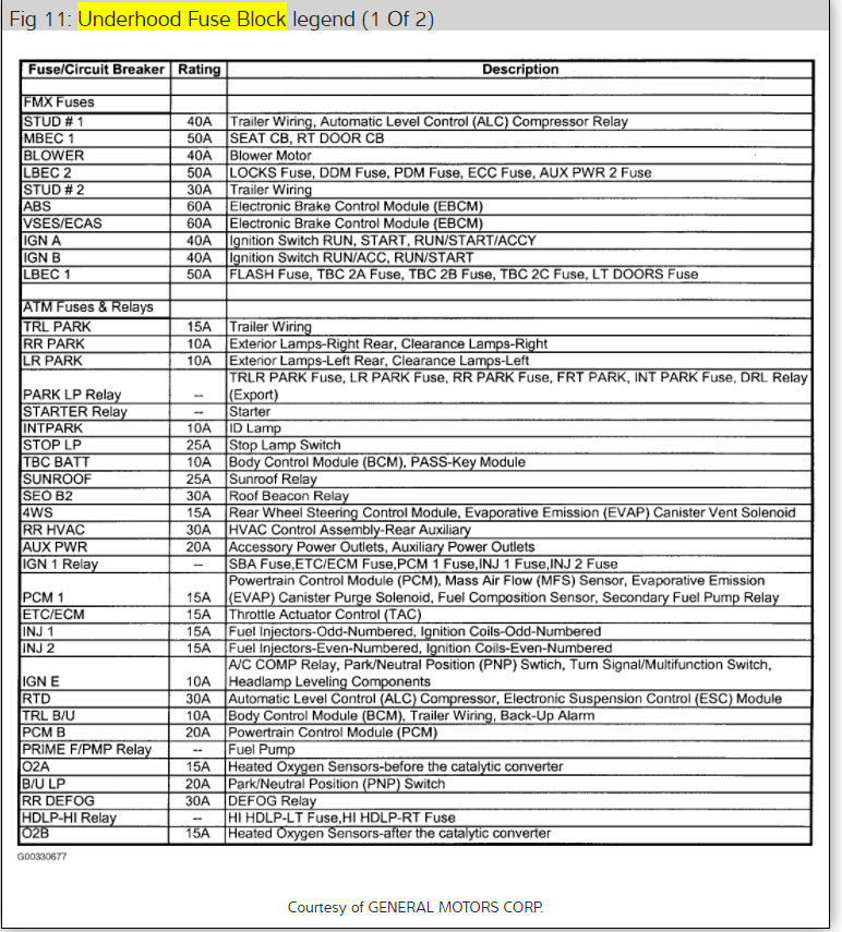

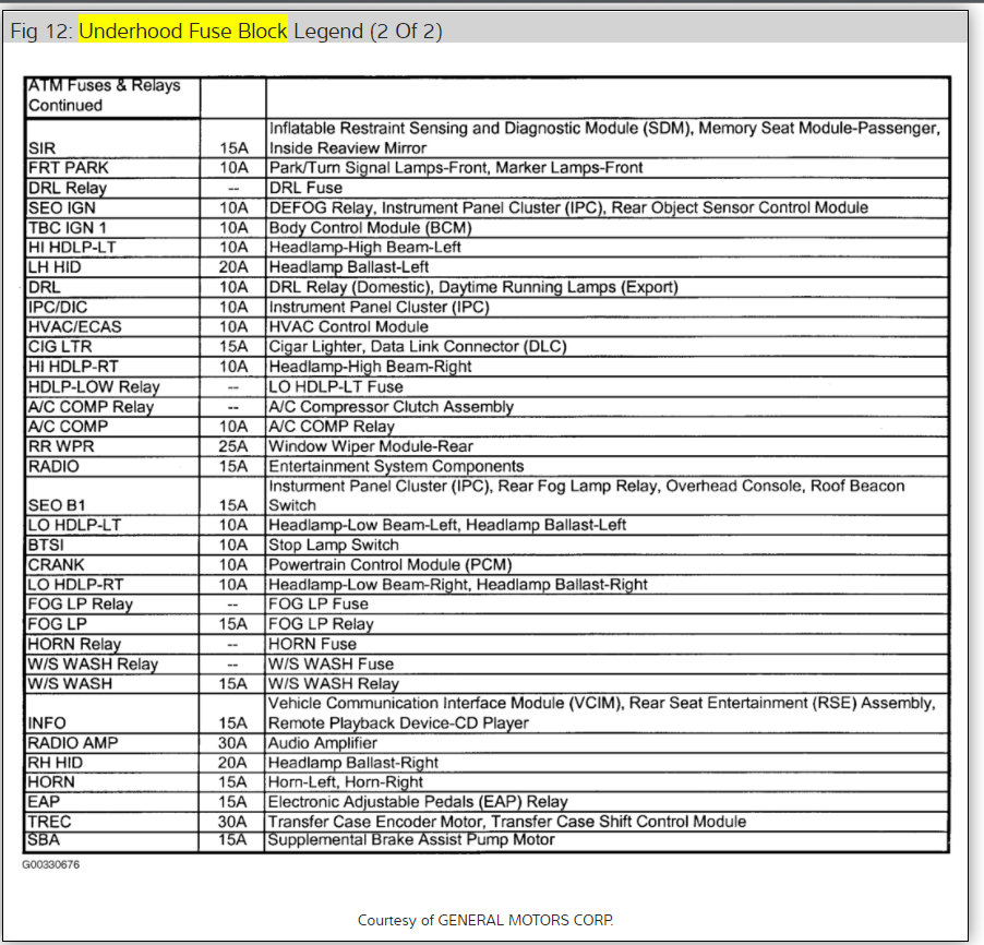

We should check the fuses because you never know there are five fuses that run the system check the wiring diagram to tell you which ones they are.
