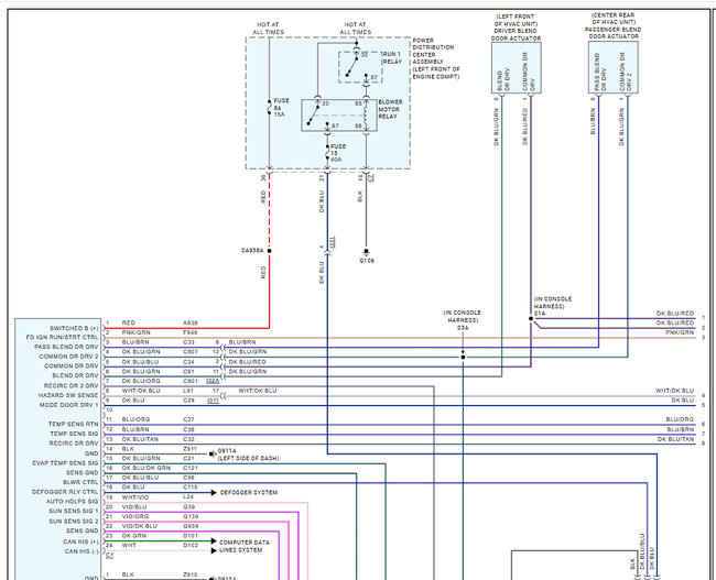

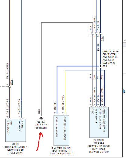

So first I would check the power and ground to the blower motor this guide will show you how.
https://www.2carpros.com/articles/how-to-test-an-automotive-hvac-system-blower-fan-motor-a-detailed/

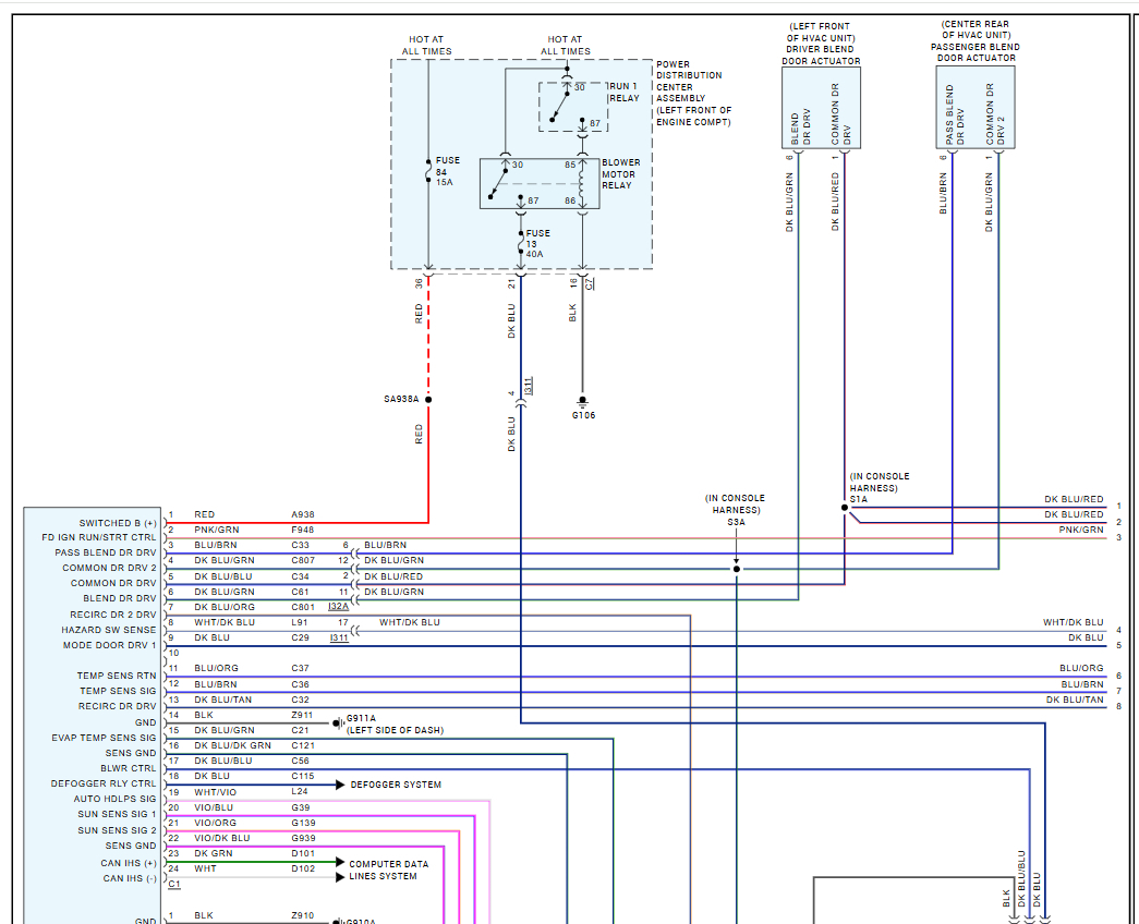

Most of the time the problem is the blower module or did you replace that and you called it a regulator? Also, there is a blower motor and a run 1 relay in the fuse panel under the hood. While you are there check the #84 fuse 15 amp. Here is the wiring diagram so you can see how the system works. Check out the images (below). Please let me know what happens.

Ok that diagram is past my knowledge level. Where's the run 1 relay located? I'll let you know.

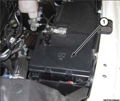

No worries, here is the location of both relays. Check out the images (below). Please let me know what happens.
Jun 2, 2026 at 7:29 AM
DAVENOOB
  • 371 POSTS
Only one picture. Are both relays in same spot?
Jun 2, 2026 at 8:15 AM
  • 55,684 POSTS
They might be internal to the PDC. I would check for power to the dr/blu wire at the fan motor when the AC is on and running first. This guide can help

Alright so did all sorts of tests. Fan works when relay is bridged, power seems to end in the resistor which has been replaced. I checked the relays(new and old) and was at .5. The one test I forget what it was but only pulled 8 ohm or volts when should 12.6 ohms/volts or there is a power overload issue I belive it said. Sorry I can't be more specific but was testing old and replacement parts for the whole thing so sone of the tests run together. Let me know if this makes sense or if you can make sense of it. Thanks
Jul 25, 2026 at 11:54 AM
  • 55,684 POSTS
IT sounds like you have a bad ground can you please check the G910A which is the black wire at the blower motor module. Let me know.
Jul 25, 2026 at 5:49 PM

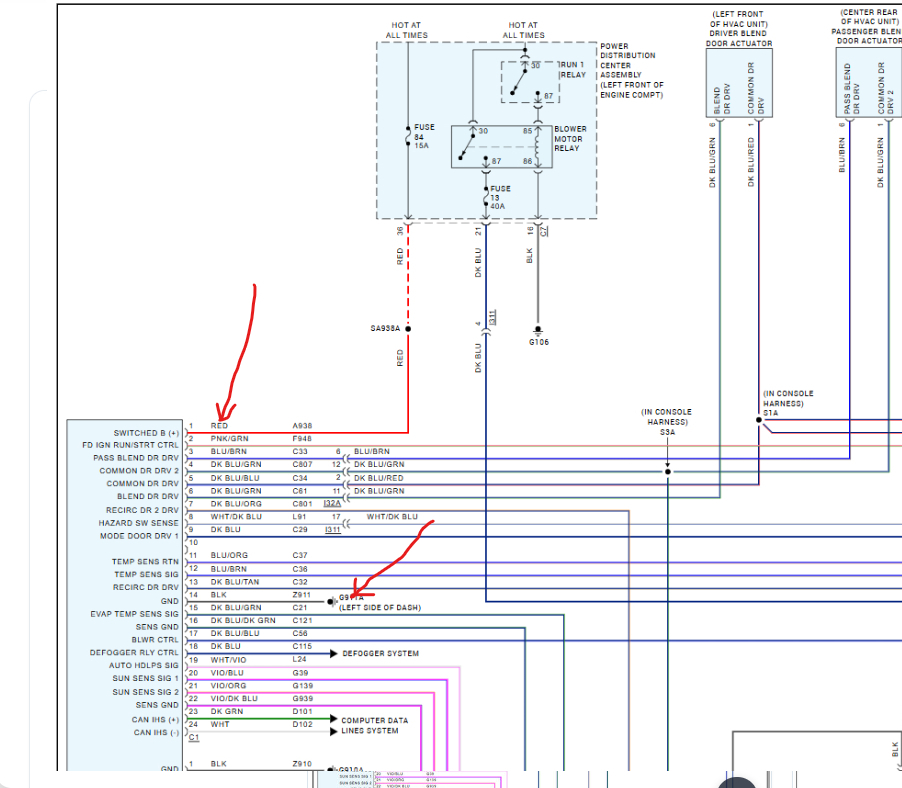

Jul 30, 2026 at 12:16 PM
  • 55,684 POSTS
Then you found the problem, the dr/blu wire should have 12 volts, it is supplied at the blower relay which is located at the fuse panel under the hood. I would swap the relay out and test again. Also, please test pin 30 for 12 volts at the relay.

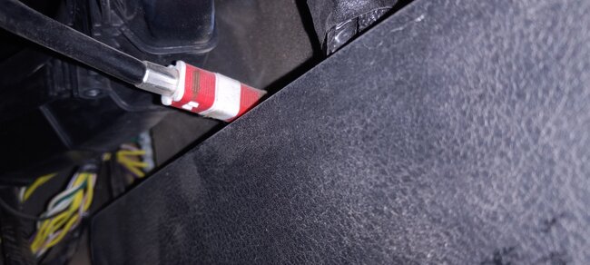

Is this part of this system? Passenger side side kick panel.
Aug 1, 2026 at 11:22 AM
  • 55,684 POSTS

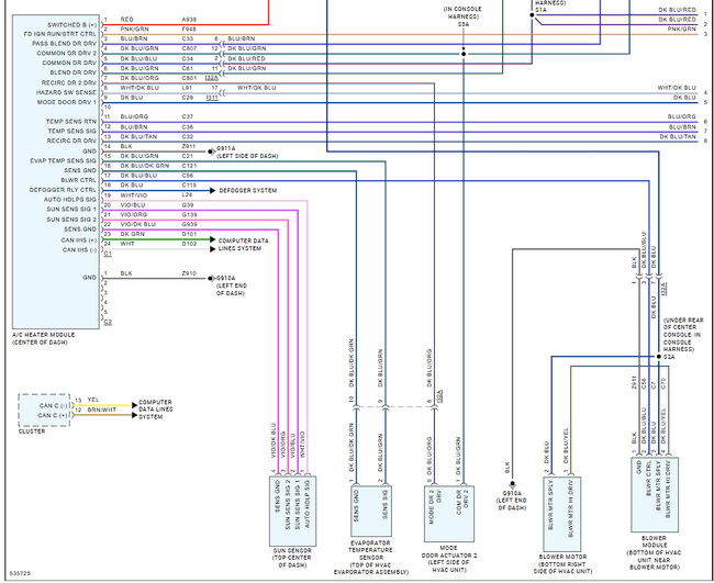

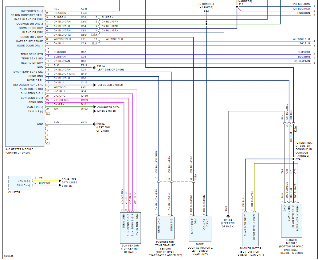

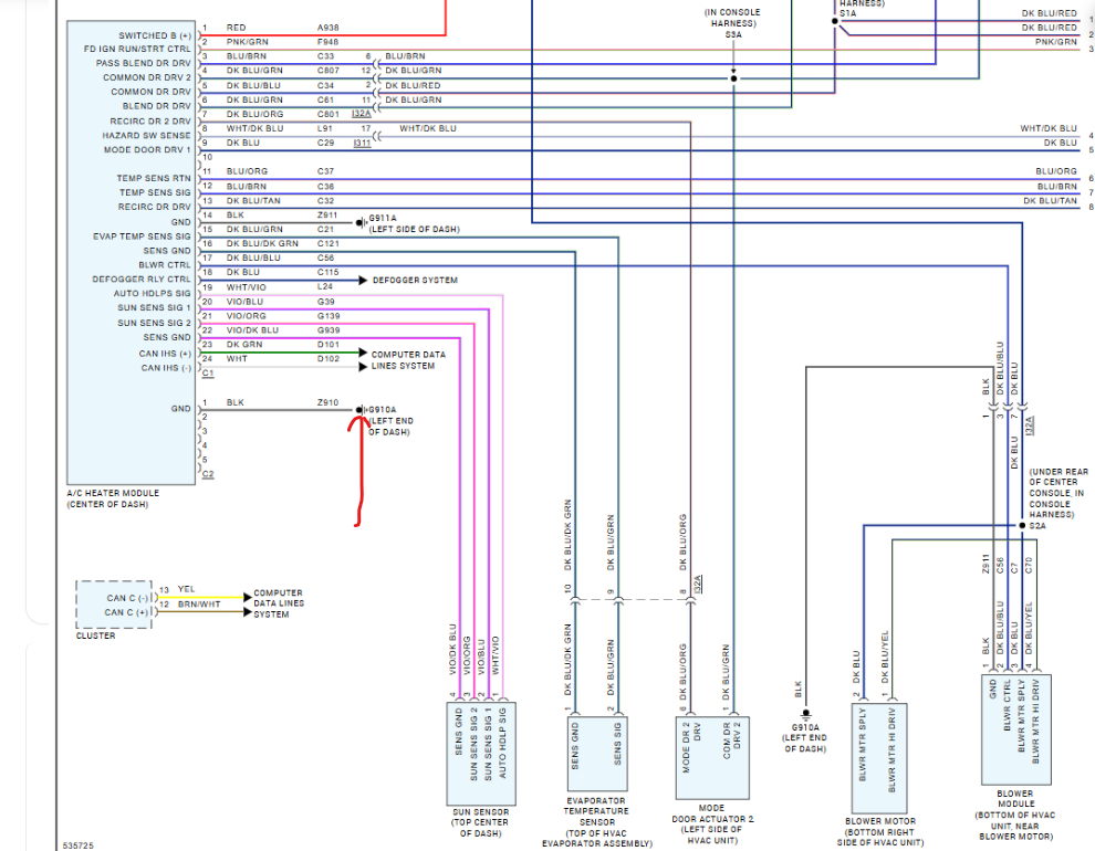

That look like it i a radio antenna. So the blower motor and speed control has power and ground correct? IF so lets check for power and ground at the HVAC controller. Here is where to check for power and ground.
Aug 2, 2026 at 8:23 AM
DAVENOOB
  • 371 POSTS
Ok that makes 0 sense to me. Don't have any idea what I'm supposed to be looking at. What part located where?

  • 55,684 POSTS
The part that is visible that you turn the knobs at which is not lighting up.
Aug 2, 2026 at 9:04 AM
DAVENOOB
  • 371 POSTS
Ok power going to controller 12.43 volts. Power going out of controller couldn't get any voltage with and without the 5 wire harness plugged in. Also tried with old and new controller the voltage would hit .2-.3 but no real voltage. Stuck wires in back of harness while plugged in and tested and same results both controllers.
Aug 2, 2026 at 1:15 PM
DAVENOOB
  • 371 POSTS
The controller lights up until fan is turned above low speed power stops. Hazard lights work and knobs light up.
Aug 2, 2026 at 1:16 PM
  • 55,684 POSTS
It sounds like you have a and controller, plus please go over the testing again. Also go over all wiring, here is a guide use the diagram above.
