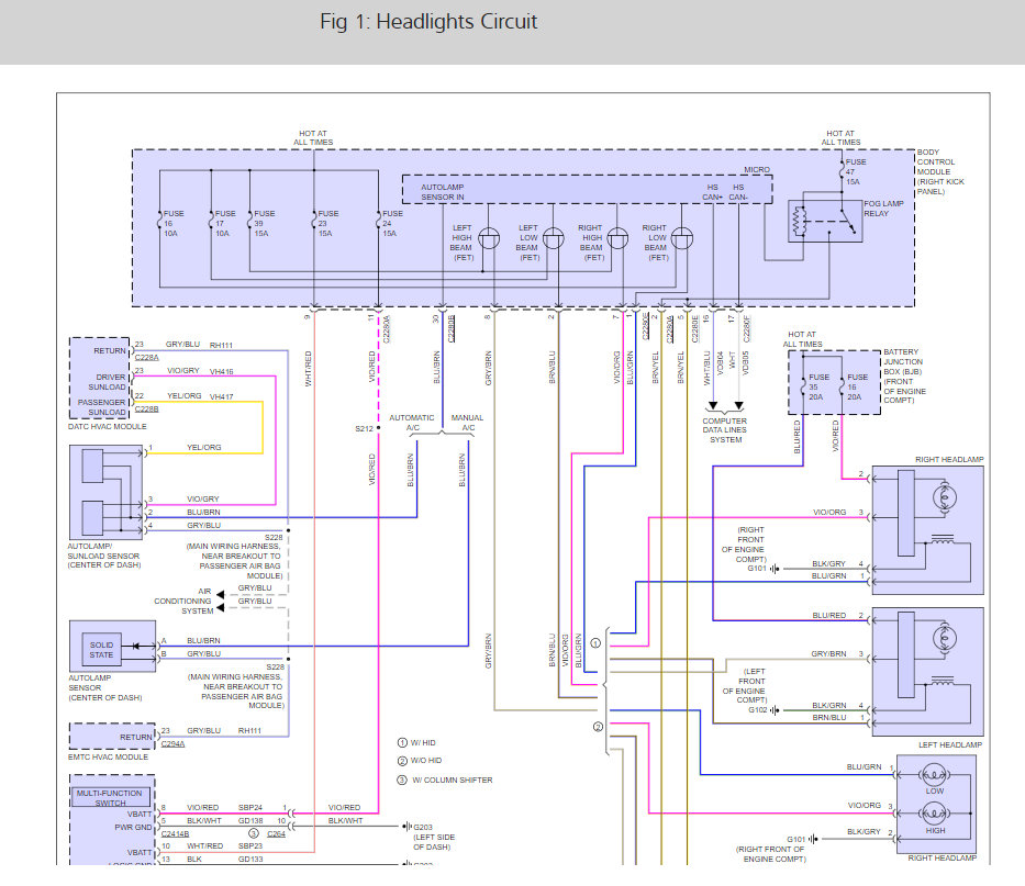

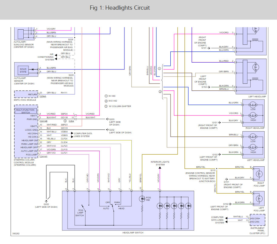

Hi, I have the truck listed above that I had purchased about a year ago. It has the fog lights and daylight sensor. I had a remote start installed. A week later the truck would keep its headlights on no matter what position I put the switch in. The fog lights would not turn on. I've since replaced the switch now three times and they only last a few days before the symptoms happen again. I didn't check relay as I'm not sure where it is located. I had installed verify the remote start wasn't an issue and they said it wasn't. I really am stuck on this one and even though I have a warranty they have very high diagnostic costs at Ford. Thank you for your time. By the way, the lights shut themselves off after twenty minutes. I can tell that I am getting a very weak battery anymore.
Mar 8, 2019 at 10:53 AM
  • 55,224 POSTS

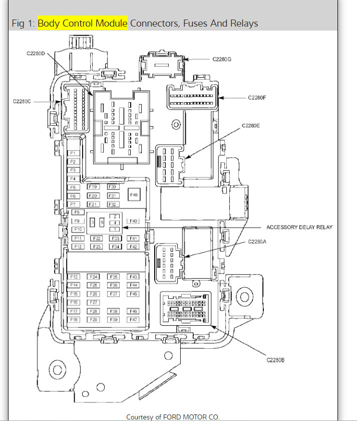

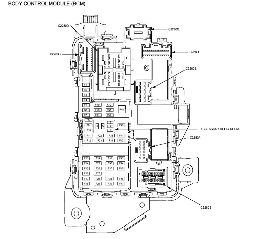

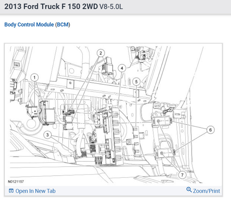

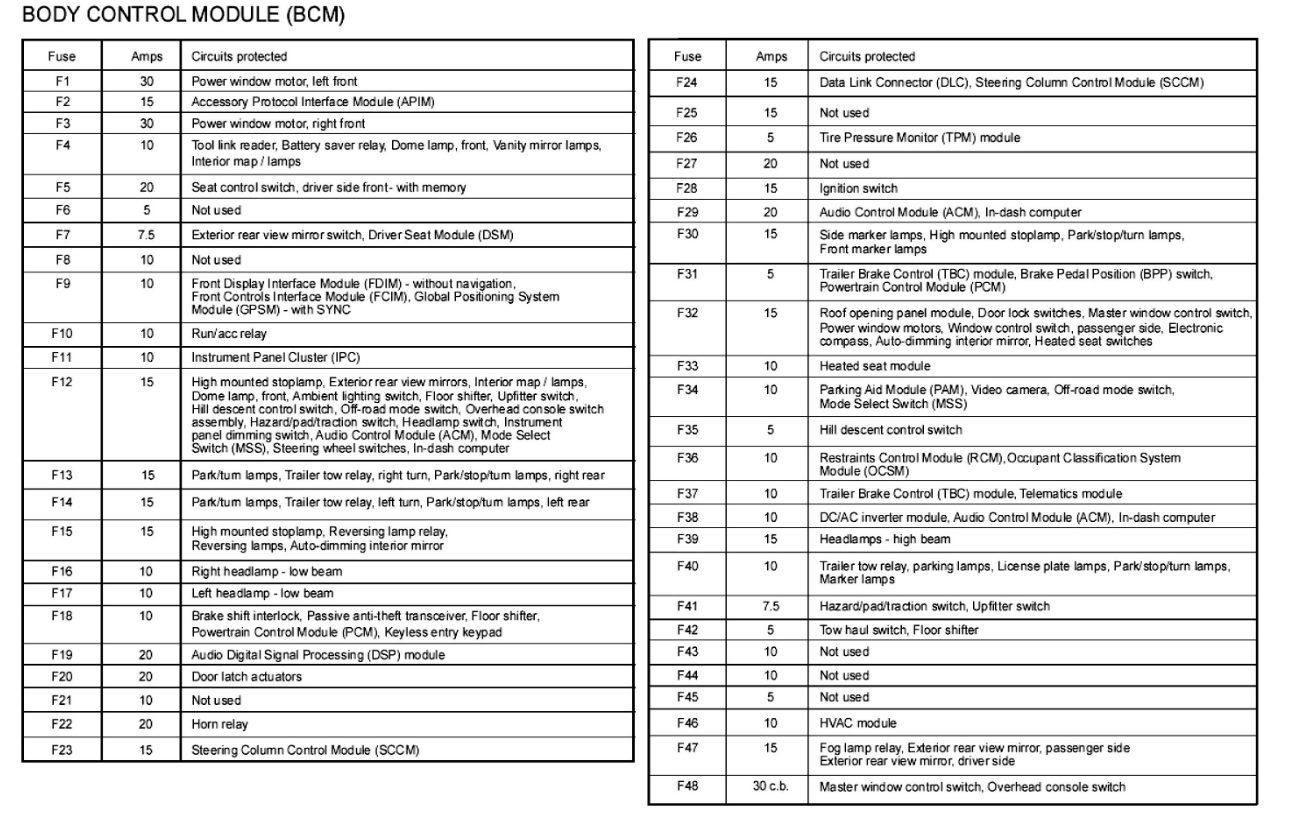

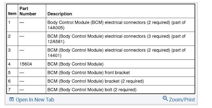

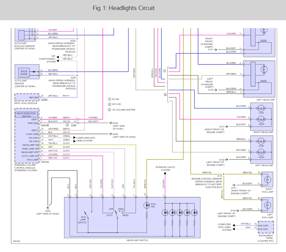

It sounds like the BCM has gone out but to be sure lets check the fuses that run the system, #16, 17, 39, 23 and 24. Here is a guide to help us get started and the wiring diagrams for you to see how the headlight system works and the fuse location and BCM location below.
If the BCM is bad it will need to be programmed in which will run about $130.00.

NOTE: Prior to the replacement of the Body Control Module (BCM) , it is necessary to upload the module configuration information to the appropriate scan tool. This information must be downloaded into the new BCM (Body Control Module) after installation. In the event that As-Built data entry is required (BCM (Body Control Module) will not communicate), all Integrated Keyhead Transmitters (IKTs) devices must be programmed. A minimum of 2 devices are necessary to complete the configuration and turn off the flashing interior lights.

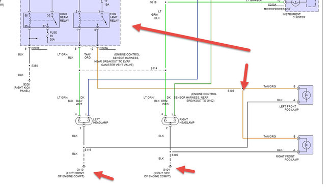

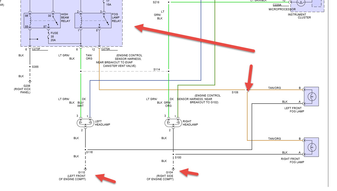

check items in pic like grounds etc. it may be a broken or shorted wire or bad connection at relay, try some dielectric grease on prongs of relay about $2 on counter at auto parts.

This problem could be the switch, can you please re-upload the pic harry? it didn't show up

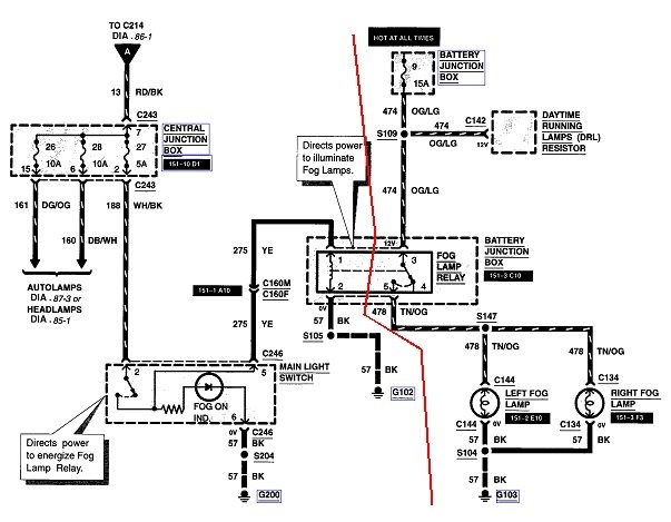

originally I sent a pic that didn't show up the fog lights operate off the same relay etc. you had stated that the one side worked which in the pic both operate off the same relay so it could be a wiring issue like shorting out or partially broken between LH and RH sides. so make sure to check that. the smart box problem I thought was limited to expeditions but not really sure. It is 2003-06 that have that problem and it's normally the fuel pump circuit that screws up, not the lights. so check the wiring in the pic as it may have a problem there it is the same color on both sides. also check the grounds as they are separate and could be the problem for one light.

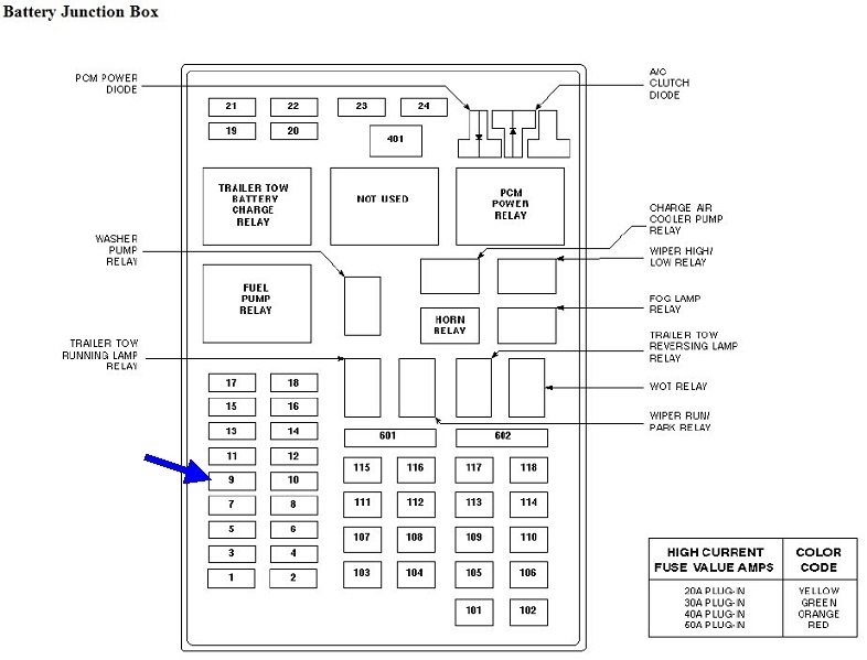

My fog lights aren't working on my F 150. I changed the bulbs, check the fuse and relay and the wiring into the receptacle, everything looks good. Indicator lamp in light switch for fog light glows, relay clicks when I turn on lamps, but no light
Dec 26, 2020 at 2:18 AM (Merged)
CARADIODOC
  • 34,367 POSTS

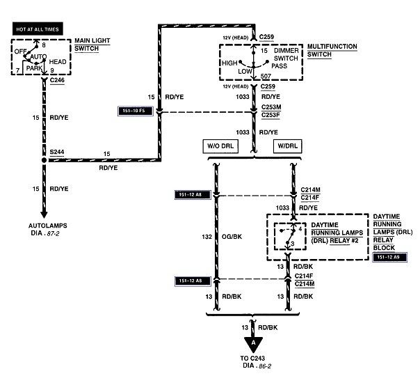

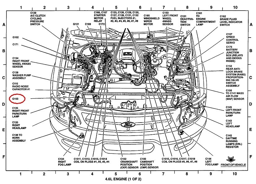

Your dandy observation that the relay clicks proves everything in the first diagram and everything left of the red line in the second diagram is working. That leaves very little. The tan / orange wire, circuit 478, is in common with both lights, but the better suspect would be a corroded ground, G103.
The third drawing is for the 4.6L engine, but G103 is listed as, "right front radiator support" for all engines.

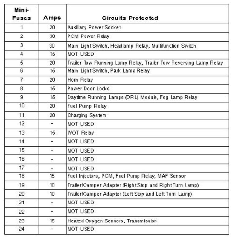

If the ground looks okay, turn the fog lights on, then take voltage readings at one of the bulb sockets. One must have 12 volts. If it's missing, check fuse 9 in the under-hood fuse box.
