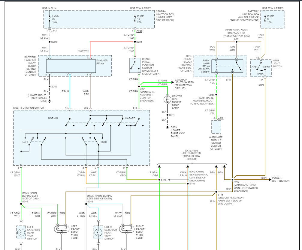

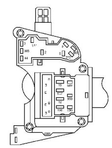

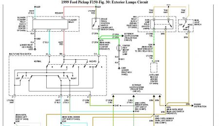

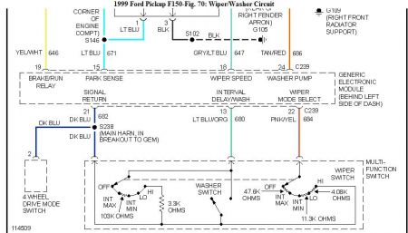

where can I find a wire diagram that lets me know where exactly the wires need to go on a multifunction switch on the steering wheel. I repaired a wire and the rest of the wires came out of the male plug and I do not know where they go..

MULTIFUNCTION SWITCH TESTING Switch Position....Between Terminals No.(1) ...Ohms Wiper Switch Off........................589 & 993....................47,600 Intermittent...........589 & 993....................11,330 Low......................589 & 993......................4080 High......................589 & 993.......................0-4 Intermittent Wipers Intermittent & Off...590 & 993.......................(2) Low & High.............590 & 993....................3300 Washer Switch Off.........................590 & 993..................103,300 On.........................590 & 993....................0-4 Hazard Switch On......2, 3, 5, 9 & 385............0-4 Left Turn Signal On....3, 9 & 44.....................0-4 Right Turn Signal On....2, 5 & 44...................0-4 High Beam On.............12 & 15.....................0-4 Low Beam On.............15 & 507...................0-4 Flash-To-Pass On...........12 & 196..................0-4 (1)Specification can vary by as much as 10 percent. (2)Rotate control from maximum delay to minimum delay. Resistance should gradually decrease from approximately 103 k/ohms to 3.3 ohms.
https://images.2carpros.com/forum/automotive_pictures/266999_multi_1.jpg
Check out the images (Below). Please let us know what you find.

This is great information but I am not testing the wires. I need to find out what colored wires go where. If you can tell me where to go, my Super Bowl sunday will be saved!!!!!!!!!!!!!!!

let me know if you need any more .. we can't miss the superbowl .. lol ..
https://images.2carpros.com/forum/automotive_pictures/266999_multi_2.jpg
https://images.2carpros.com/forum/automotive_pictures/266999_multi2_1.jpg
Jan 30, 2009 at 10:23 PM
E777RODRIGUEZ
  • 8 POSTS

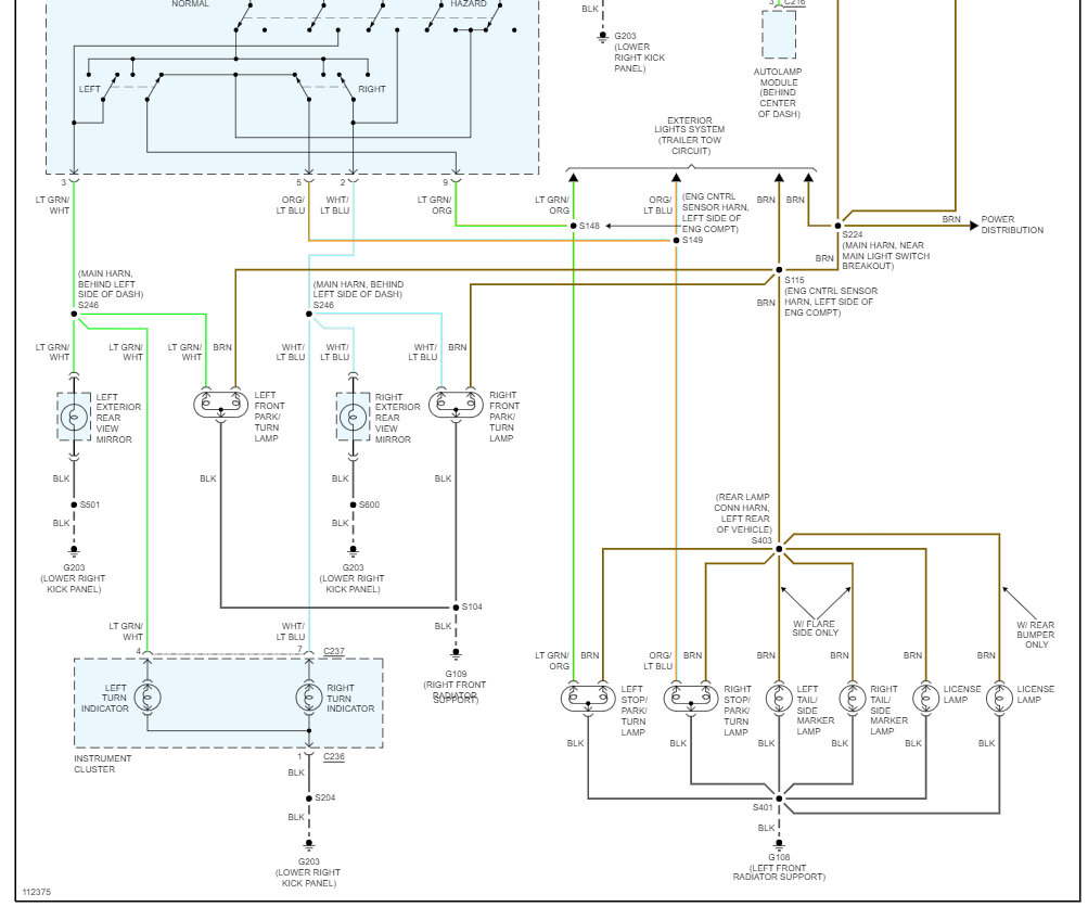

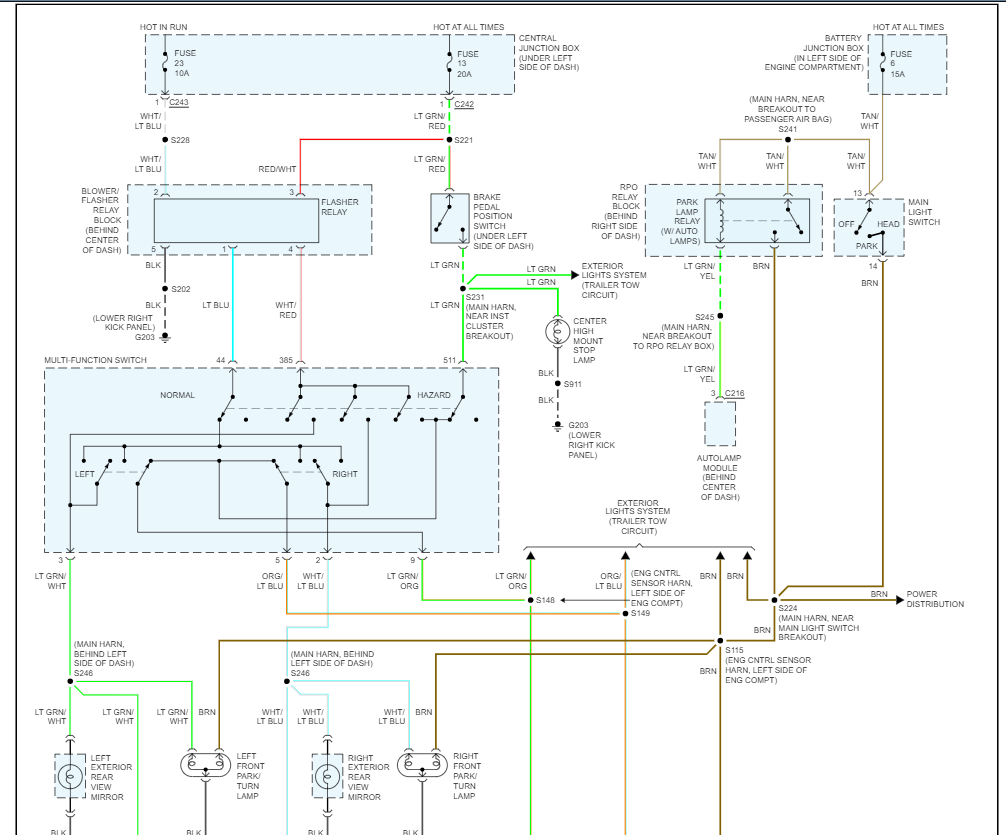

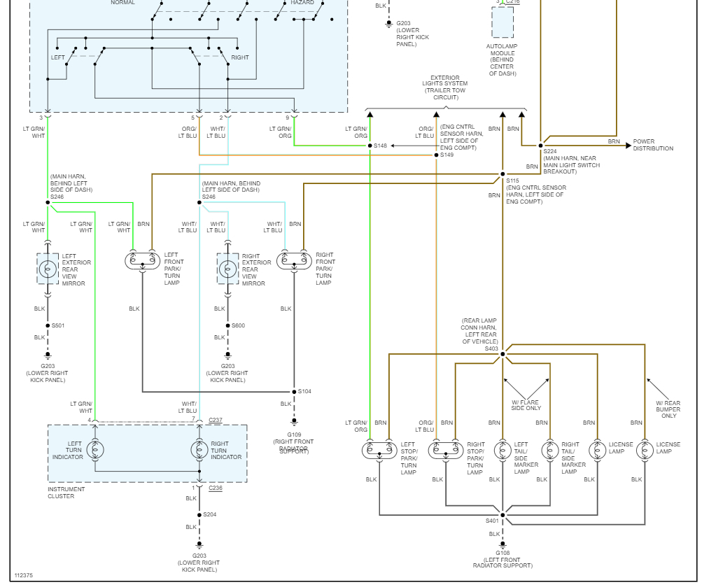

Thank you very much for your efforts. I can not see the diagram very well but I finally found a schematic for a 1999 Ford F-150 and I finally got my lights working good. Except, the treuck will not start now.
