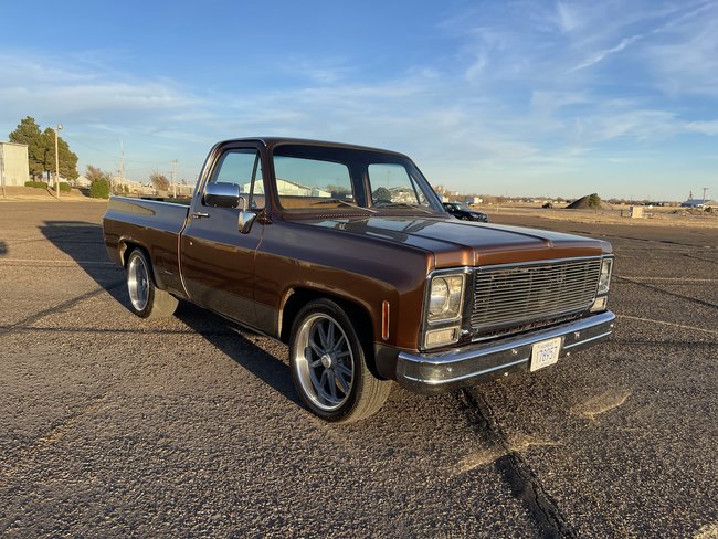

I have the truck listed above square body. After about 10 minutes of driving the headlights turn off on low beam. After about 10 minutes or so they turn back on. I know there is a short somewhere. Any idea where to start? Thank you
