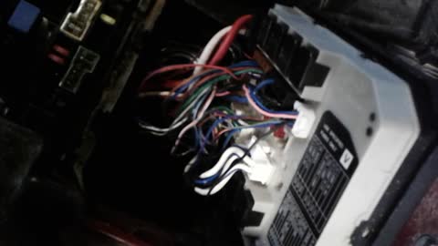

Driving down road headlights flickered nothing else. Next morning turn key on to start won't start headlight come on with out switch turned on wipers going with out switch on. Cycle key on off multiple times finally starts but unable to control lights. And wipers doing nothing at all now. Turn off turn on may start may not headlights always on wipers sometimes going. Nothing consistent other than headlight other things random. Door lock not working but not sure it worked before it's my mom's car.
Checked all fuses. Battery good. Took cover off column nothing looks loose.
I did also take out BCM nothing looks hot or cracked. Please help I've Googled and Googled

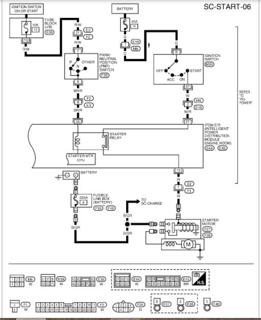

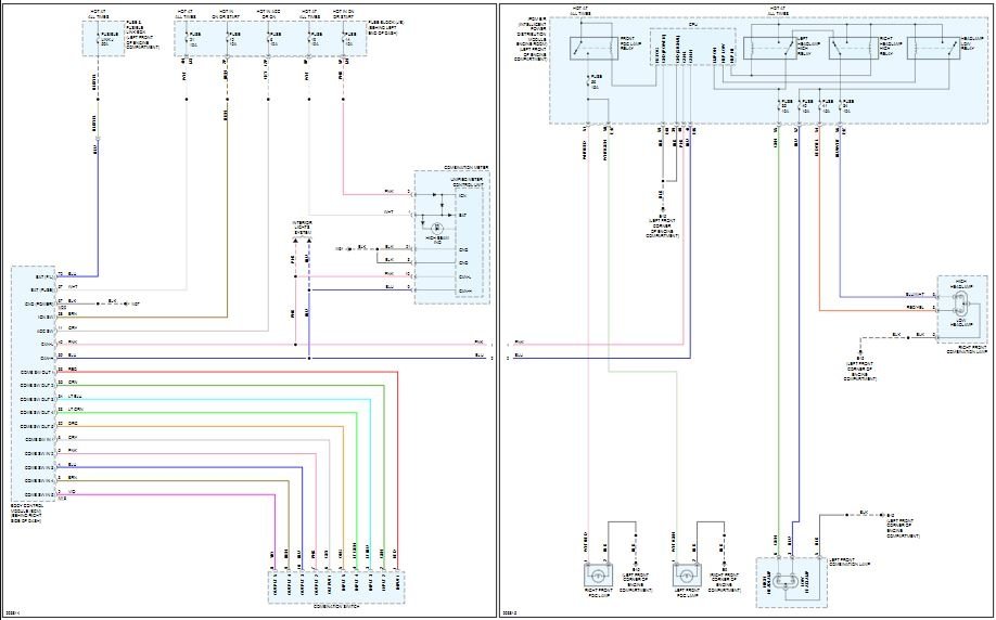

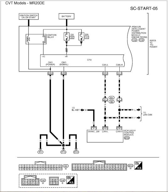

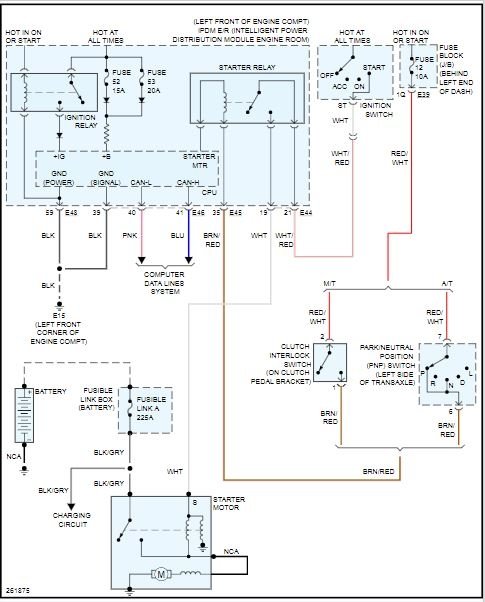

Hi Crystal,
It's a start going off the info I have so far give it a review, I'm sure you will have more questions on it just let me know and we will go through it.
I have put together the diagrams of both the starting and the headlight systems in your car, 2.0l the 2.5l should be the same for these systems. If you have a test light this will be of some help. Note one of the main grounds is located at the left kick panel area be sure to check that out.
Tom

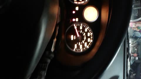

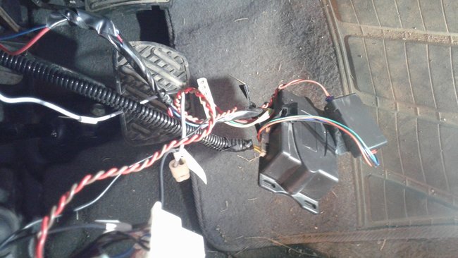

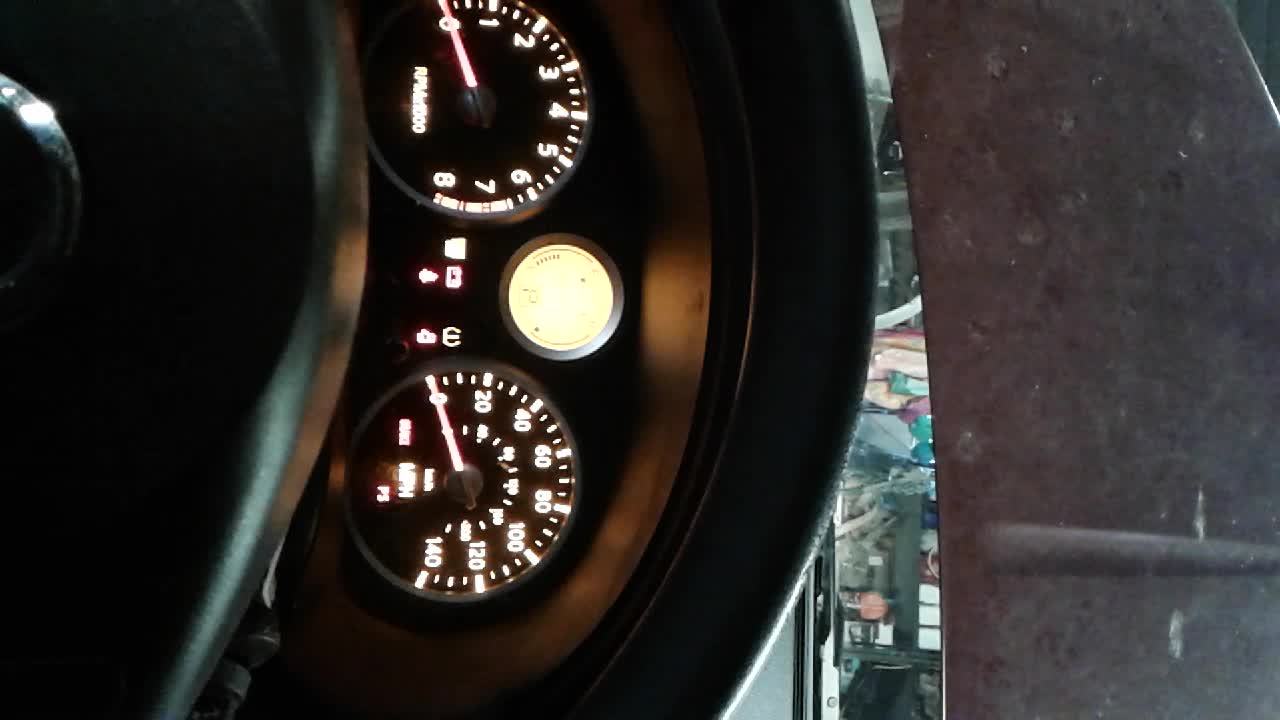

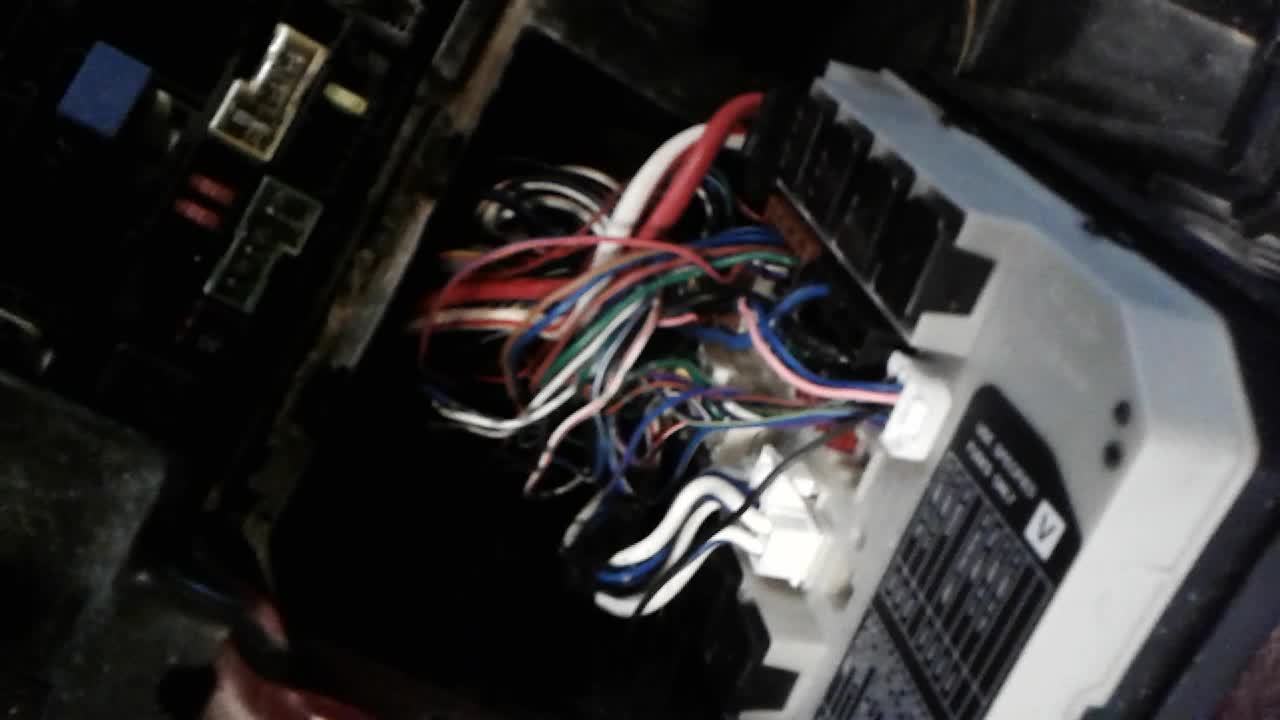

I tried to attach a couple of videos. I did the battery cable test again. Still no change. The wipers did come on by themselves for a couple seconds.

That first still shot doesn't look like OEM. Is that just because it just not mounted secure like the factory does it and it is original? We must be over looking something. The three main things that would cause this is would be; the the whole switch arm, low voltage or the CAN system.On newer cars even slightly low voltage will confuse the computer. The most common is the switch arm being the piece with all the daily movement. Were these problems occurring on your Mom? Knowing what happened the very first time the symptoms occurred is helpful too. My feeling is that it's the switch arm, getting to the plug connection of it with a test light you should be able to check its outputs using the diagrams posted earlier.

The cruise control, I stated at first it is after market that was installed by previous owner. Everything is a little dangling from me trying to check stuff.
The problem happen simultaneously. If the key is on the light come on (and shouldn't) low beam, unable to brighten or turn off. Wipers might come on with key, might not (just seem possessed) no rhyme or reason to them. Unable to control with stalk. Sometimes when lights or wipers come on the stalks will let me turn them off but not back on or function.
Starting maybe maybe not. I have noticed if I just turn the key to the on leave it for like a minute it is more likely to start. But still unable to control stuff.
I've also noticed if turn the key on the cooling fan comes on, not sure if that's a normal function.
I really appreciate your help. I am going to chase ground wires today. I have a back disability so things take me a touch longer. I'm better at answering specific questions.

Sounds good but having a back issue, do please be careful getting under the dash can be hard on the back.one way to isolate which circuit is acting up is to remove the fuse to one of them and see if the car starts better. Seeing that both the wipers and the headlights are effected by this try removing the wiper fuse it should have nothing to do with the starting circuit the check to see if the car starts the way it should. Then do the same with the headlight fuses. The same test can be done to see if its the signal arm, for that, if you can get at the plug to the arm unplug it and see if the car will start normally. All these circuits if not powered up should have no effect on the starting of the car. The car should start fine without them hooked up. Once we isolate which one is effecting the starting of the car we an figure out why and if it is in fact the CAN buss causing the issue.
