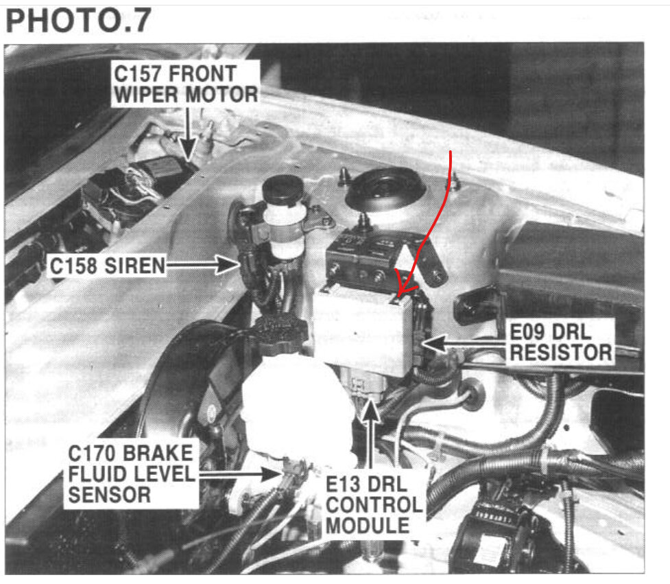

I have seen the DRL control unit go out and turn the headlights on randomly. Here is the location of the DRL controller so you can swap it out, this should fix the problem. Check out the images (below). Let us know what you find.

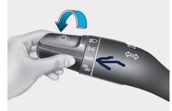

Your car has the automatic headlight option correct? When you do not need to turn on the switch for the lights to come on? Do they turn on anytime day or night or is it only when the car is setting in a dark area? My thought is that the light module is not shutting off when you shut off the car. If the lights only turn on when it is darker out that gives a place to start on the wiring diagram. When you turn them off how are you doing that? Just turning the switch to off?

It is not labeled “auto”. I was leaving in the on position and when I lock the car with the fob they turn off. No, the issue is mostly in broad daylight.

Okay, so you do not have the auto position like the image shows? Yours has Off, then DRL, then the parking lights and headlights as the last position, correct. You are leaving the switch in the DRL position?
Then you shut off the engine, lock the doors and the lights go off after fifteen seconds or so, correct.

Looking at the wiring and the control system it looks like the only real failure item would be in the intelligent fuse panel or the body control module. As those control the lights and the DRLs.
There are a couple options. The cheapest would be to just turn the switch to off every time. The other would be to visit a dealer and have them use a scan tool to check the way the two modules are reading the inputs from the switch and the engine computer. You description sounds like the doors lock and the body controller reacts and turns off the lights but then a later signal is telling them to activate.
