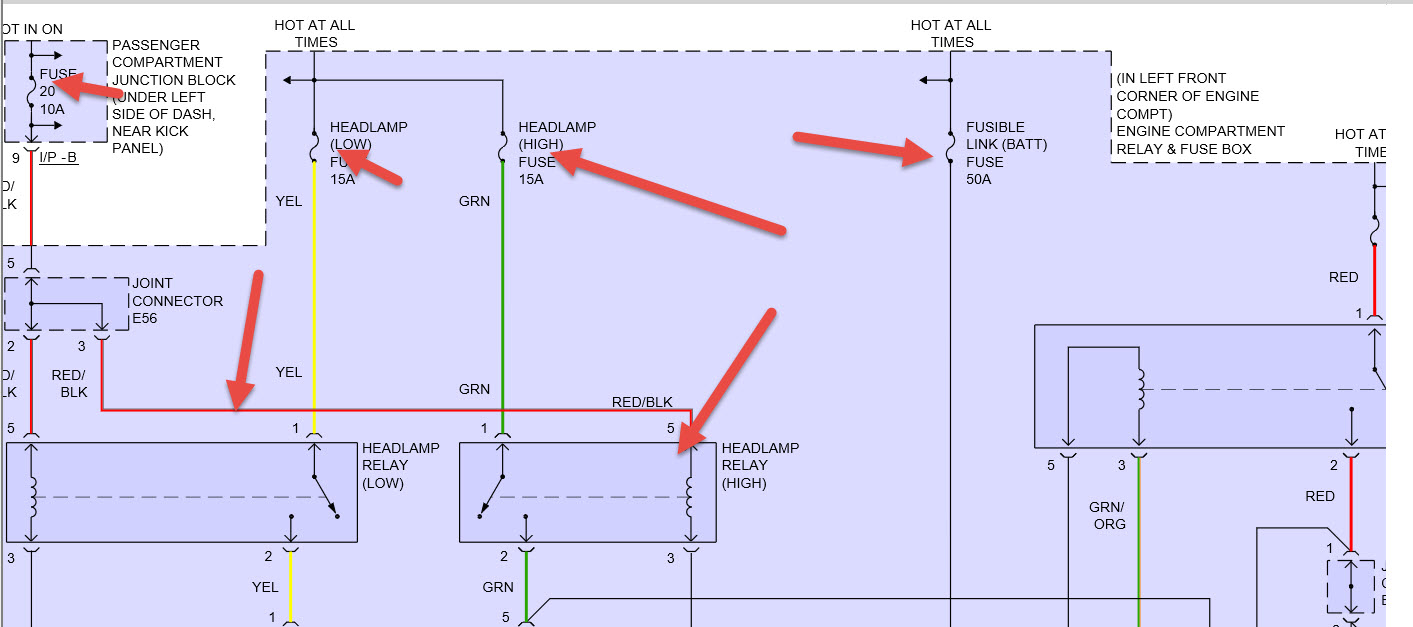

I drive a 2004 Hyundai Elantra and recently my headlights went out and so did my high beams, but my lights inside still work and so do my blinkers, but I am not sure what to do because I bought brand new light bulbs and they turned on but then turned off again and they all go out at the same time. So, I am not sure what the problem could be.

Check items in picture and try dielectric grease on relay prongs. Maybe the multi function switch. picture for manual headlights with no DRL and not auto lam.p

Ok so would it be something with wires?

dont' think so try what I said in reply first

Sorry I'm not good at cars haha so I just apply the dielectric grease on the prongs and if that doesn't work it might be my multi function switch ?
