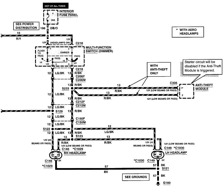

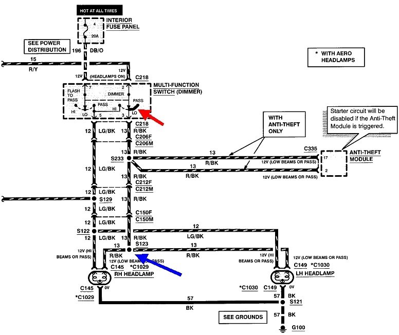

When I turn on the headlights, the low beams don't work. High beam and all other lights work. I found online tips suggesting a bad multi-function switch or a circuit 13 fault. Where do I find circuit 13?

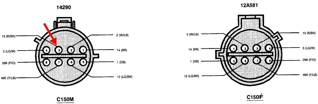

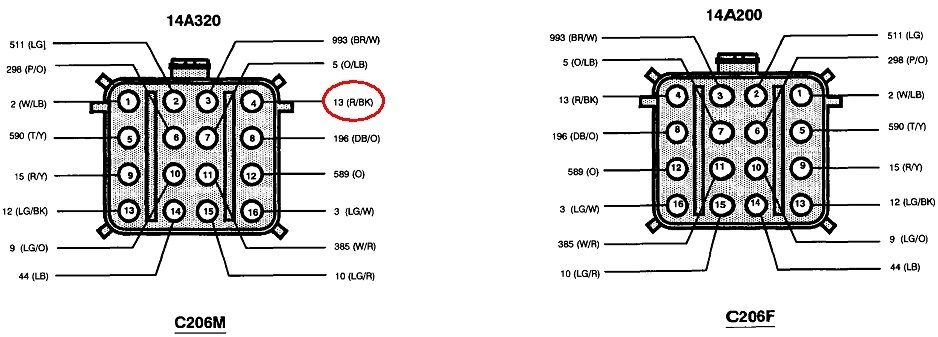

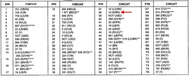

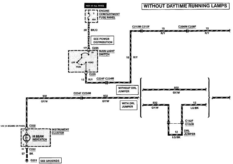

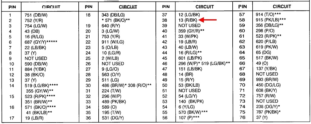

These first two diagrams are for the head light system. The third one is just the second one but I added two arrows. There has to be a break between them. That's circuit 13.
There could be a burned contact inside the multi-function switch, right by the red arrow, but part of that is also used for the high beams. Since the high beams are okay, a burned contact is well down on the list of suspects. A better place to look is right below the red arrow in the switch's connector. Look at the terminal for the red / black wire and the corresponding terminal on the switch. If those are burned, discolored, or the connector body is melted, the switch will have to be replaced, and at least that one terminal will have to be cut out and replaced individually. I can describe in more detail how to do that.
Next is connector C206, then splice S233, connector C212, connector C150, and finally, splice S123 by the blue arrow. All of those a dandy places to find corrosion. The cause of this problem can't be after the last splice because anything there would affect just one of the low beams. The wire between the two arrows is the only thing both low beams have in common.

So it's a direct connect (i.e. no relay) from the multi-function switch to the low beam? That should make troubleshooting easier.
Can you suggest where on the vehicle I can find S123? I assume it would be pretty close to the headlights. Probably near the left headlight?

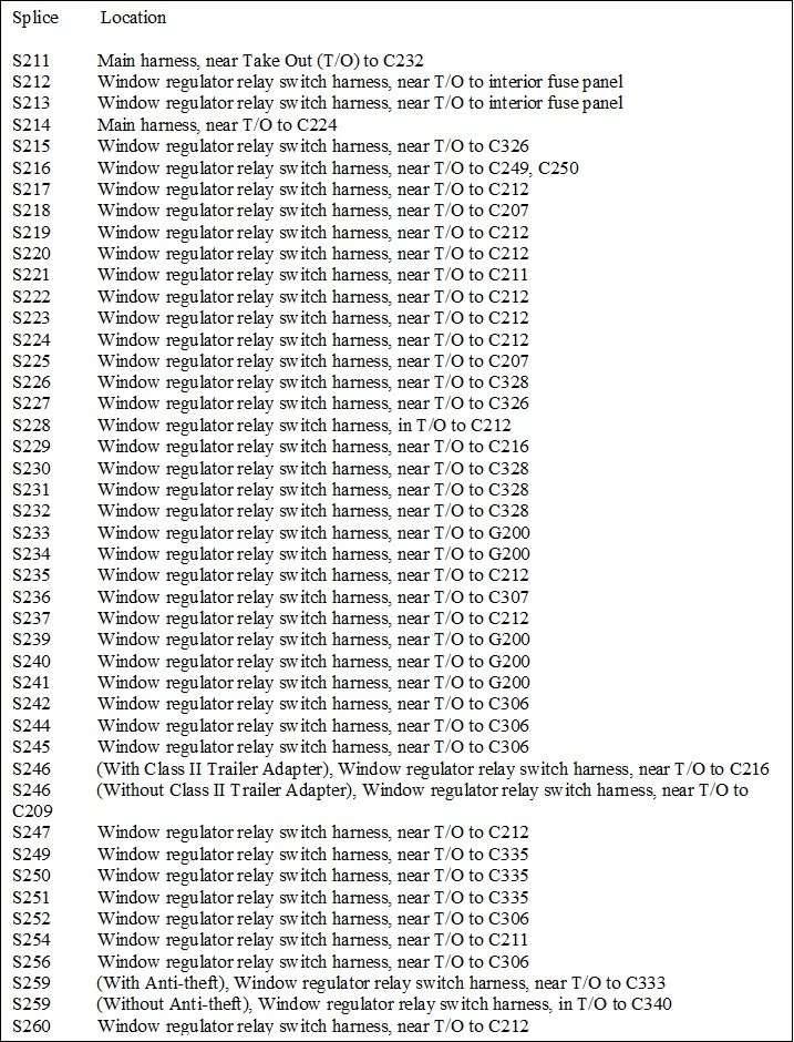

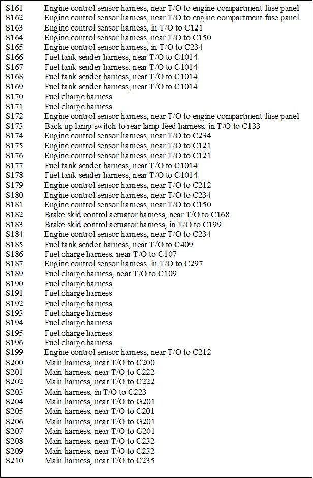

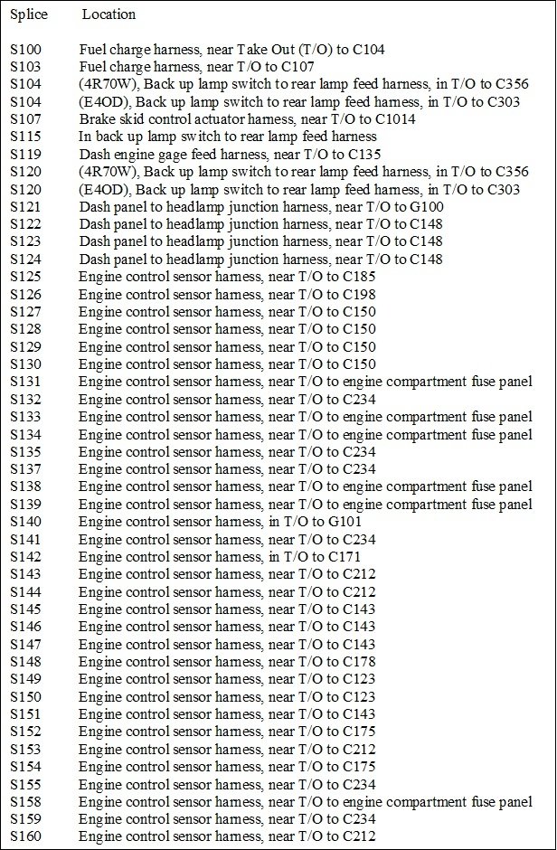

There's no drawing but I did find a listing of splice locations. I'm going to assemble the lists into a form I can post here for you.
Jan 9, 2020 at 9:58 AM
CARADIODOC
  • 34,381 POSTS

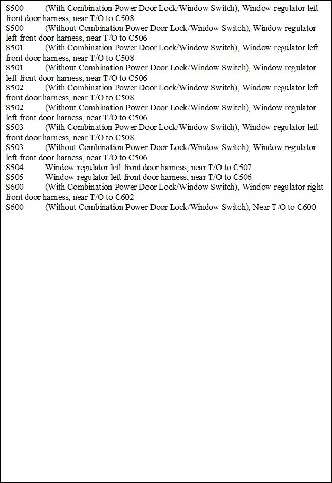

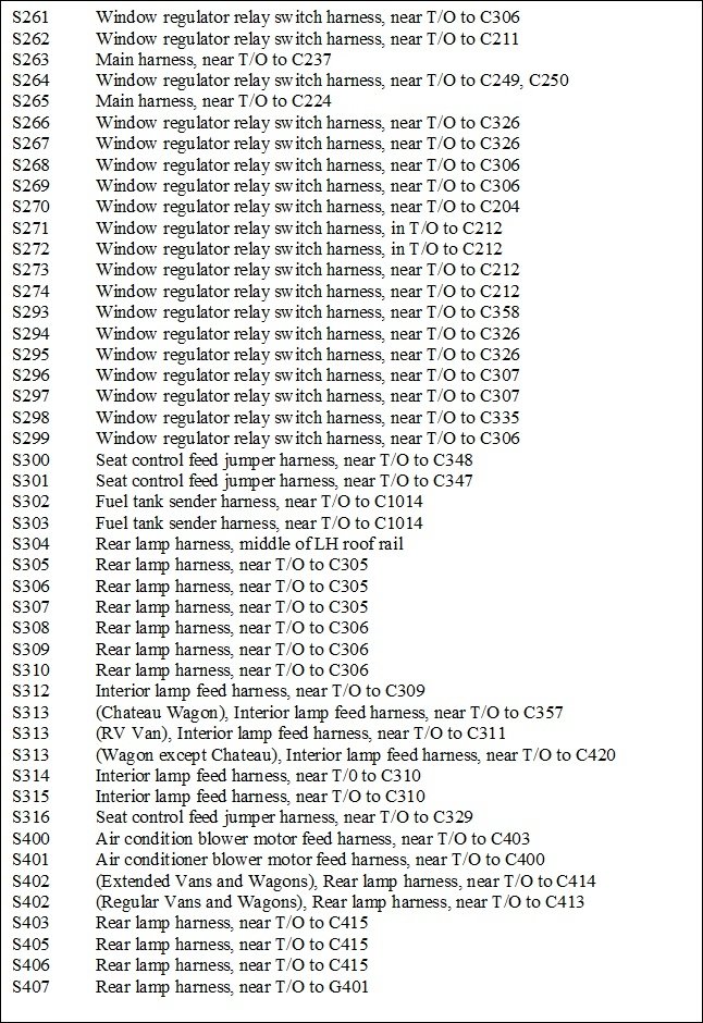

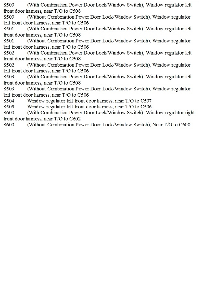

I'm still looking for a drawing, but here's the list of splice locations:
Jan 10, 2020 at 4:47 AM

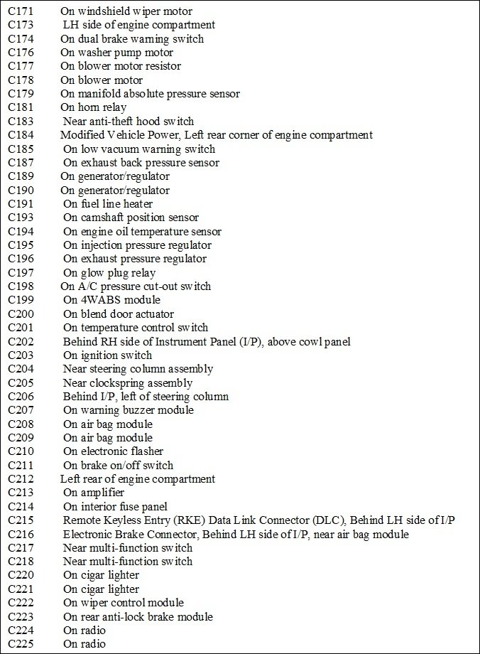

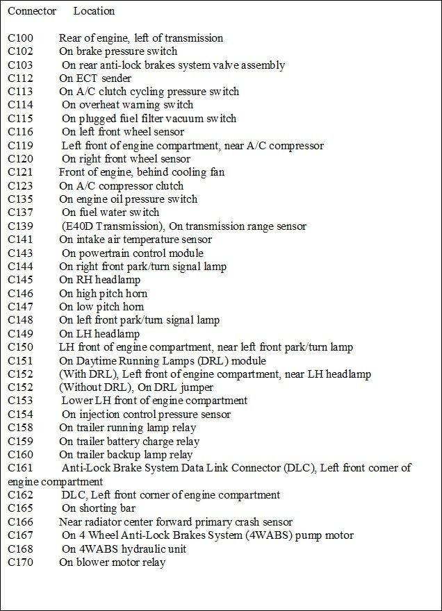

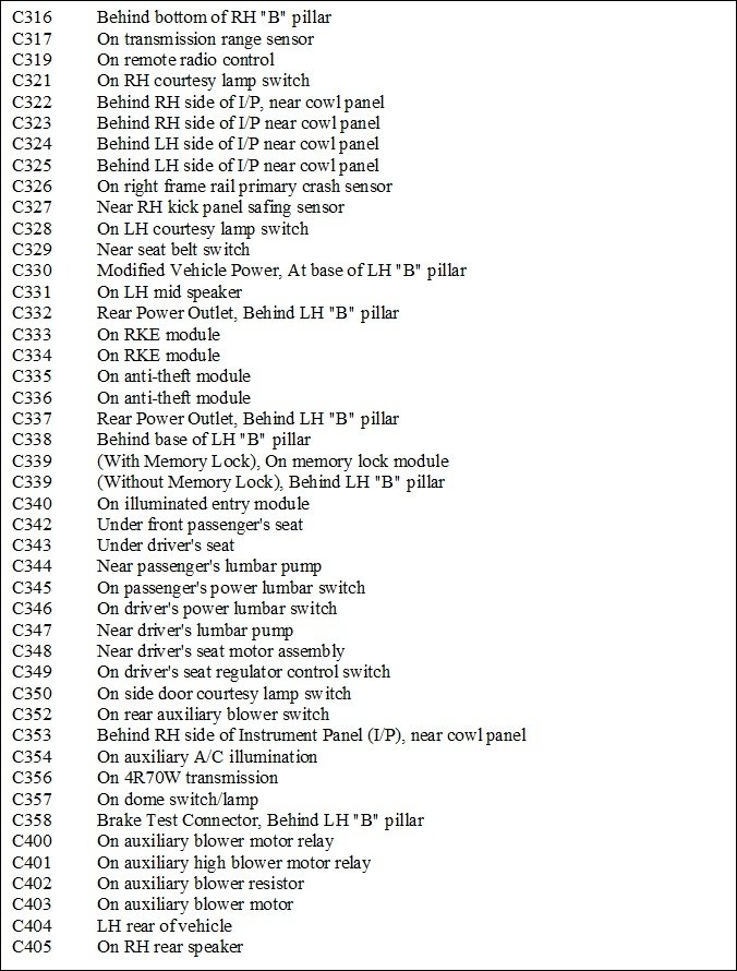

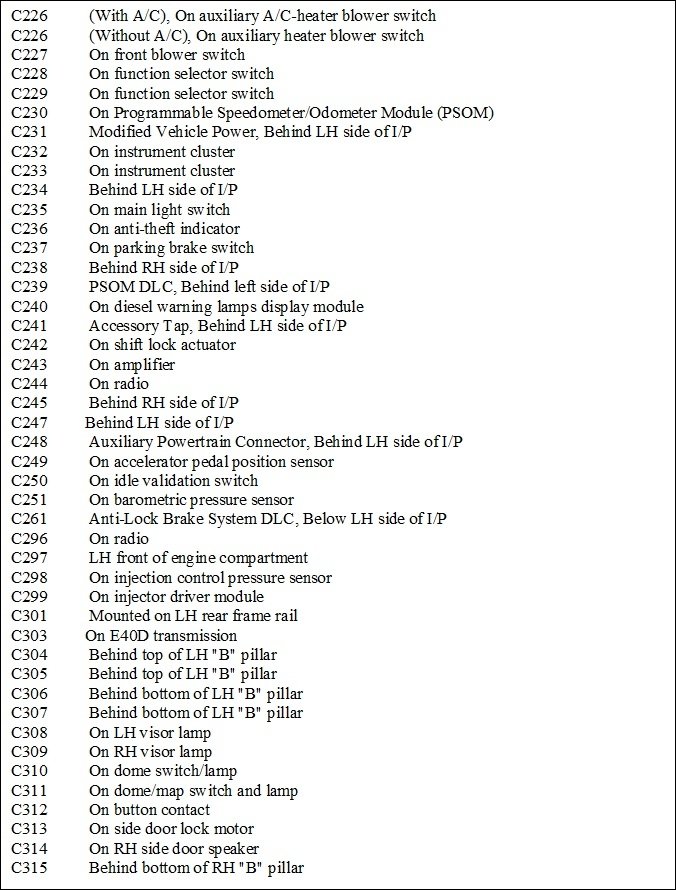

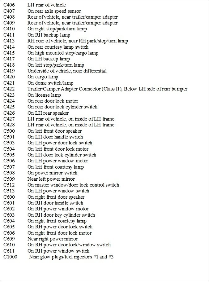

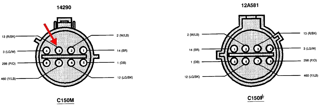

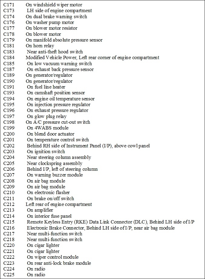

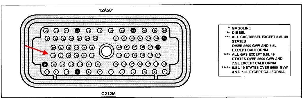

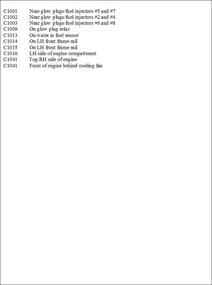

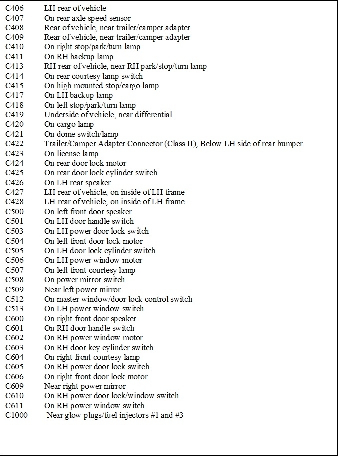

Hey, look what I found. This is a list of connector locations. The last four drawings show the three connectors, in order.

Excellent information! Thanks for your effort to bring it together. I pulled out the multi-function switch today and it looks good. The red/black wire from there was open (I would expect some resistance from the bulbs). The wiring under the dash looked okay as best I can tell. I'll dig under the hood tomorrow and update with what I find. Thanks again!
