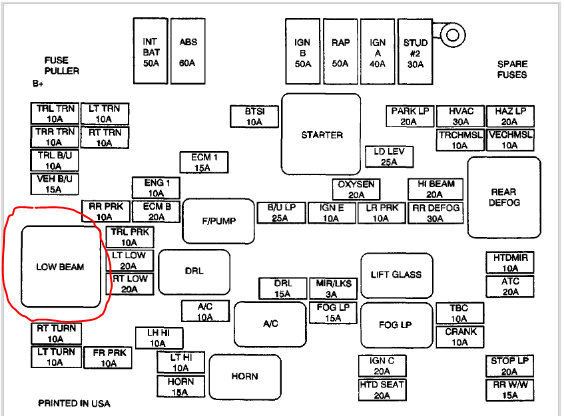

My SUV has HID lighting. Both are burnt out. any suggestions?

This is not an after market HID. It’s factory installed. It was available on the 2000 GMC Envoy as an option.

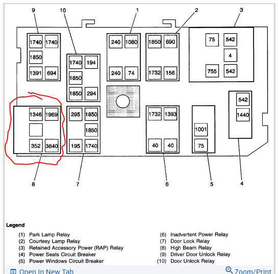

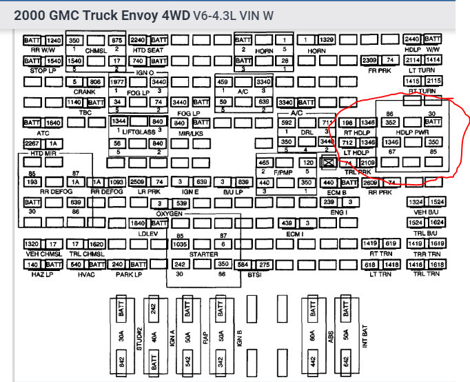

Oh Okay, I've attached a few pictures below of the high beam, low beam, and headlight relays including their location. I've circled them in red.. Have you checked these to see if they are good/burned out? Here is another tutorial on how to test relays:
Let me know the outcome of you checking these. I can also provide you with a headlight wiring diagram if needed.Hope this helps and thanks again for using 2CarPros.
