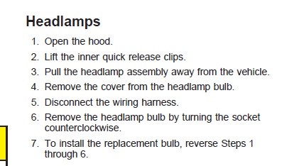

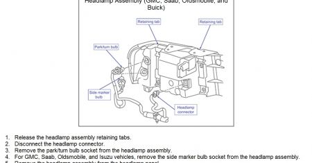

I can't figure out how to get into the headlight asslembly to replace a headlight bulb. Thanks

I don't know if this will help or not?
https://www.2carpros.com/forum/automotive_pictures/170934_envoy_headlamp_1_1.jpg
https://www.2carpros.com/forum/automotive_pictures/170934_envoy_headlamp_2_1.jpg
