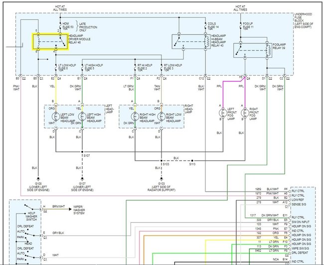

The low beams quit working. High beams work fine, but when you switch to low beams they just shut off. park lights and fog lights are still on though.
May 10, 2010 at 4:09 AM
HMAC300
  • 48,601 POSTS
check the relay and fuse under the fuse panel under hood. it'a s big rectangular thing you'll see it. it should be marked what is what on the inside top.
Read the guide below on testing relays

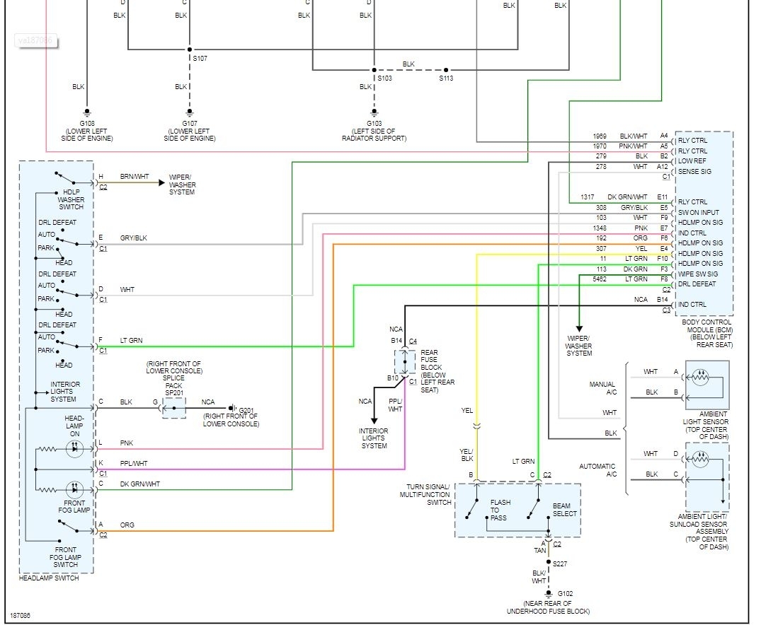

Attached below ore the wiring diagrams for you headlights, the low beam relay is highlighted n yellow

Bad connections, corrosion, or a bad switch are all suspects. Where the sockets corroded when you changed the bulbs? Since both lights are out I would test the switch to make sure it is working. Look for any loose connections.

Next, I show fuses 3 and 6 are 10amp for the low beams and fuses 5 and 2 are 10 amp for the high. You did check them with an ohm meter and they are good……….
Next, I also see Relay number 46 is a relay for the low beams. Have you checked that?
Nov 17, 2018 at 1:34 AM (Merged)
XPRBILL
replaced relay 46 with 45 (not needed) works perfectly!!!!!!!

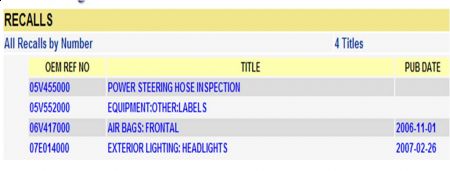

Hello - Hey one other thing while I have you on the line............. Also, it looks like you may have some recalls on your vehicle. The dealer may fix these for free. Please contact the dealer service department, give them the VIN number of your car and have them check on these to see if they apply to you.

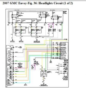

ther are fuses a nd relays for the headlights in your underhood fuse box. there are 4 fuses and 2 relays . As this happens occasionally i would try those things first before saying it is a switch. especially since you say they eventually come back on. you can do this yourself just by replacing the parts. You should be able to get them at an auto parts store. they will be marked in your underhood fusebox where they are when you look on the cover after it's off. I'llinclude a headlight diagram picture that you should be able to enlarge.
https://images.2carpros.com/forum/automotive_pictures/406719_envoy_headlight_1.jpg
