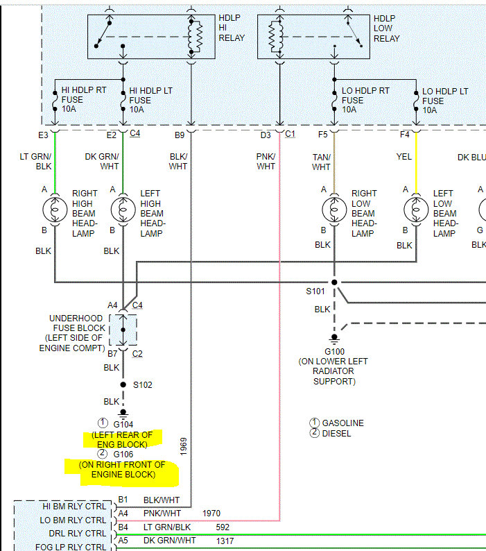

Left low beam and both high beams dim with low beam selected
2006 CHEVROLET SILVERADO
129,000 MILES • 6.6L • V8 • 4WD • AUTOMATIC
FIXJET
Truck listed above is a Duramax.
Right low beam normal.
Selecting high beam or moving headlight switch from auto to "on" will bump the starter.
Instrument panel lights on always.
Truck will start but if you remove the left low beam bulb, no starter engagement.
BMC programmed to my VIN made no difference.

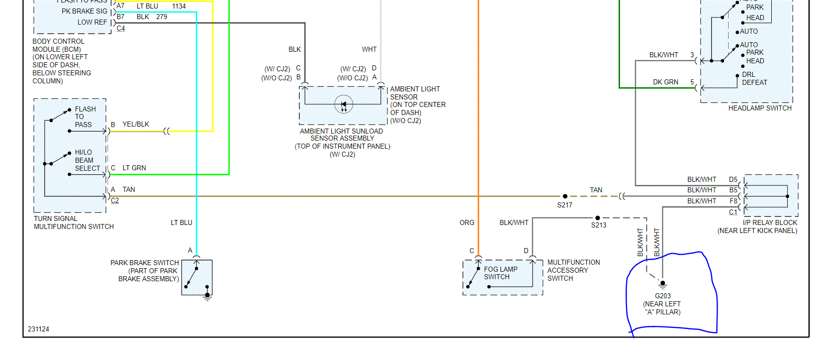

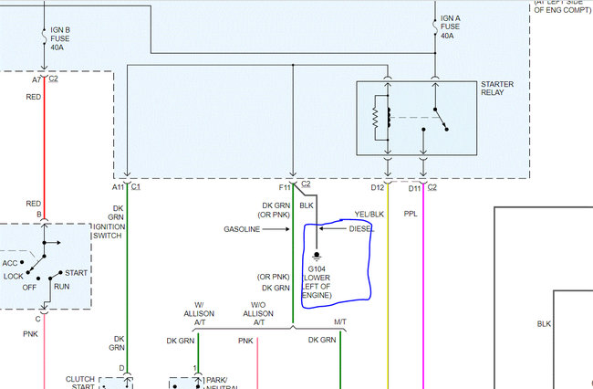

I spent some time going through wiring schematics and was only able to find one correlation between the two components. There is one ground that seems like it could be related. I attached three pics below. The first two show grounding locations for the lighting. Pic 3 shows a ground location for the starter relay. (ground 104 lower left of the engine) If you notice, that is the same ground used by the left headlamp seen in pic 1. Do me a favor. Check the condition of that ground. I have a feeling (and this is a theory) that when the light is in, somehow the power is back feeding and causing the quick engagement. That is where I would start checking simply because of the correlation between the two components.
I have to be honest, the grounds on these vehicles are somewhat poorly designed. When checking it, confirm that it is in good condition. Move it around to see if the connector isn't half broken. Also, make sure there are no corrosion issues.

So the issue has been resolved. I attacked all the grounds on the engine block, G104 and the others. Replaced about 1 foot of G104 wire as it was corroded. Cleaned up the block connection points and ground leads, added star washers and dielectric grease. Along with replacing the battery leads which were showing some corrosion migration up from the terminal ends. Also cleaned up the positive leads to the fuse box as they were looking bad at the Mega fuse connections. So not positive which ground was the issue as I went after them all, but most likely it was G104 like you said. Thanks again Joe for your insight.
