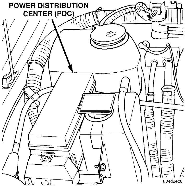

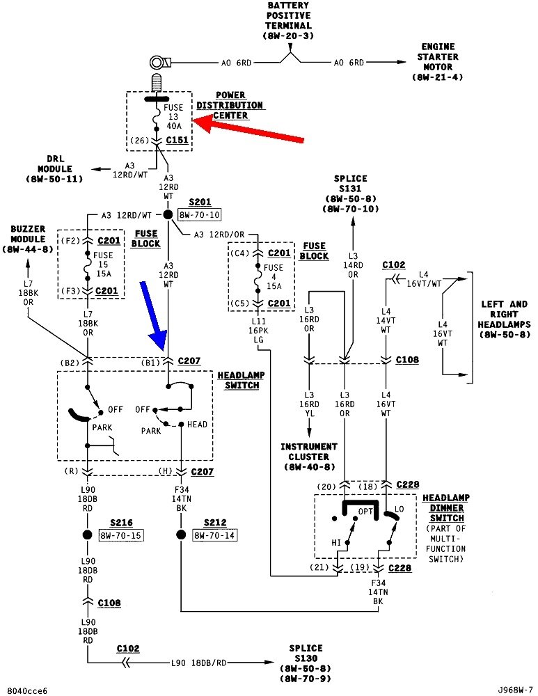

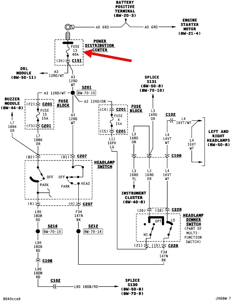

Start by checking fuse # 13 in the Power Distribution Center. That's the fuse box under the hood. Fuses like this have two test points on top so you don't have to pull the fuse out or try to visually inspect it. You must find 12 volts on both test points. If it's missing on one of them, that fuse is blown.

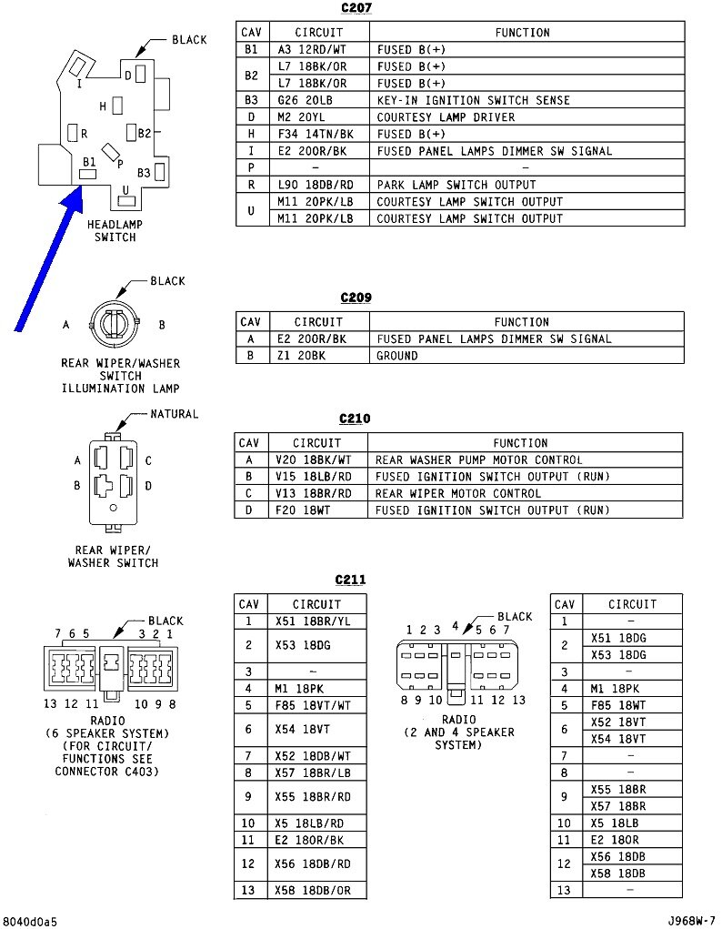

Assuming you do find 12 volts on both fuse test points, check for 12 volts on the headlight switch, terminal "B1". That will be a red wire with a white stripe, (tracer). Back-probe through the back of the connector body, right alongside that wire to take the reading. If the test light is bright, or normal, there's no need to measure the exact voltage, but you can if you want to. It should have the same voltage that you found at the fuse.
