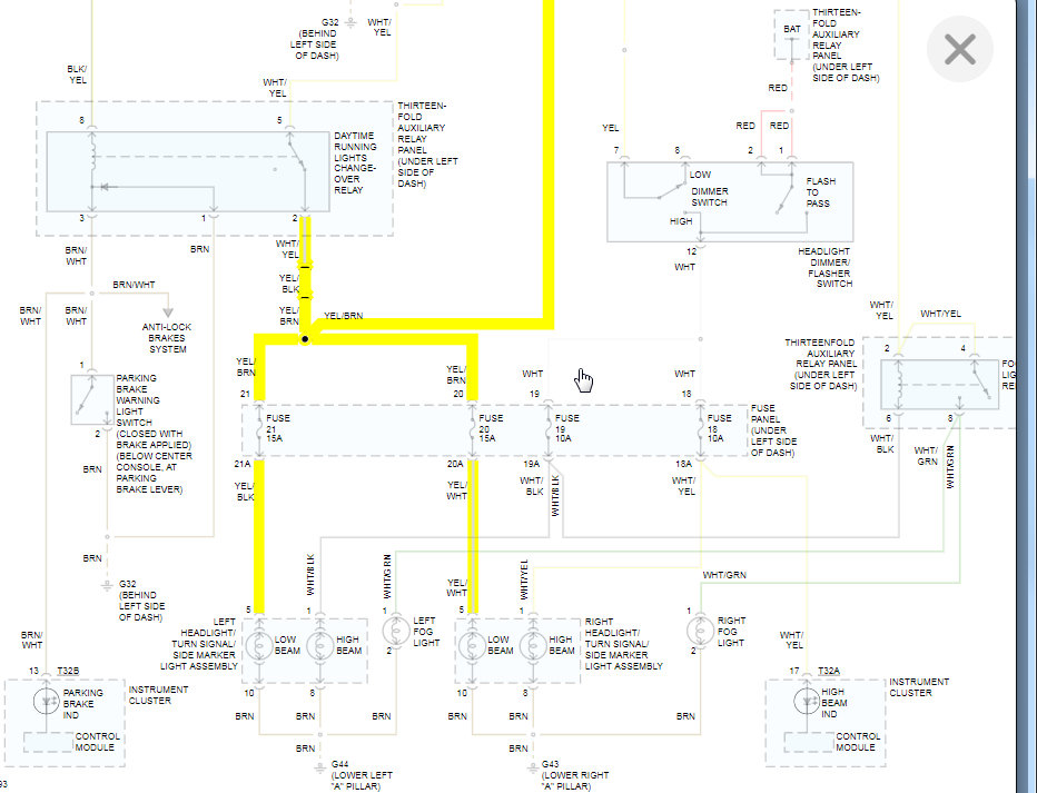

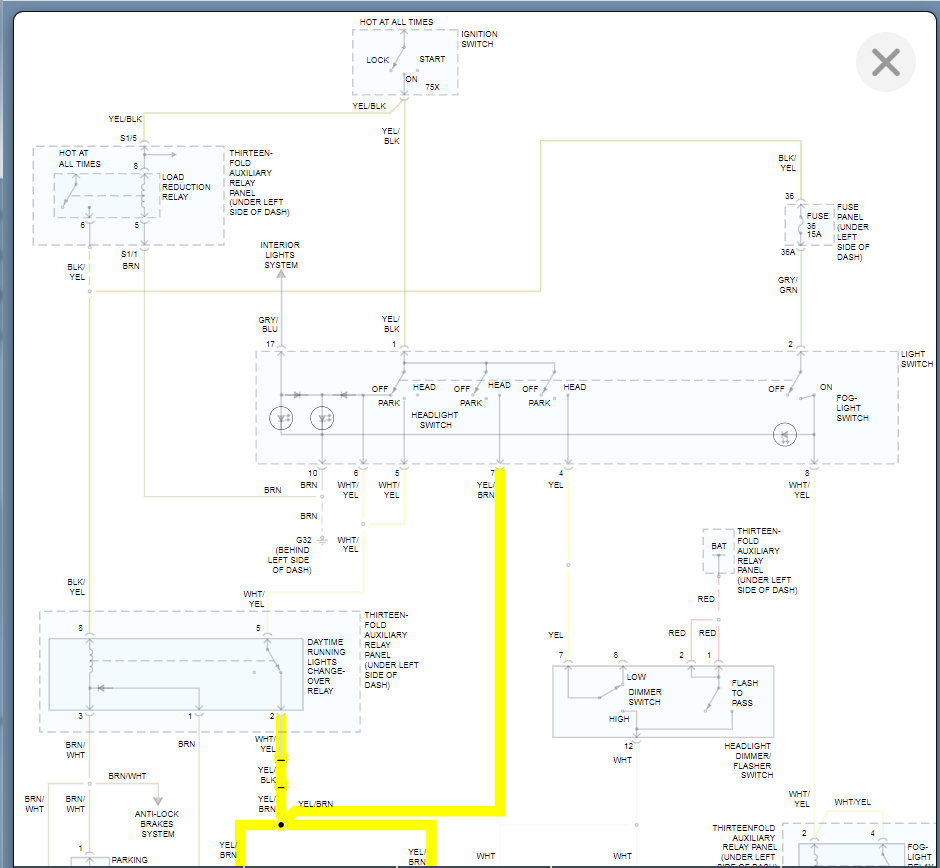

Headlights and turn signals not working
2003 VOLKSWAGEN PASSAT
150,000 MILES • 2.0L • 4 CYL • 2WD • AUTOMATIC
STEELE8289
Headlights and blinkers don't work! The switch on steering column?
May 14, 2021 at 12:52 PM
If the turn signals and headlights do not work on both sides then the switch is the most likely issue.
The way to confirm this is to operate them and check the voltage coming out of the switch. You should have voltage coming out to the fuses for each side. So you can check at the fuses if you want.
Below are the wiring diagrams that will help. Please let us know if you have questions on this.
