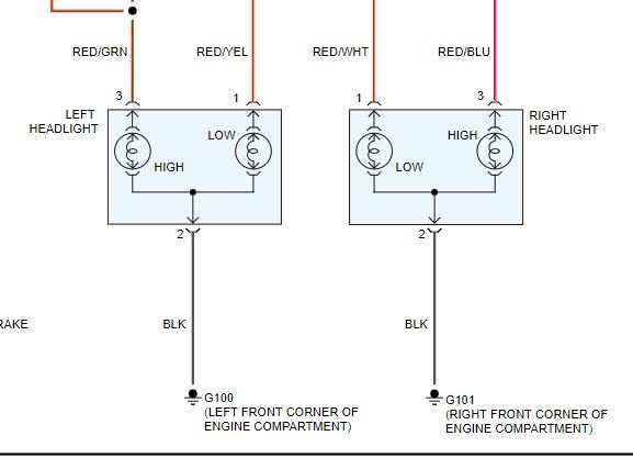

I have checked the fuse box and none of the fuse for the headlights were blown. I replaced the right headlight with a new plug because there was crossion in the plug and the lights where still not working. My signal turn works but the headlight doesnt.

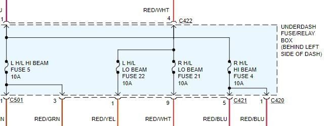

If you find there is no power, there are four fuses in the vehicle for the headlights. I attached a portion of a wiring schematic for you to see which fuses are for which headlight function. Take a look at them.

Now, if when you complete test one you find there is power, then we need to check for a ground problem. You mentioned in the title headlights, but only said you worked on one. So, I am attaching a schematic that shows left and right headlights (picture 2). The black wires in the plug are the grounds. It indicates where on the vehicle they are located. The other two wires on each plug are for power. One is for high beam and the other low beam.

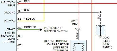

One last ground to check. That one is located behind the kick panel on the driver's side. The kick panel is where your left foot would touch. There is a panel that needs removed to access the wiring behind it. See picture 3.
