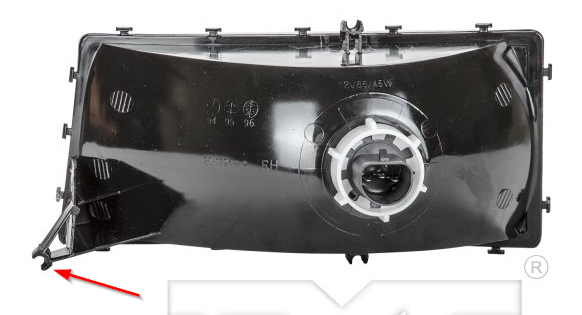

Hi, I put two new extra bright headlights in and the one on the left is slightly higher than the right side.
Is it very hard to adjust the left headlight to match the right side? Thanks
Sep 22, 2021 at 10:59 PM

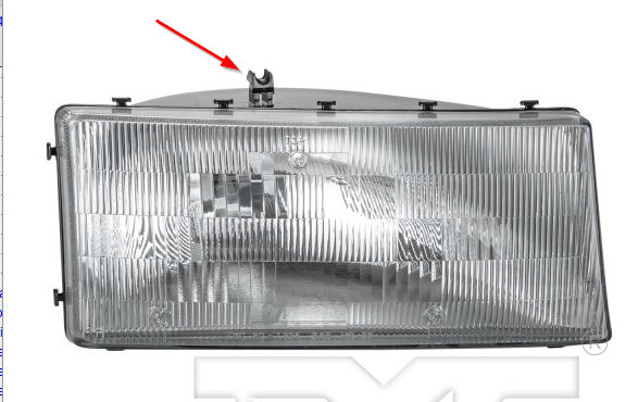

Yes. You have two adjustment screws assuming these new assemblies are the same as the OEM. One on the top of the lamp and one on the inside corner.
See the pictures below.
Basically if one is slightly higher then you are going to want to even them out.

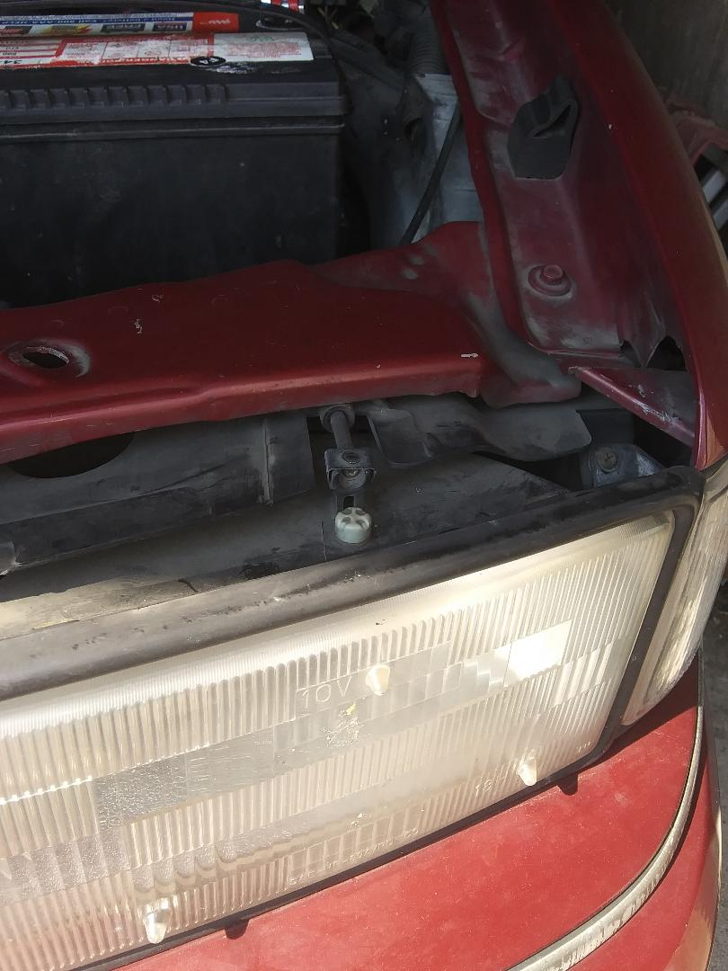

Please see the photo. It's hard to see but if you look close there is a long narrow spring on top of the headlight and there is a very small flathead screw on top and another Philips screw going into the spring. Tell me if I am wrong, but it looks like I have to loosen the flat head screw on top and then turn the Philips screw connected to the spring to move headlight up or down, What do you think? I know the picture is hard to see but if you look at it and think about it, you will know what I mean, I hope, let me know okay? Thanks
Oct 3, 2021 at 6:57 AM
Yes. That is correct. The one on the top is a set screw and holds the adjustment screw in place. So, you loosen that and then you can adjust the lamp and tighten the set screw back down to hold it in place.
Please let us know what questions you have and how you make out.
I am sure with your new eyes this will be easy for you. Thanks for the update.
Oct 3, 2021 at 11:33 AM
TOMSCP
  • 64 POSTS
KASEKENNY1 Thank you once again, seems to have worked out, will double check when I nighttime drive but looking good. Thanks again, Tom
