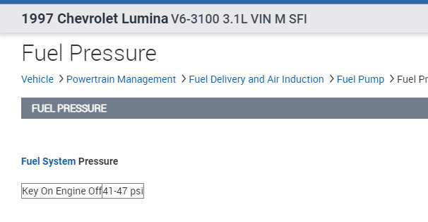

I changed the head gaskets in it. idles and runs fine until an hour or so of driving then acts like it runs out of gas restart it and it runs fine for a little bit then again can stop it will idle all day new fuel filter. does not overheat.

Have you checked the fuel pressure to see if it is within spec? It sounds like the pressure is low, but it can idle, but when it's under a load, the pump can't keep up.
If you haven't, that is where I recommend starting. Here is a link that explains how to check the pressure:
If you look below, I attached the manufacturer's pressure specifications.
Let me know what you find.
See pic below.
