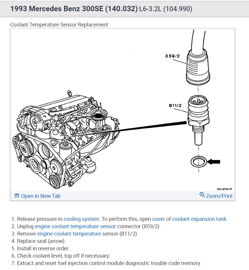

Starts from cold fine can run few miles but when returning to start while warm will not start until it cools down. Also, when in park idles very high. could this be crankshaft position sensor or fuel pump regulator? Maybe ovp. please help

It sounds like you have a engine coolant temperature sensor that going out. Here is a guide to help walk you though the steps and a diagrams below to show you how on out car:
https://www.2carpros.com/articles/coolant-temperature-sensor-cts-replacement
