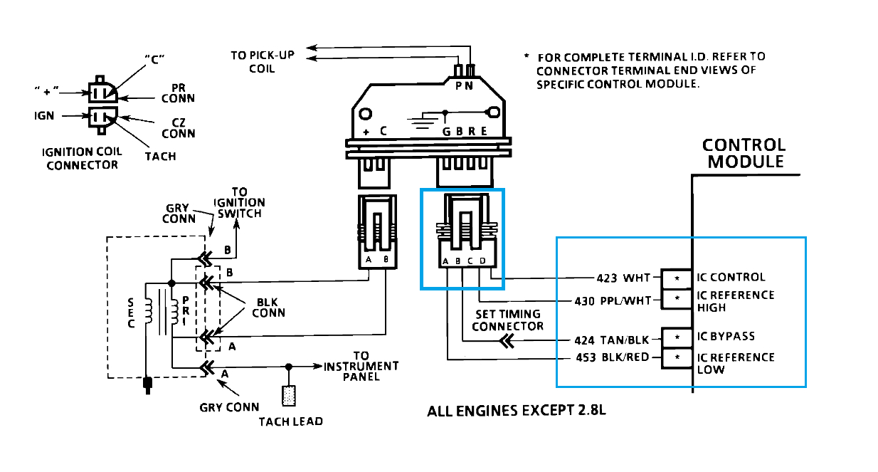

We can see your reply, so you have power to the injectors, and they both are the same resistance measurement? The next test would be with a test light to see if there is any injector pulse coming from the PCM, Hook a test light to battery positive and with the injectors plugged in back probe the control wire with the test light and have someone crank the engine over, you should see the test light flicker while the PCM pulses the ground side of the injectors. If there is no pulse, there is either a wiring issue to the PCM, or there is something going on with the reference signal that the PCM uses for the ignition system. The Ignition module controls spark on this vehicle, and the PCM sends out a signal to the Ignition module to control spark timing, but even if that signal is missing from the PCM, you can still have spark from the ignition module controlling it at base timing. You just won't have any advance.
For example, when you want to set base timing, you unplug the SPOUT connector and the vehicle runs at base spark timing, usually 10degrees, after you set ignition timing you plug the SPOUT connector back in and the PCM will advance the timing as needed. So it might be that you are missing that output.
The diagrams for this vehicle are the old style and not very good, but I'll post them for you.
This is the better of the two wiring diagrams, so check the wiring from the ignition module to the PCM and make sure you don't have any corroded connectors or broken wires. You can see that the ignition module is completely in control of ignition spark if the timing connector is unplugged. This is because the pick-up coil goes to the ignition module first and then outputs it to the PCM. This is a very basic system. So, check all the PCM grounds for corrosion as well. With an older vehicle there is bound to be grounds that are not in great condition.
You can check grounds with the key On and a multimeter set on DC volts, check from battery negative to the engine block, and to the body/frame for any voltage drop on the Ground side of the system.
Here's a great video on ignition modules and he starts out with the GM system. It helps to explain how you can have spark but no injector pulse. If the Reference signal is missing.
