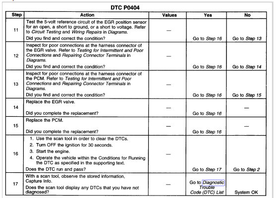

Car runs fine at idle and while in park revs just fine but when in gear it does not want to move. has no power does not want to shift unless you let off gas. can't step more than 1/3 on pedal or loss of speed. And hills forget it, It was working just fine on way home from work parked it and next day this happens. I got a po404 code and a po300. I know it could use a tune up but never had bad plugs because of a EGR problem. please help.

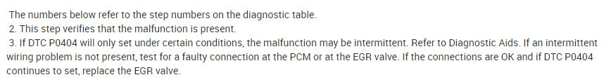

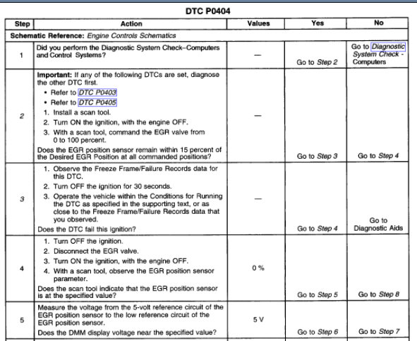

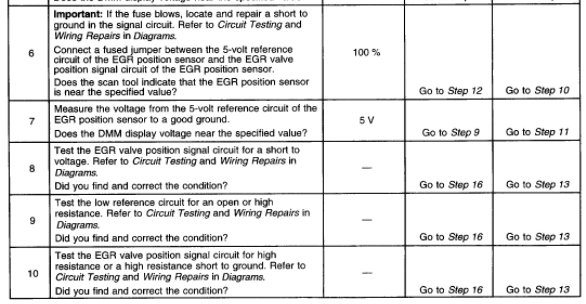

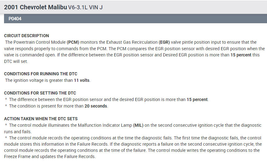

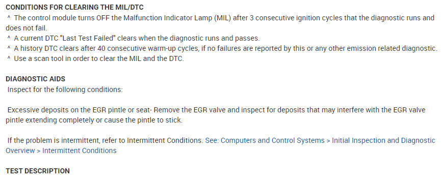

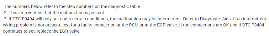

Here is the information you requested. Yes, the code P0404 is related to the EGR-Exhaust Gas Recirculation system. If not working properly it will act as a choke on the engine which may be like the symptom you are experiencing on your car. I've attached picture diagnostic steps below on how to test for this code on your car. Let us know what you find and we'll go from there. Hope this helps and thanks for using 2CarPros.

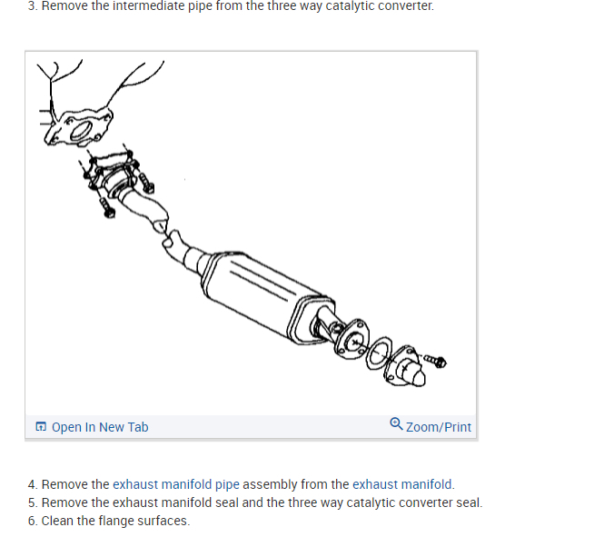

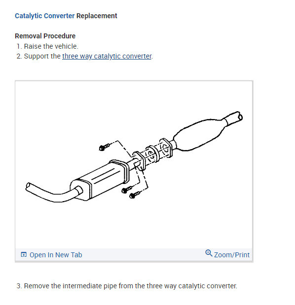

I also would have the cat converter checked. If it is clogged, the engine cannot breathe and there will be little or no power.
https://www.2carpros.com/articles/catalytic-converter-replacement
Jul 16, 2021 at 4:19 AM

You still need to check the fuel pressure even if it was replaced Yesterday.

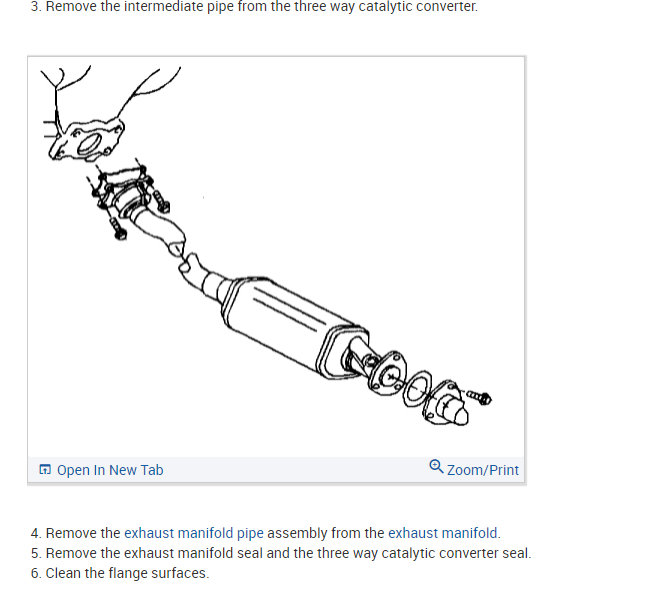

I am leaning more toward the catalytic converter being clogged. You could remove the cross-over pipe under the hood and start it up and drive it around and see if the power returns.
Jul 16, 2021 at 7:21 AM
FORDMAN79
  • 10 POSTS
That's what I'm working on doing now is removing the converter.
Jul 16, 2021 at 7:26 AM

Well, it ended up being a bad catalytic converter. Ended up replacing the entire exhaust system.
