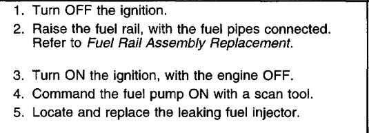

Basically, that indicates there is excessive fuel pressure drop off. It could be the pump, but more than likely, you have a fuel injector leaking. If you look at the first picture I attached, it explains how to check for a leaning injector. I would suggest testing for that before the pump.
Let me know what you decide or if you have other questions. Also, if you ever smell raw fuel, make sure you check for leaks. That can cause the problem as well.
