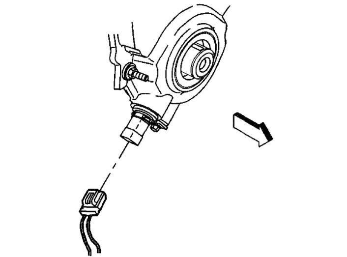

SHELBY1102
  • 10 POSTS
Where and what does the crank sensor do?
Monday, January 25th, 2021 AT 12:19 PM (Merged)
  • 52,797 POSTS
The crank sensor is in the oil pan.
It sends a signal to the PCM that the engine is turning and commands the ignition system and fuel system to turn on.
