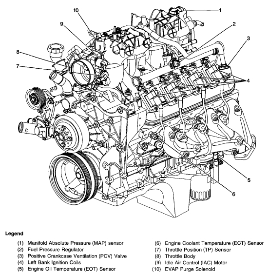

Truck has 32,000 miles and is like new. This problem started 2-3 months ago. Battery is good, air filter clean. Truck starts immediately when cold (down to 20 degrees) and also when warm except if it has been off for 10-60 minutes then it will crank for a long time and then start at a low idle (200rpm for a bit) before catching on. Have tried the turn it on three times (3 seconds each time) trick with no success. If I hold the accelerator to the floor (as per owner's manual) the truck starts right up. Engine pulls hard over 4000 rpm with no missing or power loss. Does this problem sound familiar, and if so, what is the most likely source? Thank you
Saturday, March 10th, 2018 AT 8:18 AM
51 Replies
  • 52,797 POSTS
Good morning
From your description and the key is putting the fuel pedal to the floor, it sounds like it is flooded. by putting the pedal to the floor, it goes into clear flood mode.
This indicates an injector may not be sealing when the engine is turned off. that will allow fuel into the intake system.
if you can check the fuel pressure with a gauge, there is a port on the fuel rail, you can monitor the pressure. let the truck get hot and then turn it off. watch the pressure and see if it drops off.

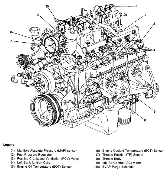

It has a 5.3 liter. If engine ran for a while and shut off for 20 min or more it doesnt want to start untill I press the gas pedal. If left over night it fires right up. I ran full diagnosis and no codes and nothing wrong. I have replaced the IAC valve, plugs and wires, didnt help. Truck runs good and drives fine good idle @ 600 RPMs. I am at a loss as what to do please help
Monday, January 25th, 2021 AT 12:16 PM (Merged)
DENNYP
  • 1,824 POSTS
Check for fuel leaking into the vacuum hose to the fuel pressure regulator.
WINCHELL
  • 5 POSTS
I checked the vacume line from the regulator and there was gas in the line. I replaced it and seems to be working good now. Thanks a million!

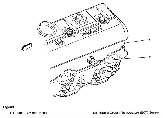

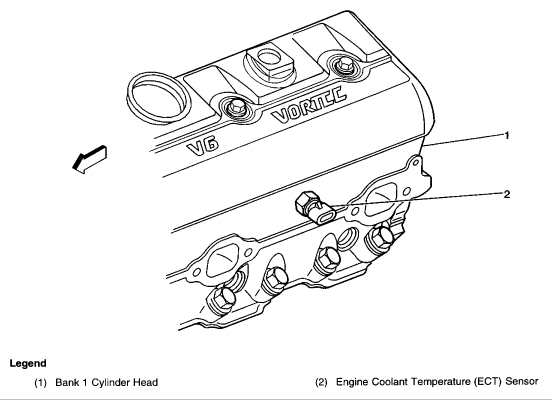

This truck has been hard to start since I got it over a year ago. Now I am trying to fix it. 75% of the time it takes a few couple second cranks before it turns over and when it does it takes a second to get up to idle rpm's where it will run okay. I do not notice any other problems besides the starting. I have cleaned MAF and throttle body and it may have helped a little but still does it. It has thrown a code for running rich in both banks and random misfire a while back. I am not sure where to start but would like to know your opinions.
Monday, January 25th, 2021 AT 12:17 PM (Merged)
  • 109,896 POSTS
Since you are getting a rich code, the first thing I would check is the coolant temperature sensor. This sensor tells the computer how rich or lean to make the fuel mixture. What you need to do is this. Get a live scanner. With the engine cold, scan through until you come to the coolant temperature sensor (CTS). The CTS should be telling the computer the coolant is about the same temperature and ambient temperatures. If it tells the computer it is -40 degrees F (that is an extreme) the computer will react by providing a rich fuel mixture for the vehicle. Thus, it will be hard to start, run poorly. I attached a picture of the sensor location if you find that is the problem.
