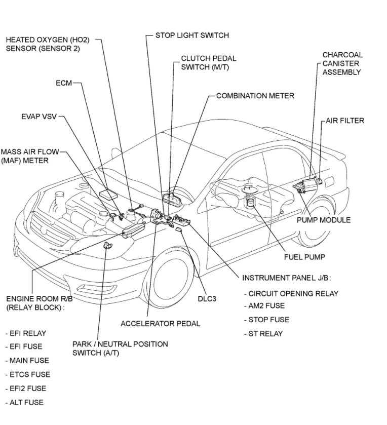

The idea that you have a long crank time is most likely the result of pressure as you first mentioned. Piston rings (low compression) would cause lower power and it would not change the fuel pressure. The idea that you smell fuel is a concern as well. Do you ever notice black smoke from the exhaust when you first start it?
Listen, if you haven't already, I need you to check fuel pressure and fuel pressure drop off. Here is a link explaining how that is done in general:

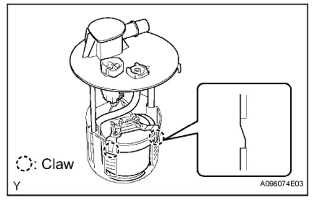

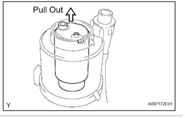

Here are directions specific to your vehicle. The attached pics correlate with these directions.
___________________________________
2007 Toyota Corolla L4-1.8L (1ZZ-FE)
Component Tests and General Diagnostics
Vehicle Powertrain Management Fuel Delivery and Air Induction Fuel Pump Fuel Pressure Testing and Inspection Component Tests and General Diagnostics
COMPONENT TESTS AND GENERAL DIAGNOSTICS
ON-VEHICLE INSPECTION

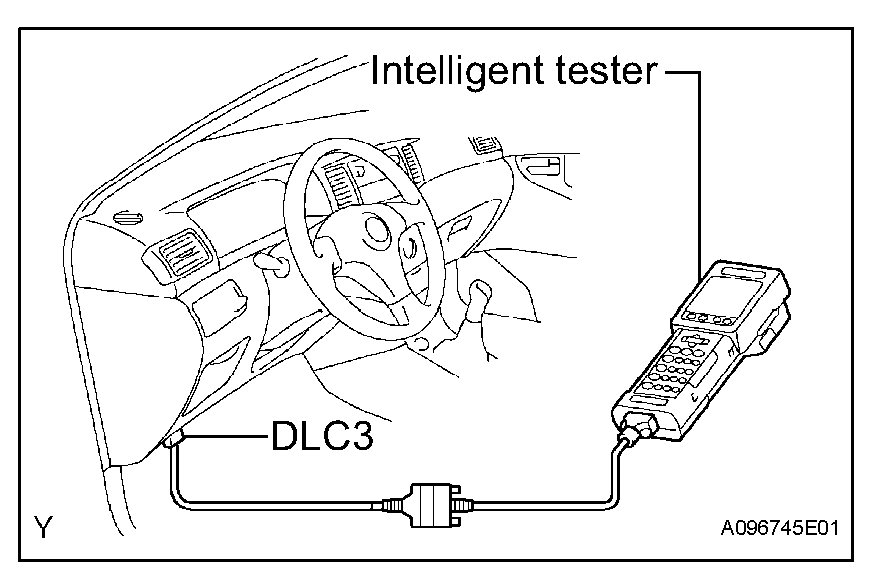

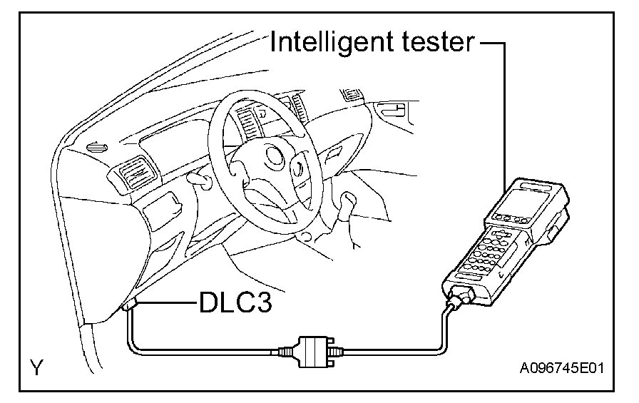

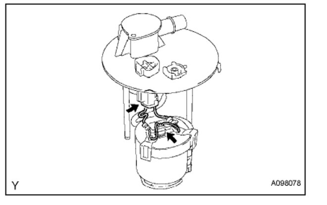

1. CHECK FUEL PUMP OPERATION
pic 1
a. Connect the intelligent tester to the DLC3.
b. Turn the ignition switch to the ON position.
NOTE: Do not start the engine.
c. Turn the intelligent tester on.
d. Select the following menu items: DIAGNOSIS / ENHANCED OBD II / ACTIVE TEST / FUEL PUMP/ SPD.
e. Check the fuel operation while operating it with the intelligent tester.
If the fuel pump does not operate, replace the fuel pump.
pic 2

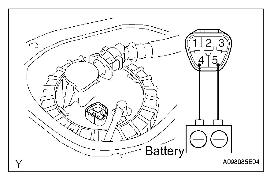

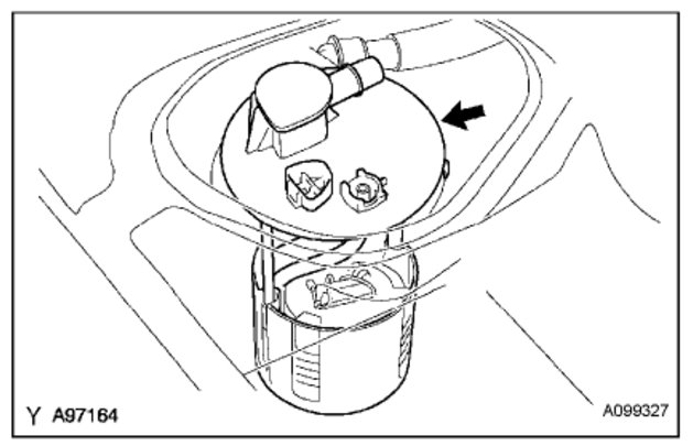

f. If you have no intelligent tester, connect the positive (+) lead from the battery to terminal 5 of the connector, and the negative (-) lead to terminal 4.
NOTE:
- These tests must be done quickly (for less than 10 seconds) to prevent the coil from burning out.
- Keep the fuel pump as far away from the battery as possible.
- Always do the switching at the battery side.
g. Check that there is pressure remaining in the fuel inlet pipe from the fuel line.
HINT: If there is fuel pressure, you will hear the sound of fuel flow. If there is no fuel pressure, check these parts: Fusible link, Fuses, Main relay Fuel pump, ECM and Wire harness.
h. Turn the intelligent tester off.
i. Turn the ignition switch to the LOCK position.
j. Disconnect the intelligent tester from the DLC3.

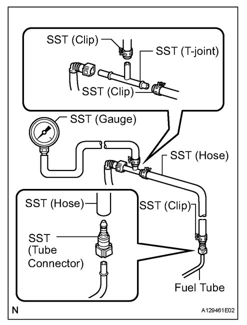

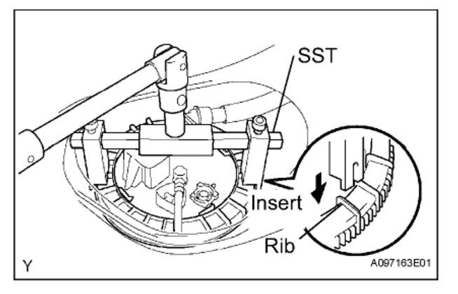

2. CHECK FUEL PRESSURE
a. Using a voltmeter, measure the battery voltage.
Standard voltage: 11 to 14V
b. Discharge fuel system pressure.
c. Disconnect the cable from the negative (-) battery terminal.
pic 3

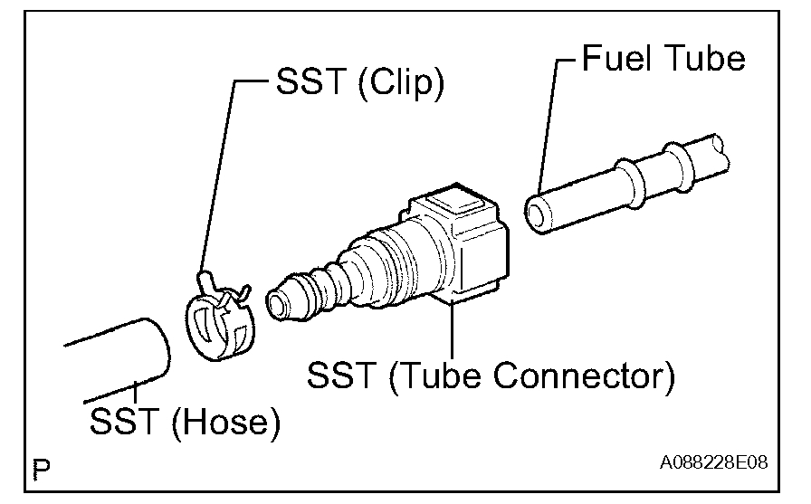

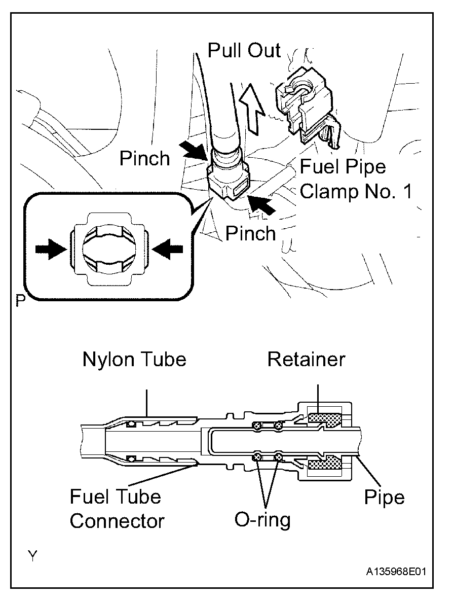

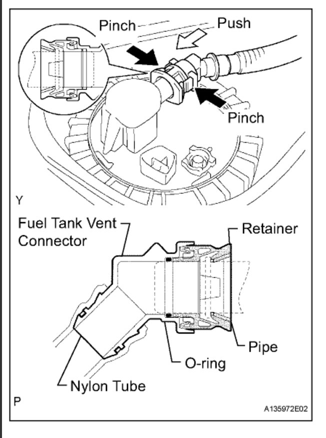

d. Remove the fuel pipe clamp No. 1.
e. Pinch the retainer of the fuel tube connector, then pull the fuel tube connector out of the pipe to disconnect the fuel tube.
NOTE:
- Check that there is no dirt or other foreign objects around the connector before disconnecting it. Clean the connector if necessary.
- It is necessary to prevent mud or dirt from entering the connector. If mud or dirt gets in the connector, the O-rings may not seal properly.
- Only disconnect the quick connector by hand.
- Do not bend, kink or twist the nylon tubes.
- Protect the connector by covering it with a plastic bag.
- If the pipe and connector are stuck, carefully try wiggling or pushing and pulling on the connector to release it. Pull the connector off the pipe carefully.
pic 4

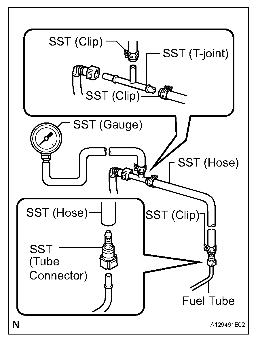

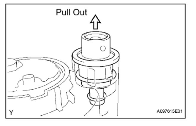

f. Install SST and the fuel tube connector into the vehicle.
SST 09268-31011 (09268-41500, 90467-13001, 95336-08070), 09268-45014 (09268-41200, 09268-41220, 09268-41250)
g. Wipe off any split gasoline.
h. Connect the cable to the negative (-) battery terminal.
Torque: 5.4 N.m (55 kgf.cm, 48 in.lbf)

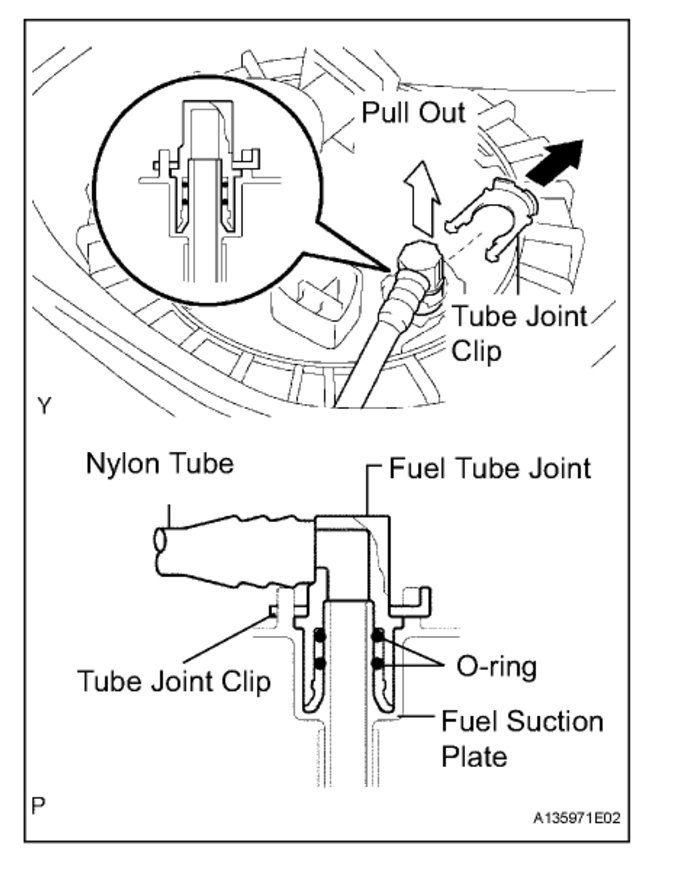

pic 5
i. Connect the intelligent tester to the DLC3.
j. Turn the ignition switch to the ON position.
k. Turn the intelligent tester on.

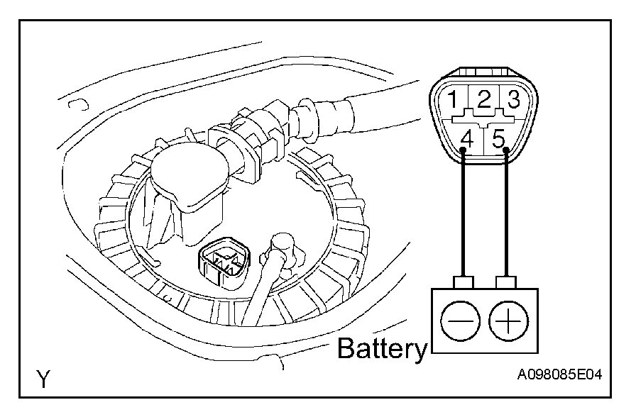

l. Select the following menu items: DIAGNOSIS / ENHANCED OBD II / ACTIVE TEST / FUEL PUMP/ SPD.
pic 6
m. If you have no intelligent tester, connect the positive (+) lead from the battery to terminal 5 of the connector, and the negative (-) lead to terminal 4.
n. Measure the fuel pressure.
Standard: 304 to 343 kPa (3.1 to 3.5 kgf/sq.cm, 44 to 50 psi)
- If the fuel pressure is greater than the standard value, replace the fuel pump.
- If the fuel pressure is less than the standard value, check the connection of the fuel hose and fuel pump.
o. Disconnect the intelligent tester from the DLC3.
p. Start the engine.
q. Measure the fuel pressure when the engine idles.
r. Stop the engine.
s. After stopping the engine, check that the fuel pressure does not change for 5 minutes.
Standard: 147 kPa (1.5 kgf/sq.cm, 21 psi) or more
If the fuel pressure is not as specified, check the fuel pump or fuel injector.
pic 7

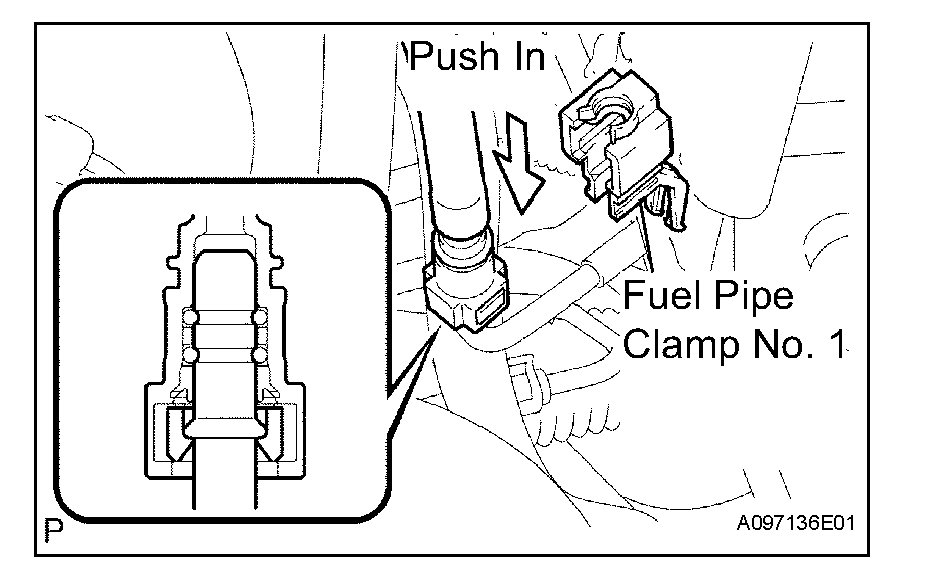

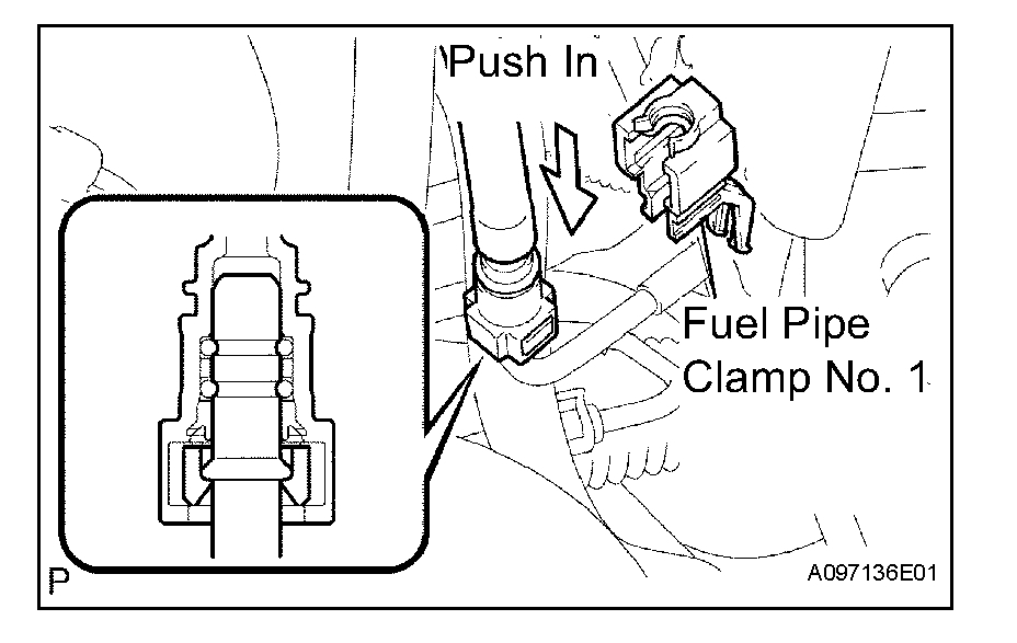

t. Connect the fuel tube.
1. Align the fuel tube connector with the pipe, then push the fuel tube connector in until the retainer makes a "click" sound to connect the fuel tube to the pipe.
NOTE:
- Check that there are no scratches or foreign objects around the connected part of the fuel tube connector and pipe before performing this work.
- After connecting the fuel tube, check that the fuel tube is securely connected by pulling the fuel tube connector.
u. Install the fuel pipe clamp No. 1.
v. Check for fuel leaks.

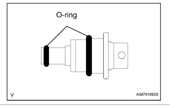

It sounds like several attempts to find a leak have been done. However, were fuel injectors checked for a leak? What you can do is pinch off the return fuel line to the tank and see if pressure is held when the engine is off. If an injector is leaking, pressure would be lost and you may get a fuel smell. If you look through this link, it explains how in general an injector is checked:
https://www.2carpros.com/articles/how-to-test-a-fuel-injector
_________________________________________________________________________________________
Here are the directions specific to your vehicle for testing a fuel injector. The attached pics correlate with the directions.

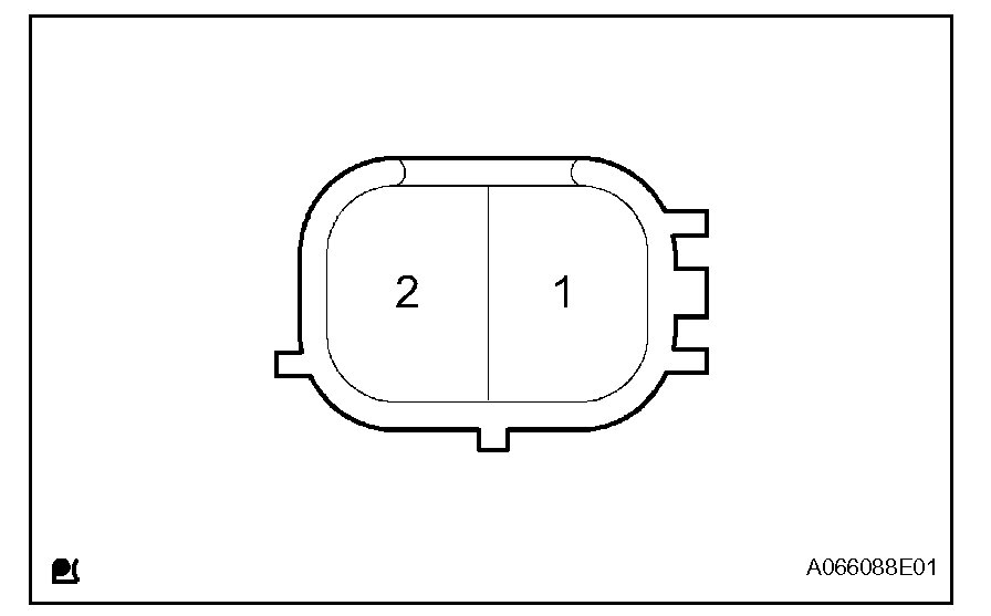

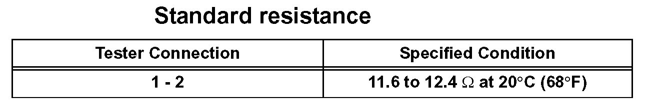

a. Check the resistance.

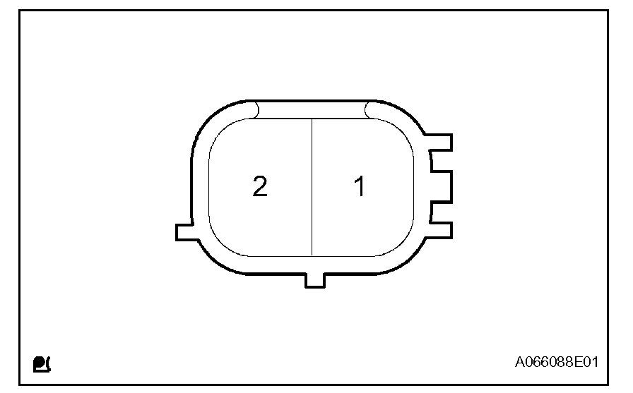

pic 1
pic 2
1. Using an ohmmeter, measure the resistance between the terminals.
If the result is not as specified, replace the fuel injector.

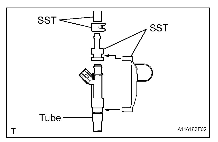

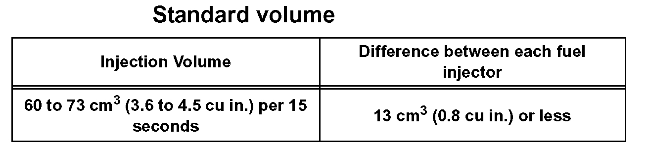

b. Inspect the injector injection volume.
CAUTION: Keep the injector away from sparks during this test.
pic 3

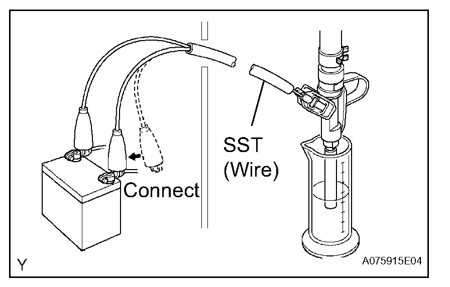

1. Connect SST (fuel tube connector) to SST (hose), then connect them to the fuel pipe (the vehicle side).
SST 09268-31011 (09268-41500, 90467-13001,95336-08070)
pic 4
2. Install the O-ring to the fuel injector.
3. Connect SST (adapter and hose) to the injector, and hold the injector and union with SST (clamp).
SST 09268-31011 (09268-41110, 09268-41300,90467-13001)
pic 5
4. Put the fuel injector into the graduated cylinder.
CAUTION: Install a suitable vinyl tube onto the injector to contain gasoline spray.
5. Operate the fuel pump.
6. Install SST onto the fuel injector.
SST 09842-30080
pic 6
7. Connect SST (wire) to the injector and battery for 15 seconds, and measure the injection volume with the graduated cylinder. Test each injector 2 or 3 times.
NOTE: Always do the switching at the battery side.
HINT: If the result is not as specified, replace the fuel injector.

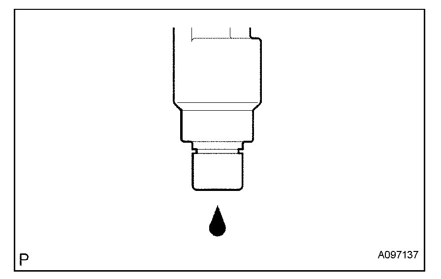

c. Inspect the fuel leakage.
pic 7
1. Disconnect the SST (wire) tester probes from the battery and check the fuel leakage from the injector.
Standard: 1 drop or less every 12 minutes

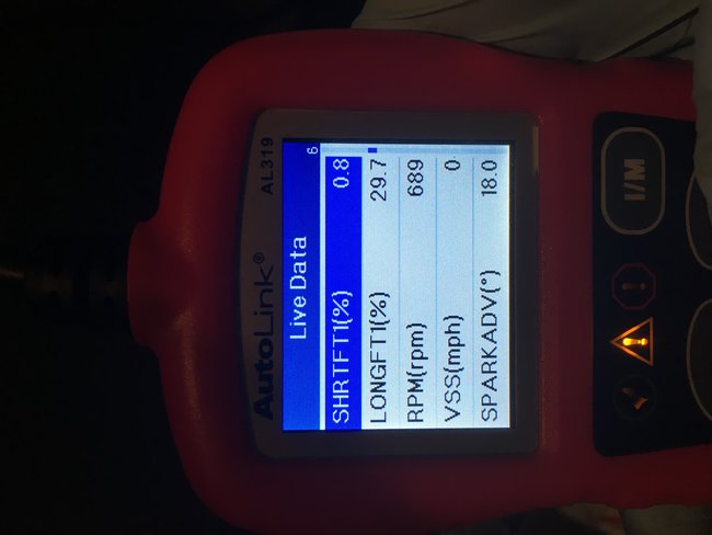

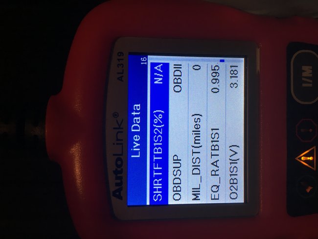

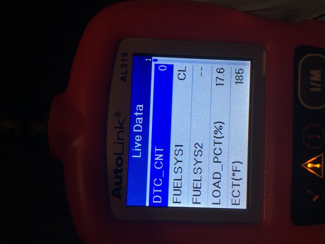

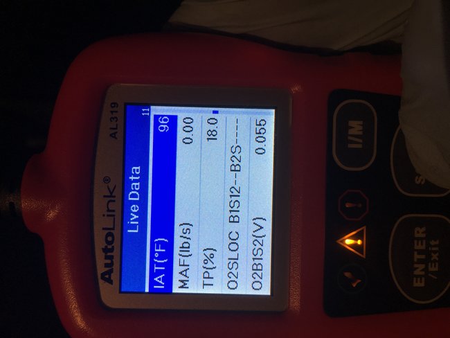

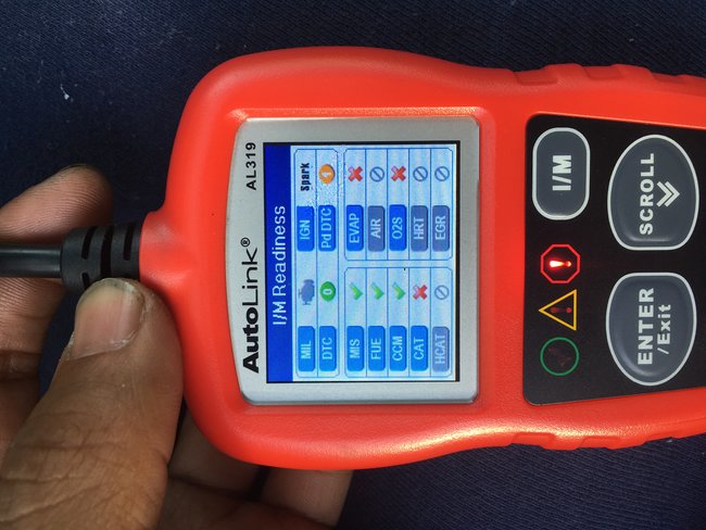

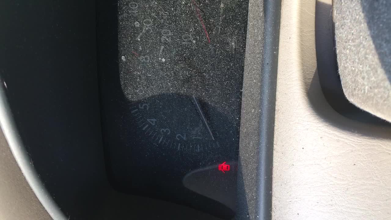

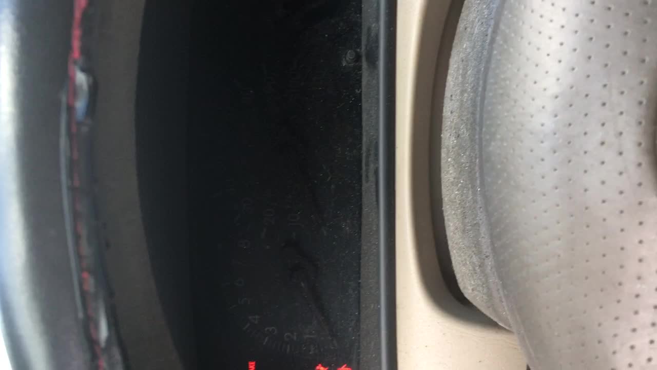

Hello, my car is the LE model. It has two codes which are P0171 and P0113. Now so far I have tested the MAF sensor wiring which is working properly, replaced the MAF sensor and the new one is working according to my multi-meter readings, new intake gasket, new valve cover gasket because there was oil in the spark plug wells, new spark plugs, checked the coil packs, checked the fuel injectors, new air filter, have not checked the throttle body but when I did the intake gasket I do not remember seeing any dirt, camshaft position sensor is fine, crankshaft position sensor has not been checked, and I do not have any vacuum leaks. The starter turns the motor over just fine but it struggles firing up and it is becoming worse. I have not checked the o2 sensors but I doubt they have anything to do with the starting and I do not seem to have any of the symptoms listed with them. The car also vibrates at idle and tends to stumble on acceleration and jerks when accelerating as well. I do not know why the codes have not gone away and I really need to fix the hard starting. any help is greatly appreciated, thank you.
Oct 15, 2020 at 5:04 AM (Merged)
  • 55,694 POSTS
If you have a cylinder that has low compression it will misfire causing a lean code much like you are getting. I would start with a compression test so we do not chase our tail.

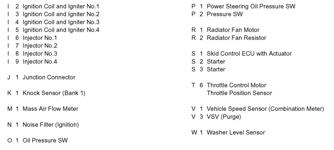

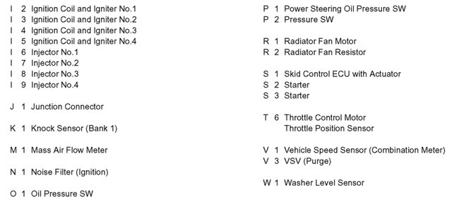

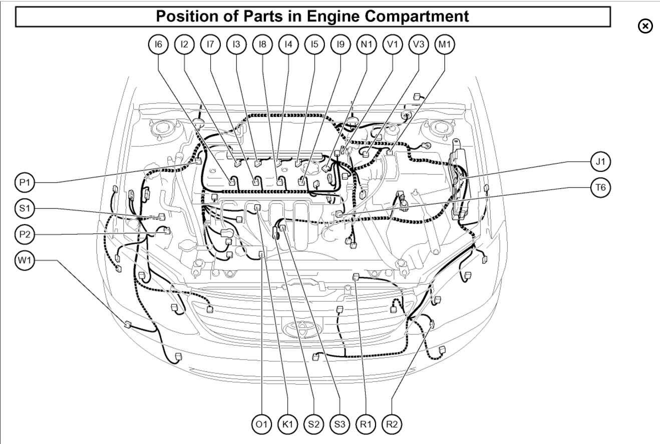

  • 110,248 POSTS
My first thought was a fuel pressure related issue, but you mentioned that you replaced the pump. Have you confirmed that fuel pressure is within the manufacturer's specs? If not, do that.

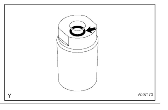

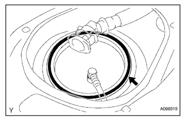

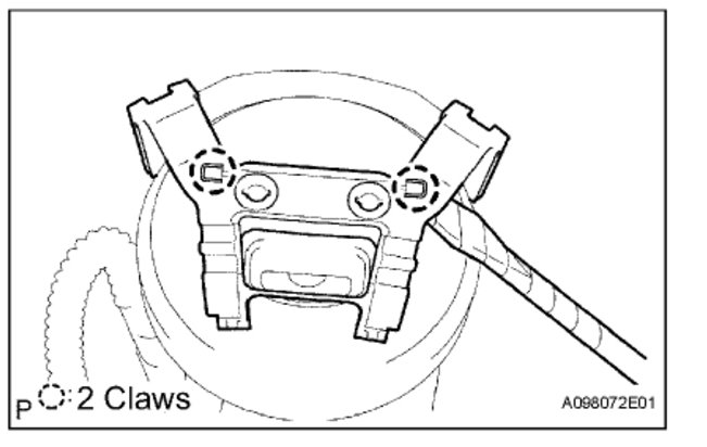

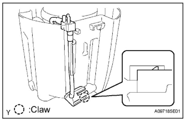

Here are directions specific to your vehicle. The attached pics correlate with the directions.
pic 1
pic 2
NOTE:
pic 3
NOTE:
pic 4
pic 5
pic 6
r. Stop the engine.
pic 7
NOTE:
If the pressure is within spec, I need to know a couple things. First, does the check engine light stay on when the engine is running? Also, do you have a scan tool that can read live data?
JROCK14
  • 19 POSTS
Here it is.
BLESSING EWOBOR
  • 753 POSTS
  • 55,694 POSTS
Good work on the video, it looks like the fuel pump is weak which will cause the code and the hard starting. You will need a fuel pressure gauge to check the pressure. Here is a guide that will give you an idea on what to do.
and if bad
https://www.2carpros.com/articles/how-to-replace-an-electric-fuel-pump
You are lucky tough becasue the tank does not have to be dropped to replace the pump, your car has a trap door. Here are the diagram (below)

JROCK14
  • 19 POSTS
When I unplug the maf sensor the car dies and when I try to start it back up with it unplugged she fires right up and won't hesitate on the idle.

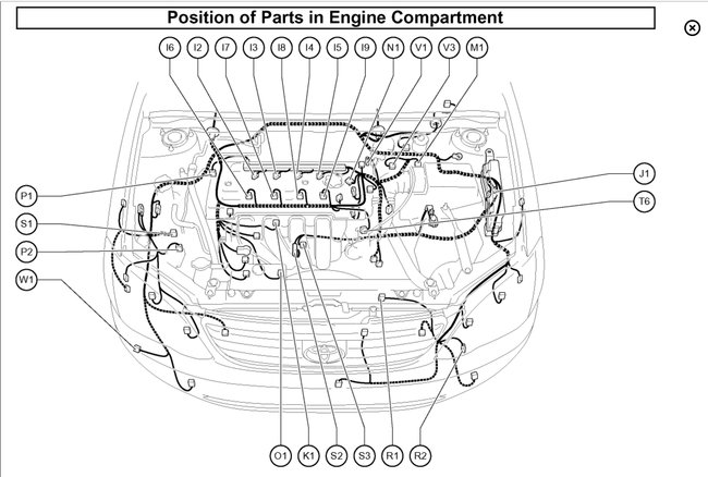

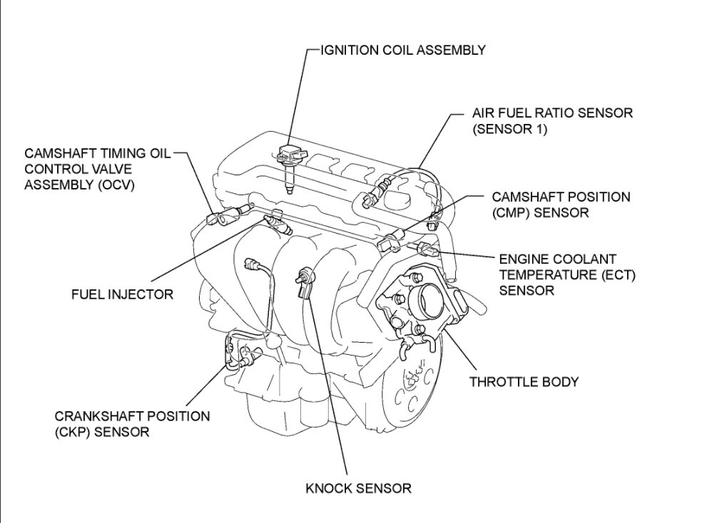

I went over the post again and I noticed that the crankshaft angle sensor has NOT been checked. It could be weak and taking a while gettting the voltage up, Plugging and unplugging the MAF must have something to do with it. You need an oscilloscope to check it though. Here is a guide to let you know what you are in for when changing it.
Here is what it will be like on your car (below)
Please let us know what you find. I'm interested to see what it is.

I took it off at one point to see if it was a problem but I never replaced it because I was so focused on the P0171 code but I'll replace it this week and let you know. Thanks again.
