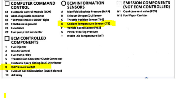

so last summer I had an issue that drove me nuts!
When air outside was warm (60 up) it was hard to start...
crank crank crank and eventually it would start...
Then winter came!
I had zero issue all winter long!
now is is warm again...
crank crank crank, until it starts. :(
what makes outside air temperature cause this ?

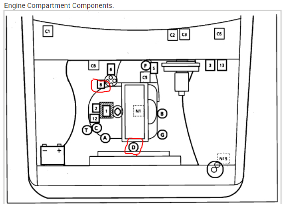

Hi John,
It could be flooding (which is reverse thinking). There is a potential issue with it causing it to not get off cold start mode which is fine when the temp is cold but once it warms up it floods the engine and makes it hard to start. ie Coolant Temperature Sensor out of range.
The oil pressure sending unit on certain year Blazers, works in conjunction with the fuel pump. If you have a defective oil pressure sending unit, this will cause a hard start, or no start at all. The oil pressure sending unit is a great safety device. If you have no oil pressure, the engine will not run. Let`s say if you're driving down the freeway and your oil pump fails. The sending unit will signal the computer to deactivate fuel delivery, which will shut off the engine immediately.
We have an older discussion about this issue involving several S10 years and engine sizes.
https://www.2carpros.com/questions/chevrolet-s-10-2001-chevy-s-10-oil-sending-unit
I would start with those two. Keep in touch. Glenn

CTS has already been replaced, I will replace oil pressure sensor. OBD1 is a handicap... I would prefer OBD0 or even obd2... I will report back with new findings. Thank you
