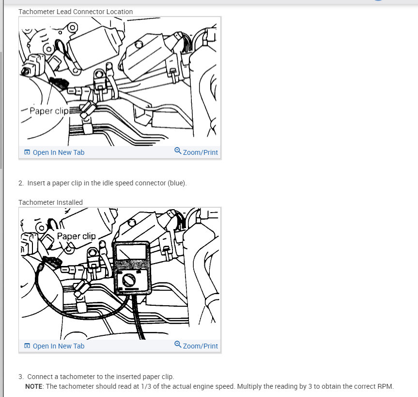

My tachometer is showing 0 RPMs and I have a multimeter that actually has an RPM setting, but I don't know how to connect it to the ignition coils because everything I've read or seen is cool on plug instead of the ones I have.

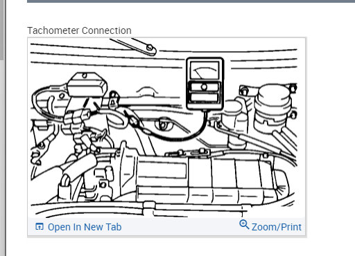

Just so I understand what you are looking for. You want to use your meter as the tachometer and not the one in the truck?
If that is the case, your vehicle has a connector that is used when timing the engine.
I am attaching the info on this connector from this procedure and that should help with setting this up.
Please run through this material and let us know what questions you have, and we can go from there.
