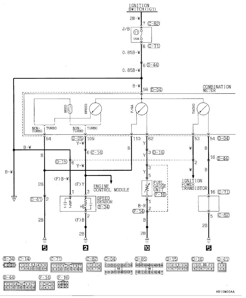

Electrical problem 6 cyl All Wheel Drive Manual 120000 miles
Hey. Just bought a '92 Mitsubishi 3000GT VR-4 which is great shape except the tachometer does not work. When you start the car it is at 0 RPM and stays there. I read up a lot about it on the internet but can't seem to find a definitive answer. What is your recommendation on how should I go about fixing it?
Feb 17, 2010 at 2:44 PM
  • 55,432 POSTS
It sounds like you have an ignition transistor that is out, here is a wiring diagram (BELOW) so you ca do some testing. Here is a guide to show you how
and
