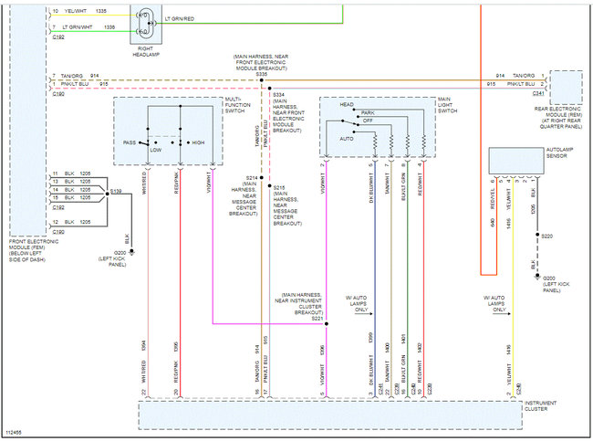

The right headlight does not turn on. found a ground wire hanging loose, need to know where it goes.

Where is the ground located? There is no ground right from the bulb. Ground is provided via the front electric module. The ground for the module is located in the vehicle, left kick panel. If it was bad, neither light would work.
I can tell you that the headlamps each have a fuse. Did you check if the fuse was bad?

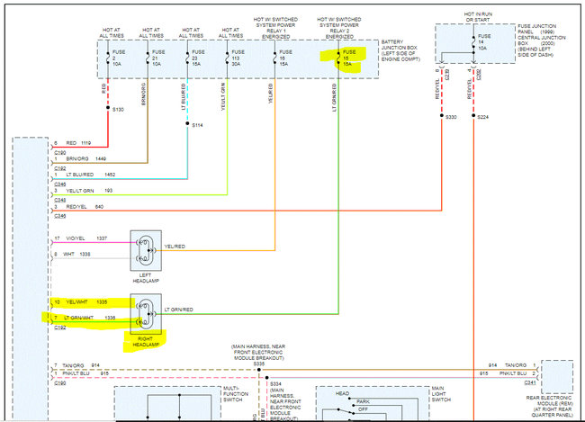

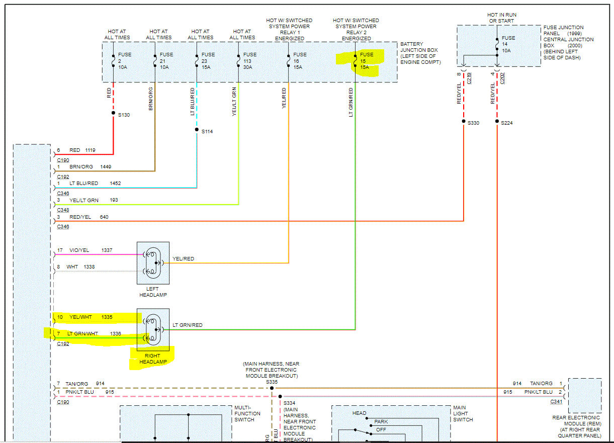

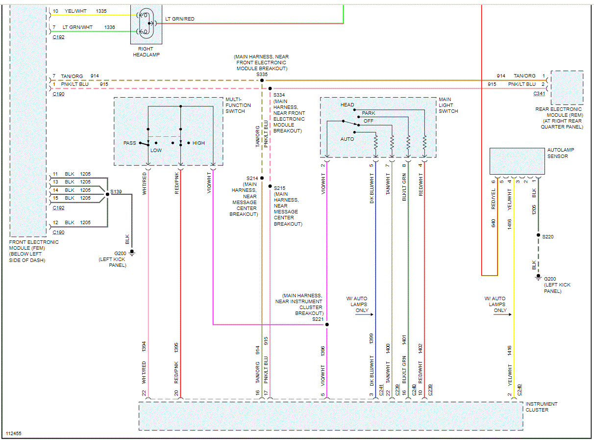

I attached the entire wiring schematic for the headlamps. I highlighted the right head lamp, the fuses, and the wires going to the module I mentioned. Check the fuse to see if it is good. In addition to checking the fuse, confirm there is power to and from it.
Pics 1 and 2 are the schematic. I had to cut it in half to make it readable. However, I did overlap them so you can follow from one to the next.

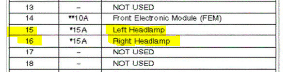

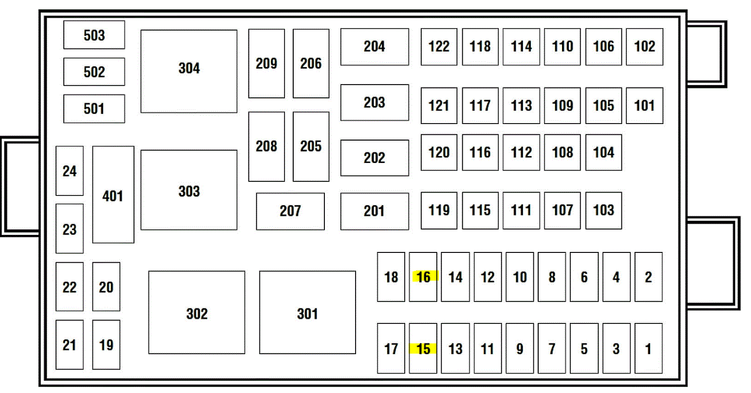

Note: The wiring schematic shows fuse 15 is for the right front light. When I look at the battery junction box information, it shows 16. Check both to be sure.

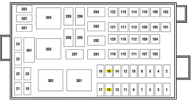

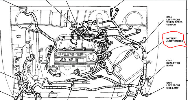

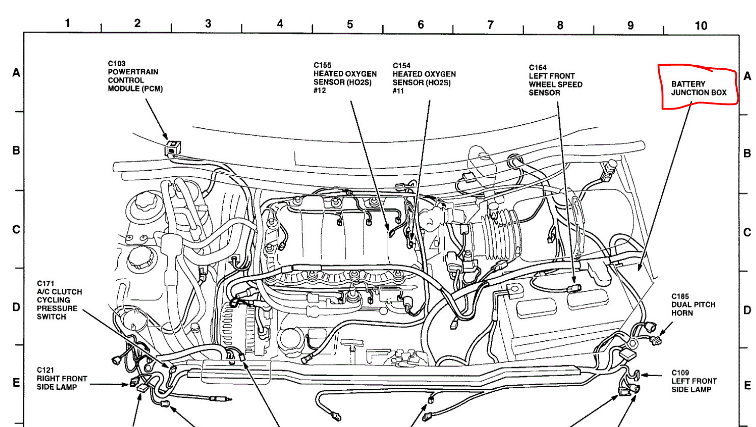

Pics 5 and 6 are to help locate the fuses. The box is under the hood on the driver's side. Based on which v6 you have, a 3.0 or a 3.8, will determine the exact location. Pic 3 is for the 3.0L and pc 4 is for the 3.8L.
