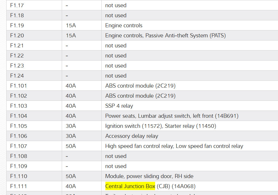

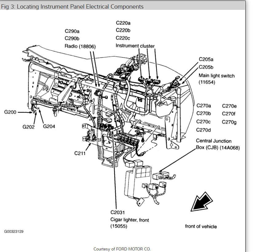

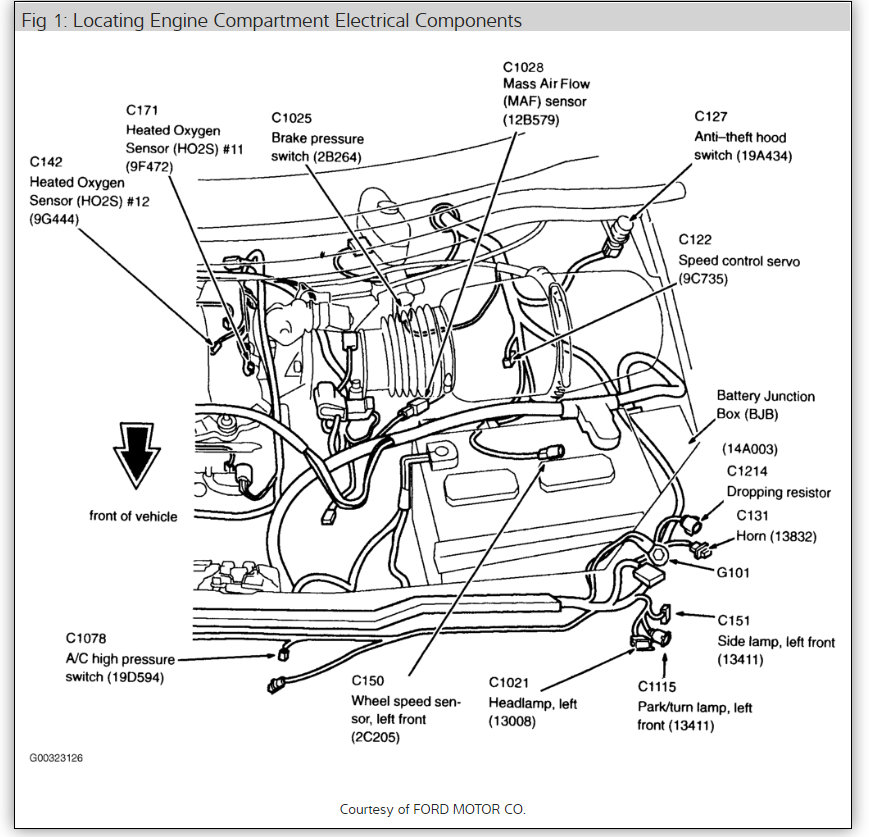

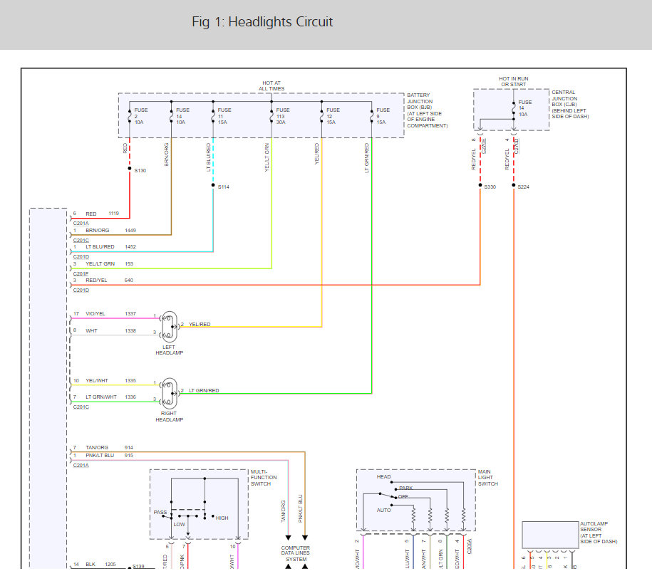

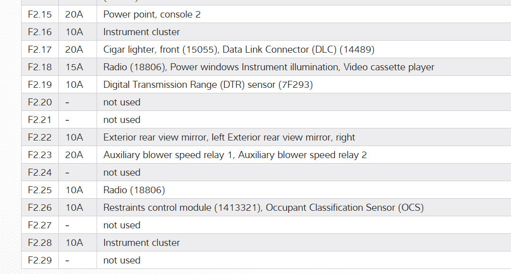

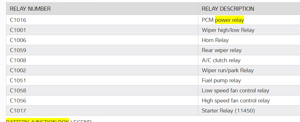

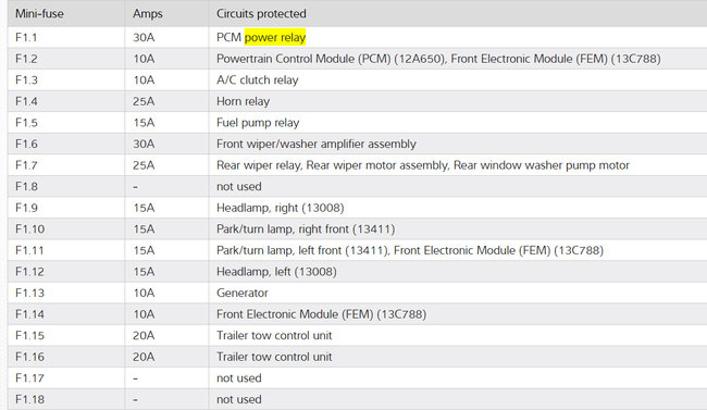

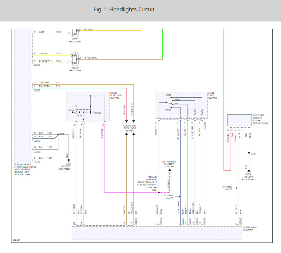

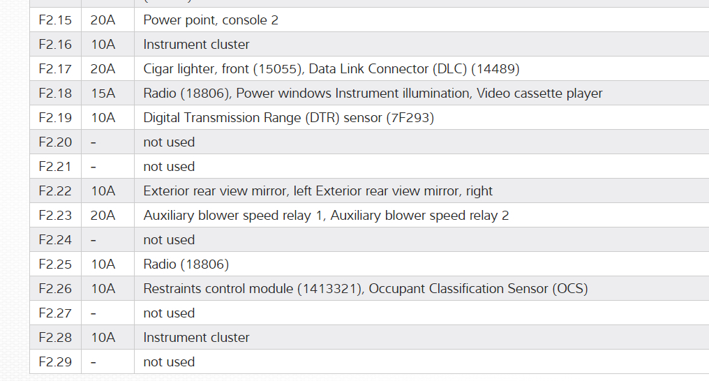

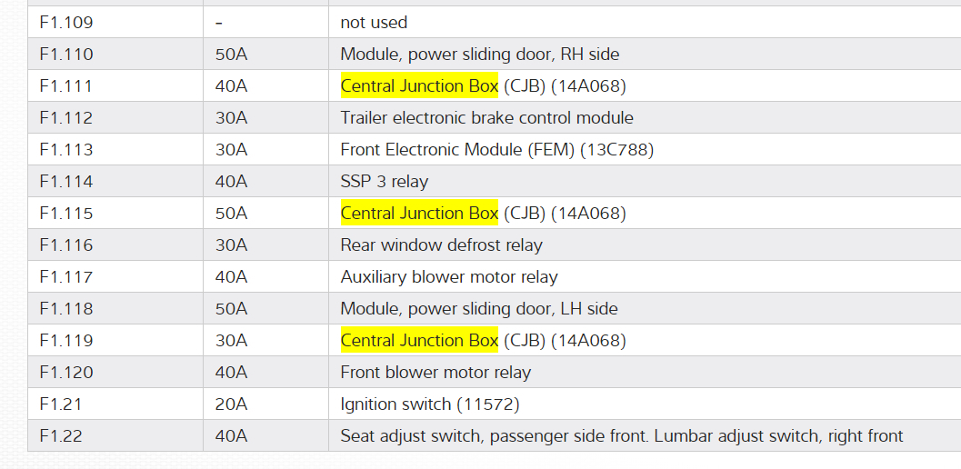

1 headlight has power 1 does not where does the negative wire go to for the right headlight? Can I get headlight wiring diagrams?
Oct 23, 2010 at 3:27 AM
BLUELIGHTNIN6
  • 16,542 POSTS

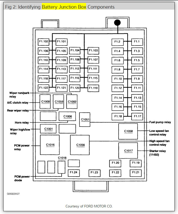

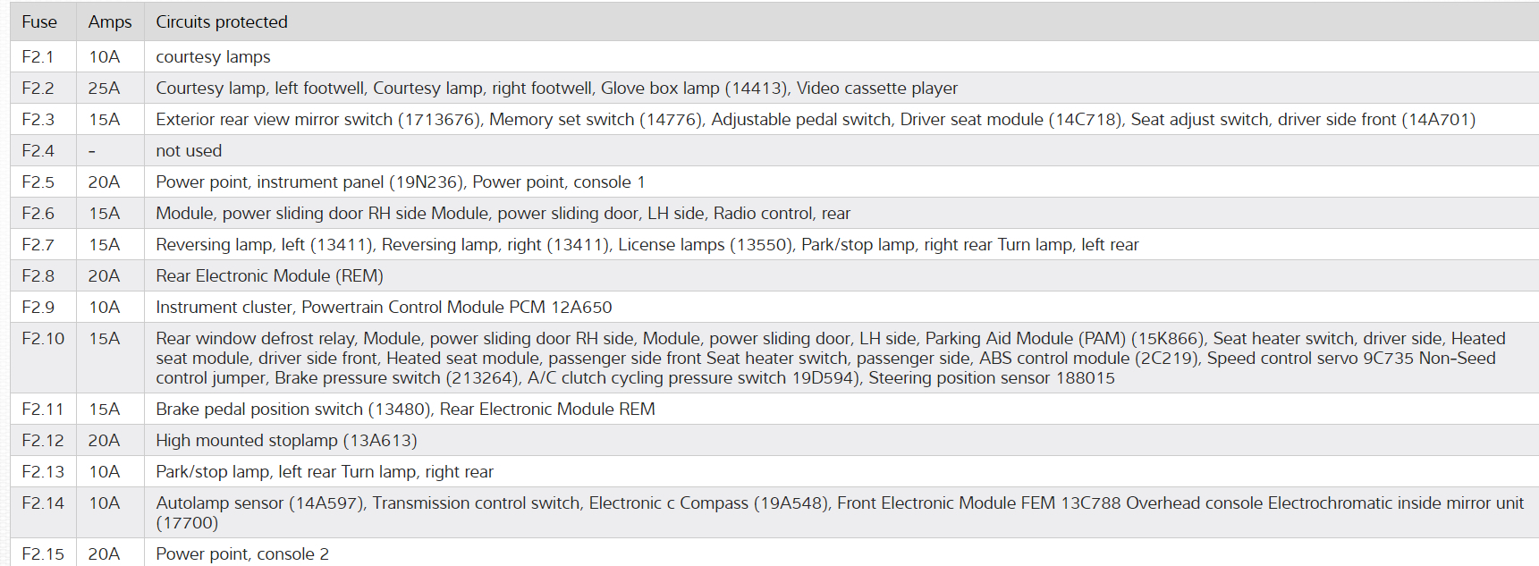

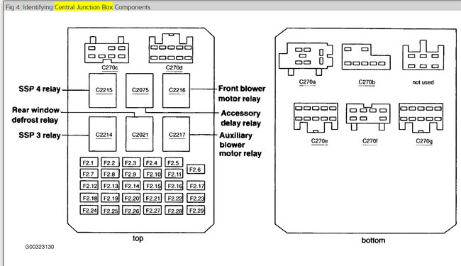

There are fuses for each headlight mode here is the fuse location and headlight wiring diagrams so you can see how the system works.
and
Check out the diagrams (Below). Please let us know what you find. We are interested to see what it is.
