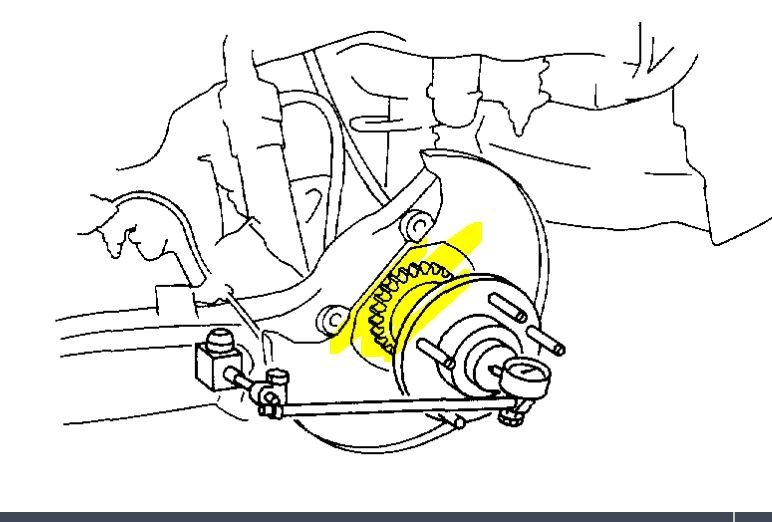

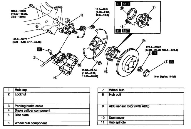

For the bearing, here are the directions for replacement. The pics attached correlate with the directions.
__________________________
REAR WHEEL HUB, HUB SPINDLE REMOVAL & INSTALLATION
WHEEL HUB, HUB SPINDLE REMOVAL INSTALLATION
Caution:
^ Performing the following procedures without first removing the ABS wheel-speed sensor may possibly cause an open circuit in the harness if it is pulled by mistake. Before performing the following procedures, remove the ABS wheel-speed sensor (axle side) and fix it to an appropriate place where the sensor will not be pulled by mistake while the vehicle is being serviced.
pic 1
1. Remove in the order indicated in the table.
2. Install in the reverse order of removal.

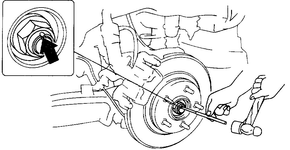

Locknut Removal Note
pic 2
1. Knock the crimped portion of the locknut outward using a small cape chisel and a hammer.
2. Lock the hub by applying the brakes.
3. Remove the locknut.

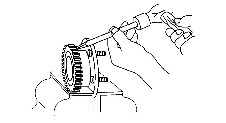

ABS Sensor Rotor Removal Note
Note:
^ The sensor rotor does not need to be removed unless it is being replaced.
pic 3
1. Remove the sensor rotor using a chisel.

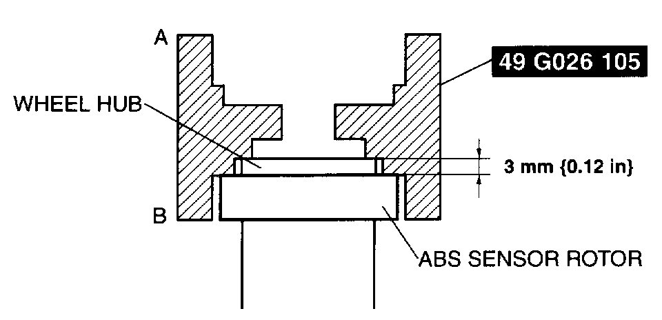

ABS Sensor Rotor Installation Note
pic 4

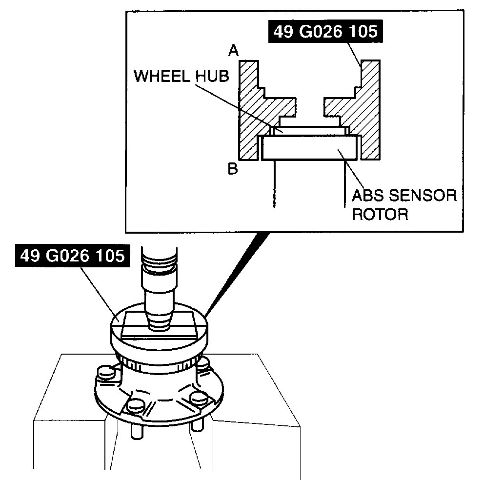

1. Set the SST as shown in the figure.
Caution:
^ Position the SST so that marking B faces the bottom.
pic 5
2. Press on the new sensor rotor using the SST and a press.

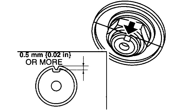

Locknut Installation Note
pic 6
1. Install a new locknut and stake it as shown.

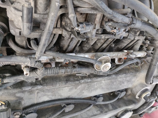

Thank you for all the information Joe, I really do appreciate it. Once the part reaches next week and I fit it on I will let you know how it went.
The Schrader valve for the fuel pressure test adapter is that the screw in valve on the right side of the fuel rail in the picture?

If that is part of the fuel rail, yes. And I look forward to hearing from you on the noise.

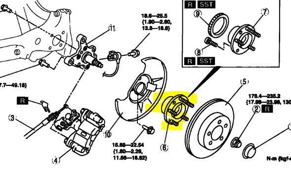

Hope all is well. Tried getting the hub off but it is stuck. Seems I might have to find a slide hammer to get it off.

Unfortunately I have to order the slide hammer..
So now I wait... Yes the highlighted part is what I was referring to.

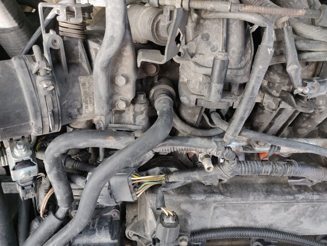

I went to change my fuel filter this morning. I noticed that I did not see the access panel like in the videos. After taking a closer look I noticed two access panels. One on the left and one on the right under the rear seats. The left one has a big "L" and "06Y" stamped on it. The right one has a big "R" and "06X" stamped on it.
I am lost now. I am trying to figure out if this means there are two fuel pumps. Is one a dummy. I'm not sure where to go from here.
I have attached a video and photos.
